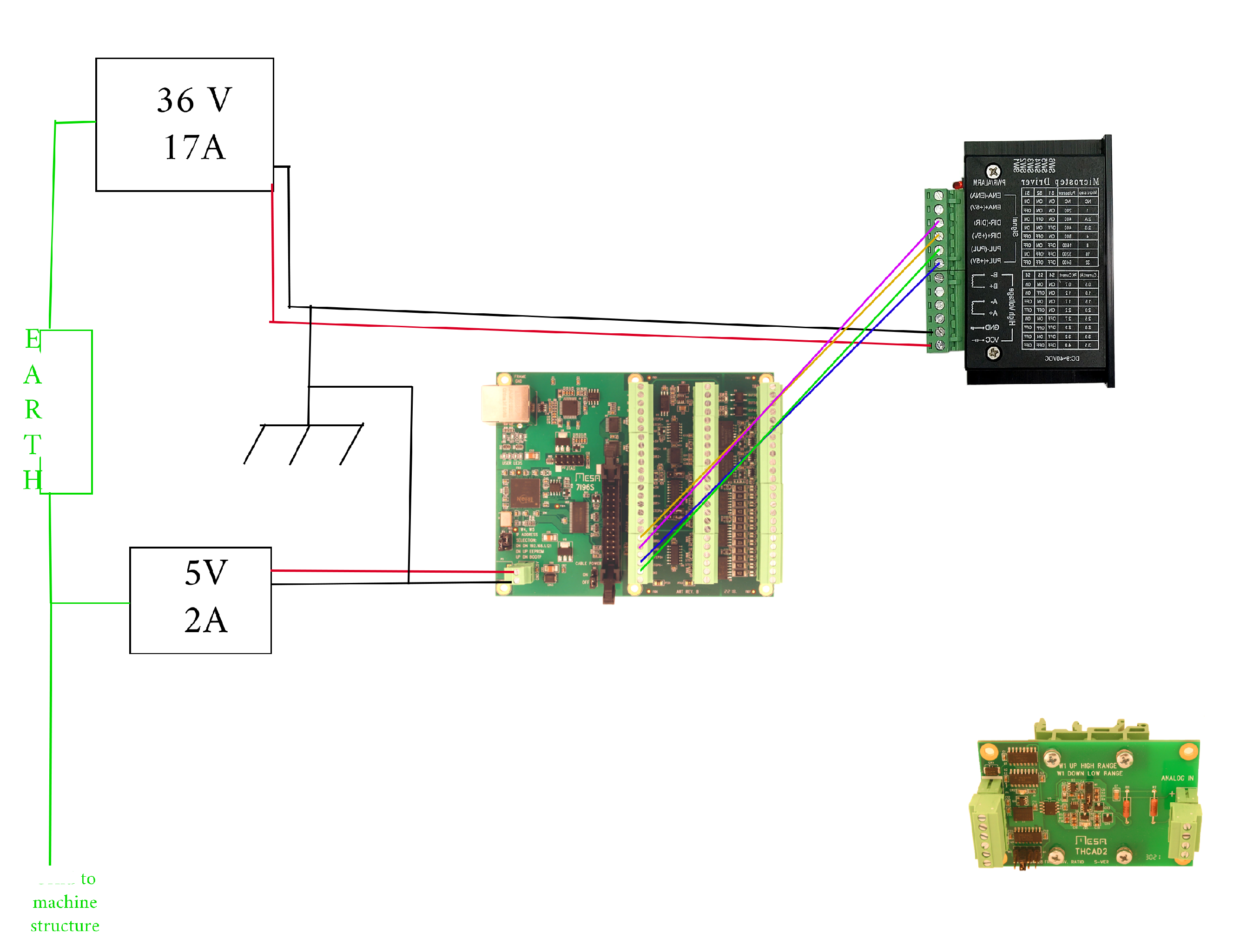

I've started my own wiring diagram that I'll update. I'm posting it here so one can tell me if I do something wrong. Right now i've just draw the wiring for the drivers (just one but they are all on the same 36v 17A alimentation and wired the same way).
I'm not sure I fully understand the difference between ground and earth. As I understand it I need to connect the machine structure and the alimentation to the earth, and I need a common ground (not connected to the earth) for everything else (which I draw in black on the drawing). The common ground acting as a base voltage reference for all the electronic, and the earth is there for safety in case I have accidental high power connecting to the frame of the machine.
Does it seems right to you ?

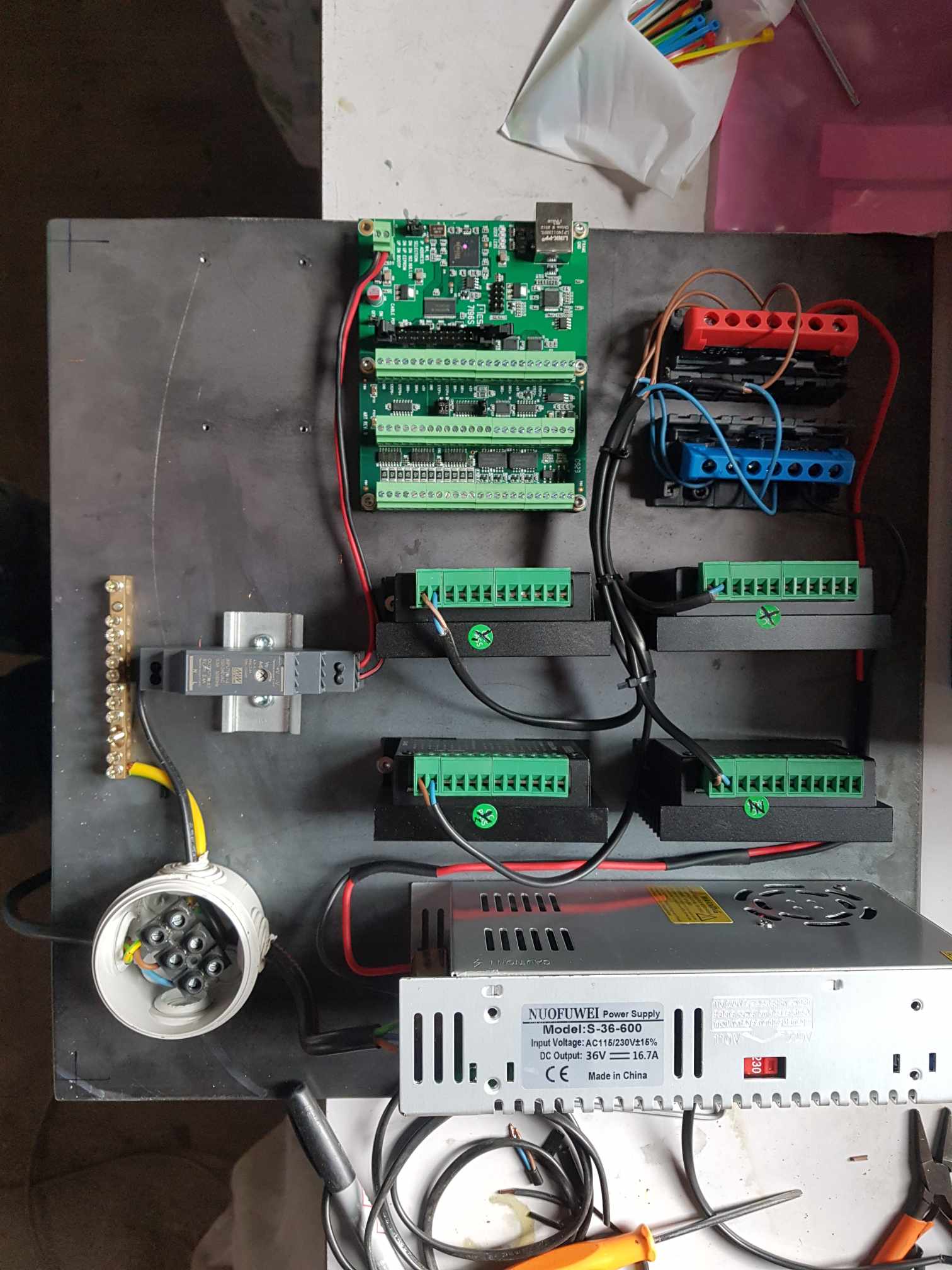

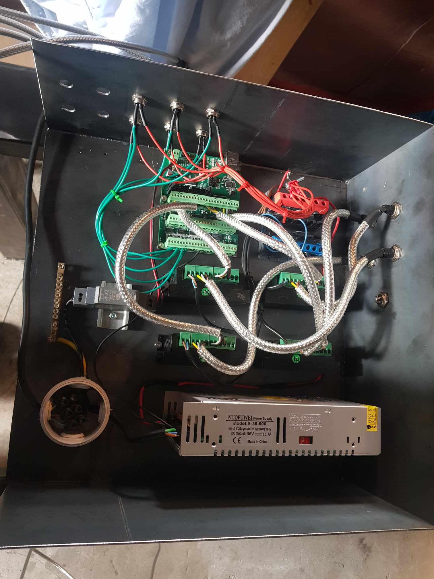

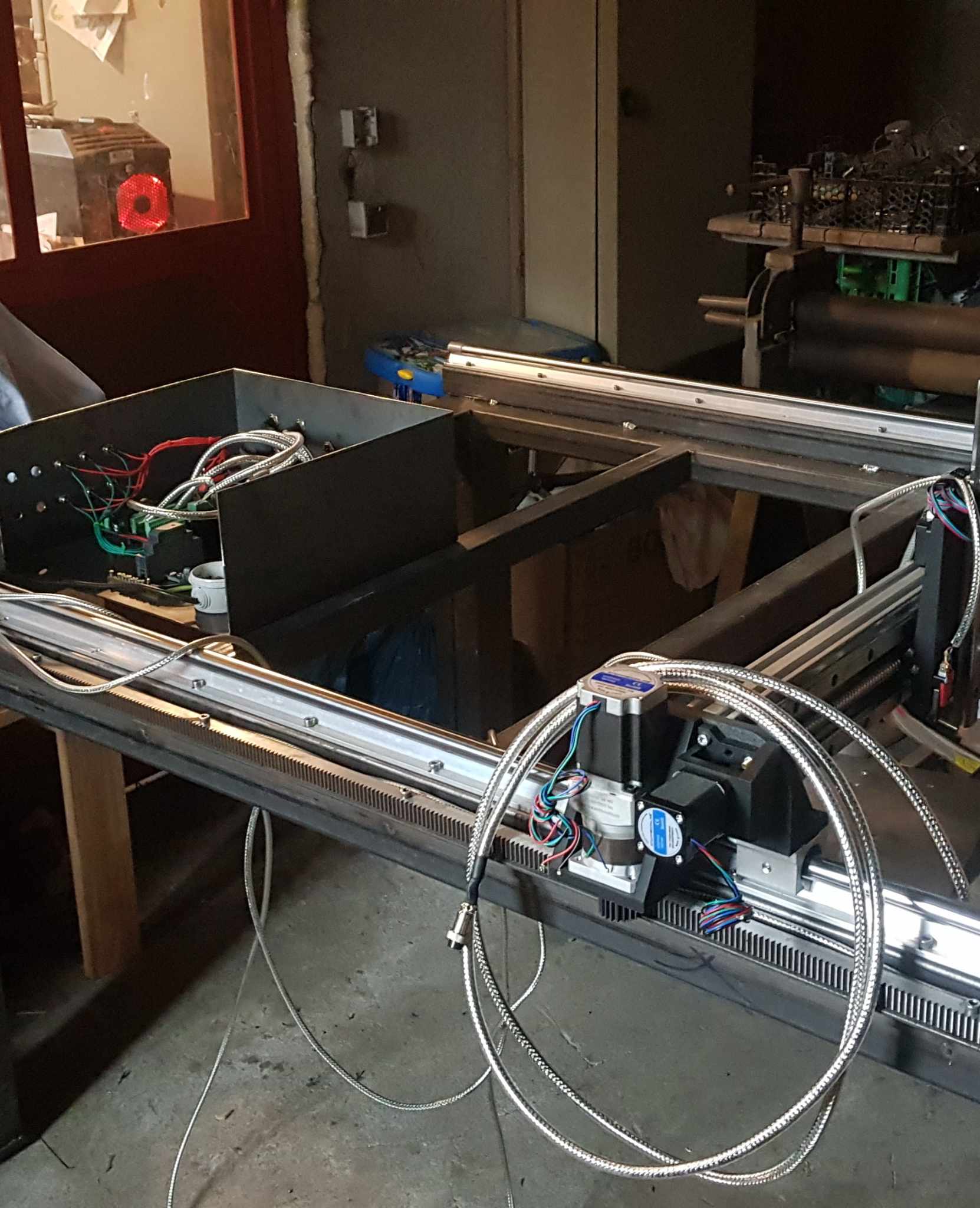

Slowly but steadily I'm wiring everything I need for the first test : limit switches and Y and X motors (the Z axes will be configured later with the THCAD wired in).
All the shield of the shielded cables that goes outside the box have a ground connection through the aviator connectors casing and the frame. There is room for a fifth axis If I want to add a tube cutting option later. There is 4 hole left on the left side for 2G aviator connector (emergency stop and the connection to THCAD-2 and Mesa 7i96s once I start to wire the plasma).
I feel a bit more confident now that I've started all the wiring about this THC thing.
Could someone confirm that I need :
- access to the arc voltage (which will be 1:1 ratio), to the THCAD-2 through a 2.5MOhm resistor on the negative wire
- a way to start and stop the plasma through a normal relay (via the Mesa 7i96s)
- an arcOk signal which I can access through a reed relay with the torch cable wraped three time around it (signal also read by the Mesa 7i96s)
I'm still wondering about the Stamos or the Stahlwerk, maybe it could be worth it to try with the sthalwerk I already own now that I understand the electronic better...
I'm really enjoying this part, the machine starts to look like a real thing. I'm going slow because I'm always waiting for connectors or cable I forgot to order and I want to do it right from the begining because I know myself : if it works I will never go back to finish it cleanly.
Some pictures (if someone see a blattant mistake dont hesistate to tell me please

A big update today,I have the whole base machine working.
It goes at the speed it should, execute direct Gcode command. I had some struggle with the smallest motor on the Z axis which might be a bit underpowered and had to use only 1/4 microstepping to get enough torque from it. I think I'm gonna buy a bit more powerfull one.
I also decided I wanted to try to use the Stahlwerk before buying the Stamos. I manage to get voltage arc, On/OFF with a relay and arcOK signal with the reed relay.
I really feel more confident today in this project and have a better understanding of the whole thing. Thanks to you guys. I only have one question though. With the Stahlwerk's HF starts, could it fry the THCAD ? It didn't seem to affect much my multimeter when I tried it.

They are the same thing, it's just a difference between UK/Aus/NZ English and American English.
Replied by andypugh on topic The blacksmith's plasma table
