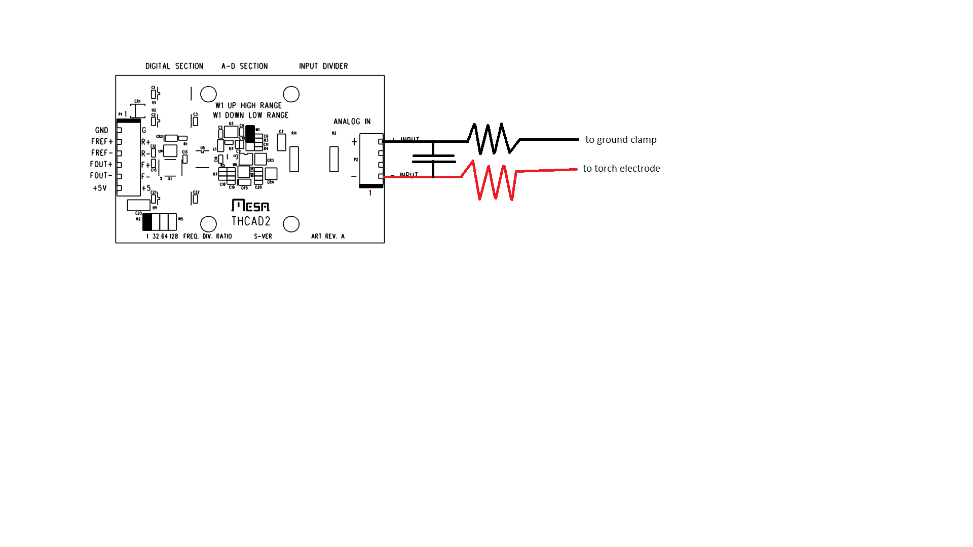

I did'nt yet, I just tried with the multimeter to read the arc voltage, and a simple circuit with a battery and a led to see if the reed relay was correctly activated. I'm going to wire to the THCAD today I think. I might lack the 2.5M resistor though. Could you tell me again which rating it should be ?
I am going to follow this wiring diagram (second one) for the THCAD-2 : forum.linuxcnc.org/38-general-linuxcnc-q...-questions#gallery-2

2 x 2 W resistors will be fine

He mentioned several times he has a HF/HV start plasma, the THCAD manual clearly states not to use that combo.
Having cleared that cautionary tale, THCAD can work with HF/HV start as can be proven by probably 10 i have in use daily, just some care must be taken when wiring to choose a suitable point where the HF has less effect, usually at the rectifier output or at the built in HF filter/protection.
And additionally a few days back i wired a THCAD10 directly to outside connectors on a new cheap china inverter plasma with HF start, THROUGH 2 resistors and added a 0.22uF/350V capacitor across the THCAD input just to be on the safe side, and it also filters the readings a bit. Used it for 2 days, all good, probably did over 200 starts as i was tuning voltage/feed/air so made a lot of 100x10mm rectangles.
Just to be clear, do this at your own risk, any mishaps usually end badly.
A 0.1uF capacitor would be better, did not have one with such high voltage.

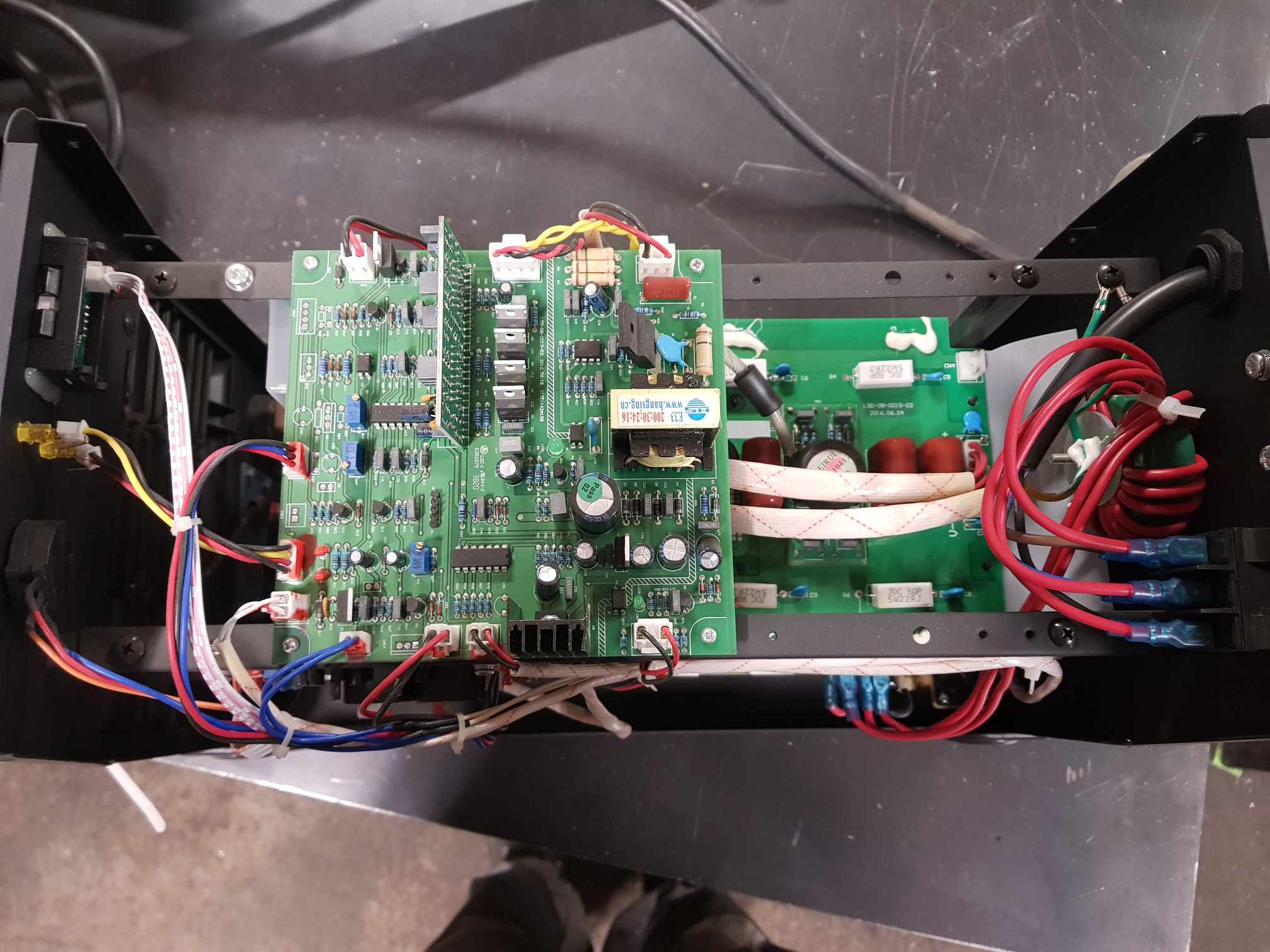

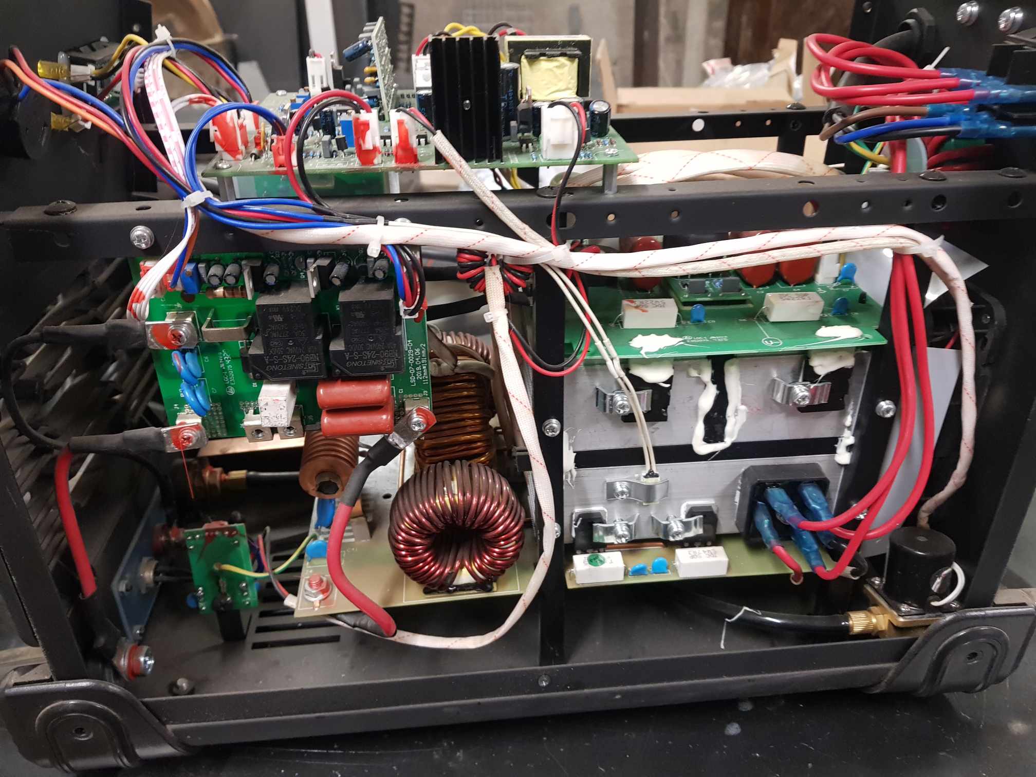

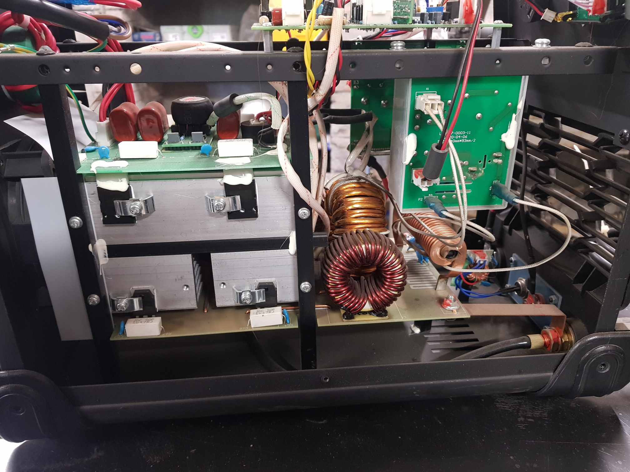

06 May 2024 10:14 - 06 May 2024 11:55 #299928
by polskleforgeron
When you say "just some care must be taken when wiring to choose a suitable point where the HF has less effect, usually at the rectifier output or at the built in HF filter/protection", do you mean that I shouldn't take the arc voltage the "simple" way from the ground clamp to the torch electrode, but instead get the wiring inside the Plasma cutter ? I think maybe I can do that..
Also when you say you plugged the cheap china plasma through 2 resistors (both 1MO 2W) with a capacitor (0.1uF and what power rating ?) shorting the two, would it look like that :
I've added some pictures of the plasma's cutter inside :
Replied by polskleforgeron on topic The blacksmith's plasma table
Thank you again for your explanation, but it's a bit technical for me and I'm not sure to understand.@Rod,
