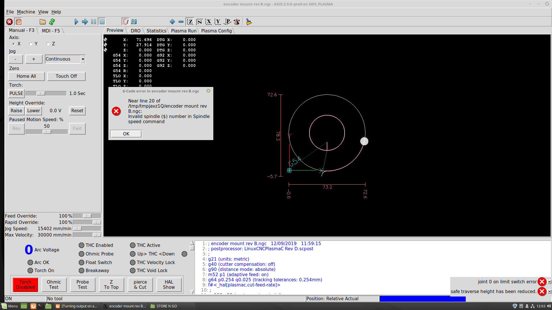

Center Spot Sheetcam Post
- thefabricator03
- Visitor
12 Sep 2019 01:08 #144858
by thefabricator03
Replied by thefabricator03 on topic Center Spot Sheetcam Post
ok git reset HEAD --hard got be going.
- phillc54
- Posts: 5711
- Thank you received: 2100
12 Sep 2019 01:10 #144859
by phillc54
Replied by phillc54 on topic Center Spot Sheetcam Post
What reply did you get from git reset --hard
- thefabricator03
- Visitor
12 Sep 2019 01:12 - 12 Sep 2019 01:13 #144860
by thefabricator03
Now bigger problems
plasma@plasma:~/linuxcnc-dev/src$ linuxcnc
LINUXCNC - 2.9.0~pre0
Machine configuration directory is '/home/plasma/linuxcnc/configs/sws_plasma'
Machine configuration file is 'sws_plasma.ini'
Starting LinuxCNC...
twopass:invoked with <> options
twopass:found ./sws_plasma.hal
twopass:found ./plasmac.hal
twopass:found ./sws_plasma_connections.hal

Axis window is 1905 x 1050
HAL: ERROR: pin 'plasmac.thc-active' not found

task: 86 cycles, min=0.000006, max=0.010561, avg=0.006624, 0 latency excursions (> 10x expected cycle time of 0.010000s)
hm2_eth: HostMot2 ethernet driver unloaded
hm2: unloading
Note: Using POSIX realtime
/home/plasma/linuxcnc_debug.txt
and
/home/plasma/linuxcnc_print.txt
as well as in the output of the shell command 'dmesg' and in the terminal
Any ideas?

- thefabricator03
- Visitor
12 Sep 2019 02:05 #144869
by thefabricator03
Ok.
When I try to load the gcode that has the tool center spot I get this error,
