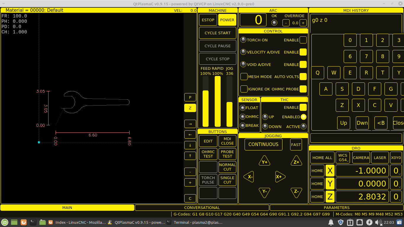

Is there a way to reset the feed override and rapid override to default values with a single click? I find it hard to reset the feed override to 100%,
To me, I think clicking on the "Feed NNN%" should reset it to default 100%.
Its ok if you only use the scroll wheel and don't drag the bar but with a touch screen, thats not a solution.

Been using the buildbot install from two weeks ago, sim works fine, machine ..... i have it set up to a certain point but had no time to play with it as i used the time to install the designer and figure out how to use it as i need to make everything bigger, all my monitors are 1920x1200 so everything looks tiny on it.
Will try to update and report back.
- Posts: 12161
- Thank you received: 4151
10 Jan 2021 11:37 #194711
Replied by rodw on topic GUI for PlasmaC - QtPlasmac
The current screen size is perfect for a 15.6" monitor like the ASUS VTI168H I use
Its 1368 x 768 which QTPlasmac supports
I found the 19" touch screen I put on the spaceship is far too big and the hand movement is excessive with Gmocappy as it forces you to move from the top right to bottom left just to start and home the machine. QT Plasmac is much better in this regard and does not require the homing screen to be slected as Gmocappy does.
Geez, I just realised I have not connected the touch screen to it!

Phew! It works!
Phew! It works!
