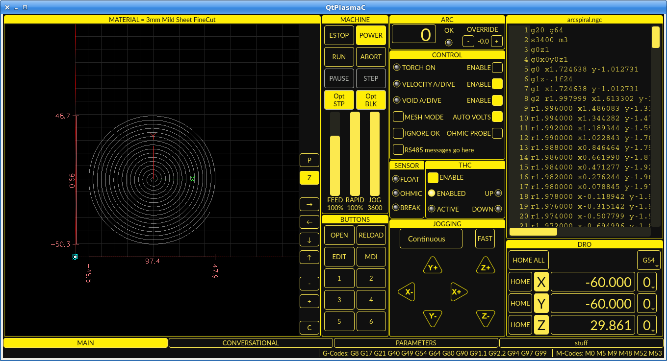

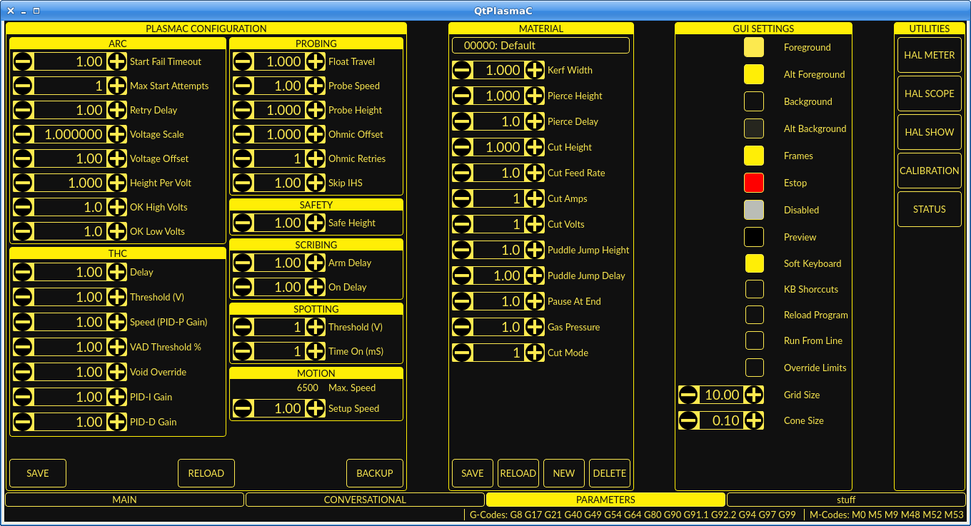

03 Nov 2020 05:35 #188176
by phillc54
Replied by phillc54 on topic GUI for PlasmaC - QtPlasmac
The following user(s) said Thank You: tommylight, Clive S, rodw, snowgoer540, pinder
- Posts: 21995
- Thank you received: 7488
03 Nov 2020 06:49 #188179
Replied by tommylight on topic GUI for PlasmaC - QtPlasmac
Looking nice!
- snowgoer540
- Posts: 2580
- Thank you received: 907
03 Nov 2020 11:48 #188206
by snowgoer540
Replied by snowgoer540 on topic GUI for PlasmaC - QtPlasmac
This is really looking great!
