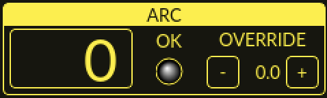

1) Z Axis Jog to control voltage during cut, basically use the Z axis jog buttons to override the actual voltage, while arc ok is present. I really don't know if this is too complicated to implement but it will be nice to have.
2) I was thinking in a more process oriented distribution of the controls, for instance, we remove e-stop then activate PowerOn then make a Home All after that we load a file and finally run it maybe we can have a distribution of controls that we can follow these sequence, once again it is a nice to have.
3) the buttons can be a little larger for 20-24 touch monitors.
I will continue using it and share the comments
thanks to all for the great work, finally a decent System (no only GUI) for plasma user
  • phillc54
  • phillc54's Avatar Topic Author
  • Offline
  • Platinum Member
  • Platinum Member
24 Jan 2021 02:11 #196375 by phillc54
Replied by phillc54 on topic GUI for PlasmaC - QtPlasmac
So you suggest getting rid of the + and - overrides and using the Z+ and Z- buttons instead.
Warning: Spoiler!

phillc54 Wrote:So you suggest getting rid of the + and - overrides and using the Z+ and Z- buttons instead.
Correct
