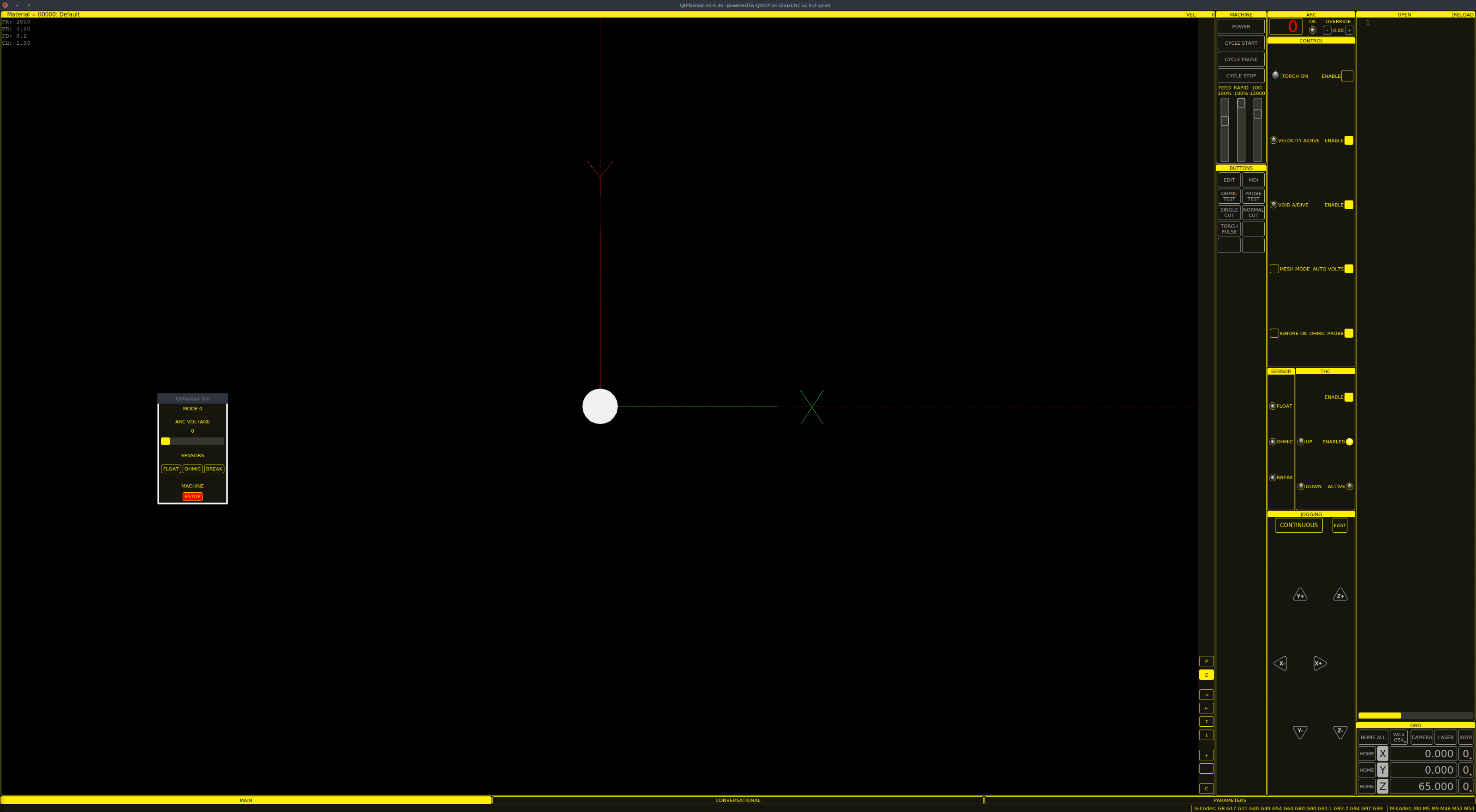

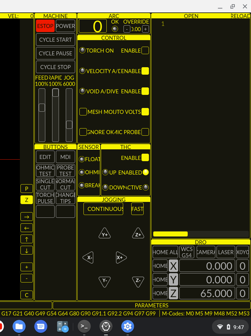

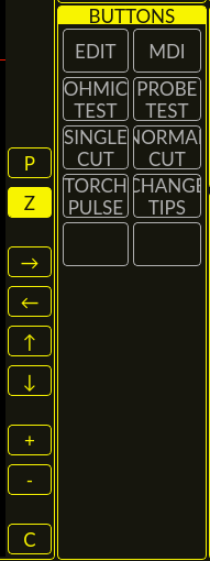

The eight user buttons can be any valid user button, none are set in stone...
Why limit it to 8 user buttons. It seems like there is space for a lot more, maybe 18.
Why are we wasting so much screen real estate below the buttons?
Its not really fair on the user to provide 8 user buttons and then use 6 of them in a default install. Most of them are required
Actually at any screen resolution up to I am seeing fields being cropped even up to 2194 x 1234.
There is just too much space being taken up with the preview
Is there a font that needs installing?
Because that is all that fits in a 1366x768 screen. I am sure I did mention earlier on in development that this would be increased down the track when functionality is finished.
It is not fair to expect me to have this finished yet either. If you don't like it don't use it, I don't really care.
I don't see any cropping, even at 3961x2154 on either Debian Buster or MX-Linux 19.3
