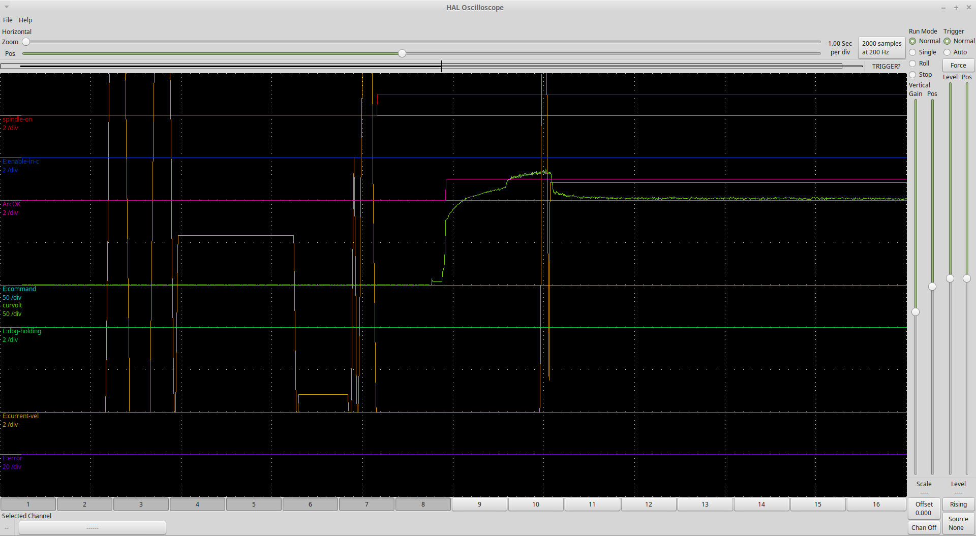

rodw wrote:
Thats not 100 ms! Its one second.
The division is the minor tick. 10 minor ticks per vertical line.
That doesn't make sense to me, so in the first of Clive's Halscopes the sawtooth is 5Hz and the arc voltage is around 1400V or am I missing something?
I have always thought the full length line was the division and the minor ticks were a subdivision.
19 Mar 2020 00:41 #160695 by phillc54
Replied by phillc54 on topic PlasmaC torch starting problem
Then there is the instant torch off after an arcok, normally assumed to be from to much voltage, but it looks more like failure due to a spike in voltage, and not just the torch voltage.
That is my reading of the plot as well.
I would think that the arc voltage in the following scopes 100/div would = to about 210V ie ( two and a bit divisions high).

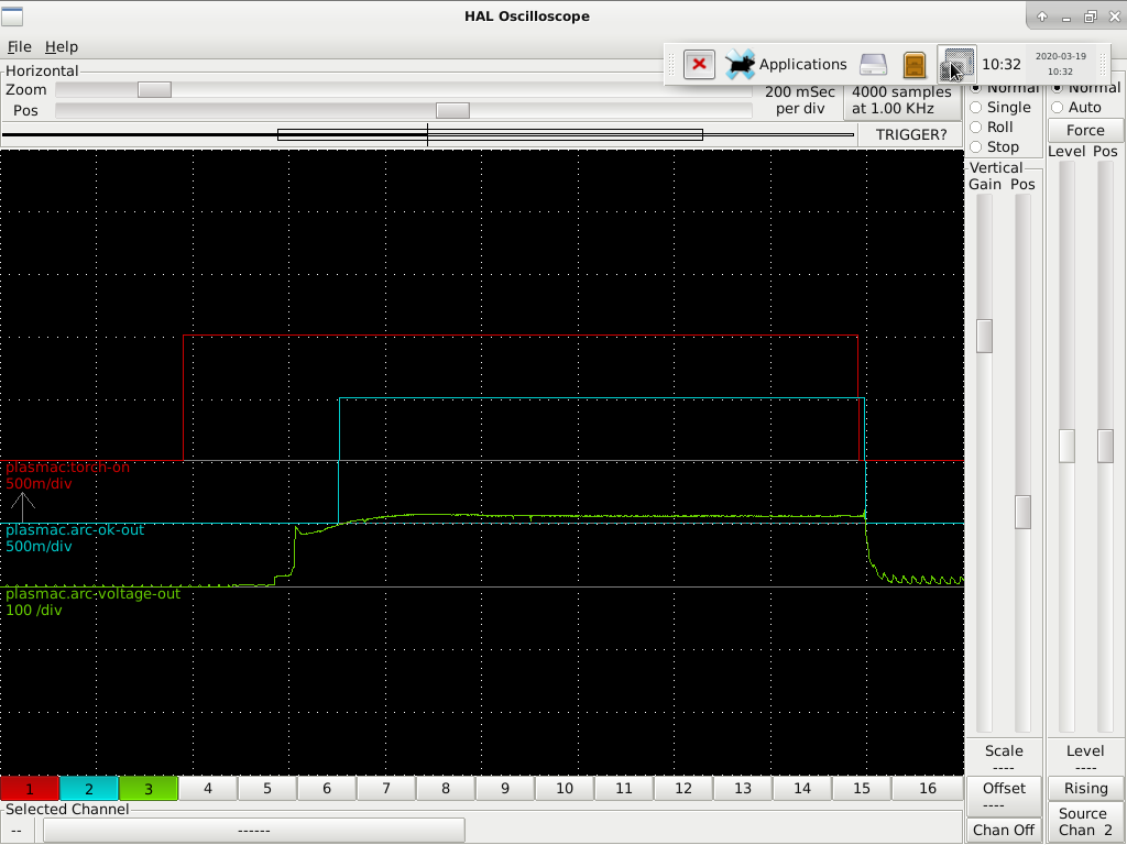

This is "ok cut after air stopped setp1000"
This is "ok cut after air stopped setp900"

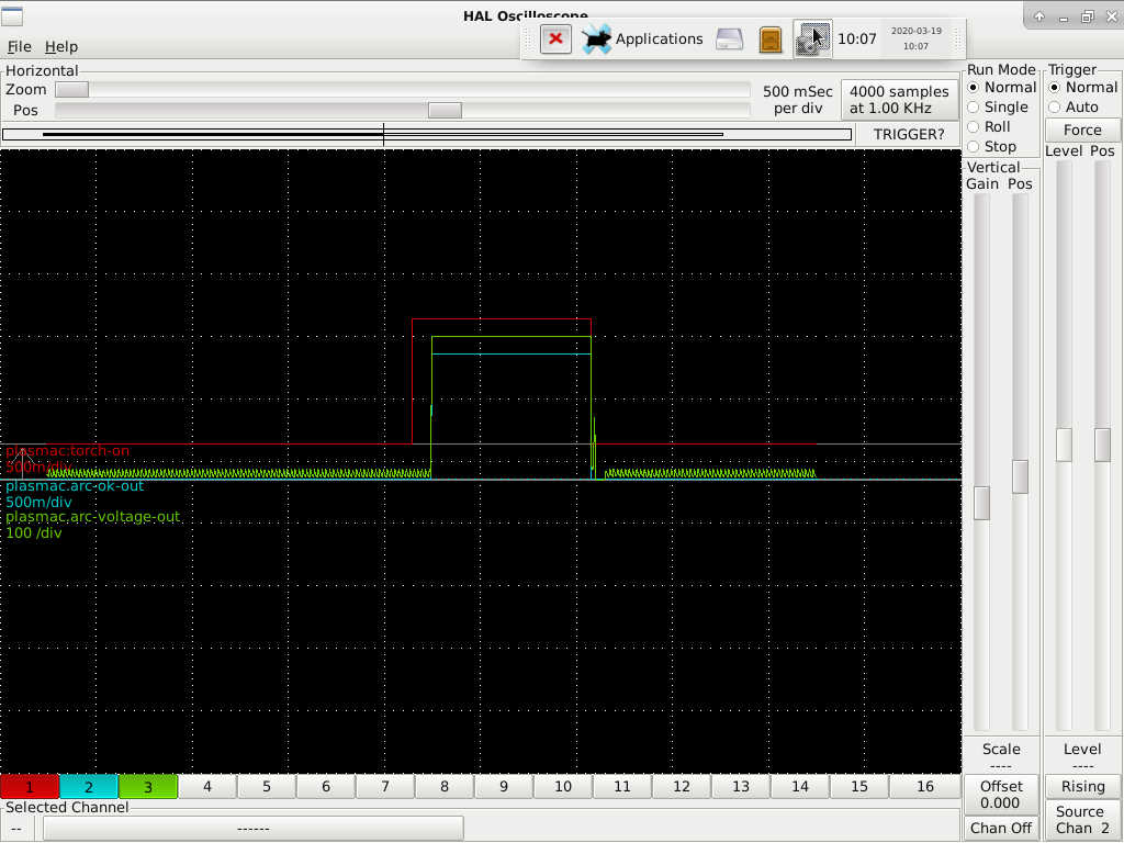

fail arc setp 1000
fail arc setp 900
fail arc setp 200
19 Mar 2020 12:11 - 19 Mar 2020 12:12 #160738 by rodw
Replied by rodw on topic PlasmaC torch starting problem
Clive
Ones like this look artificial and not an expected plot (your OK cut ones are )
There is no deviation in the torch voltage and that will happen becasue the "anode spot" where the arc terminates oscillates the top of the material to the bottom.
The arc voltage rise time is not instantaneous as shown here by the square wave shape so I think something is faking your arc voltage. What is on the plot is not real.
I think there is something going on here and I don't know if Plasmac is manipulating a bad case to make it worse. But then again so many users use Plasmac and it works perfectly so I suspect its your machine.
I would be looking carefully at every connection and component on the torch voltage monitoring side.
It might be helpful if you shared some details again of your plasma cutter and the wiring in of the THCAD.
Last edit: 19 Mar 2020 12:12 by rodw.

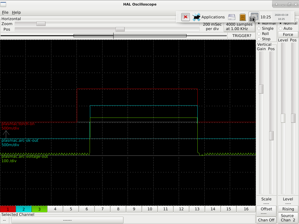

19 Mar 2020 12:21 #160740 by rodw
For what its worth, here is a plot of my old 50 amp Everlast with the THC not enabled
There is definitely no immediate instantaneous rise time as you show.
I Personally think you should walk away from this for a while, stop cutting and relax for a day or so then work back through the electronics to ensure they are perfect. Something is wrong.
