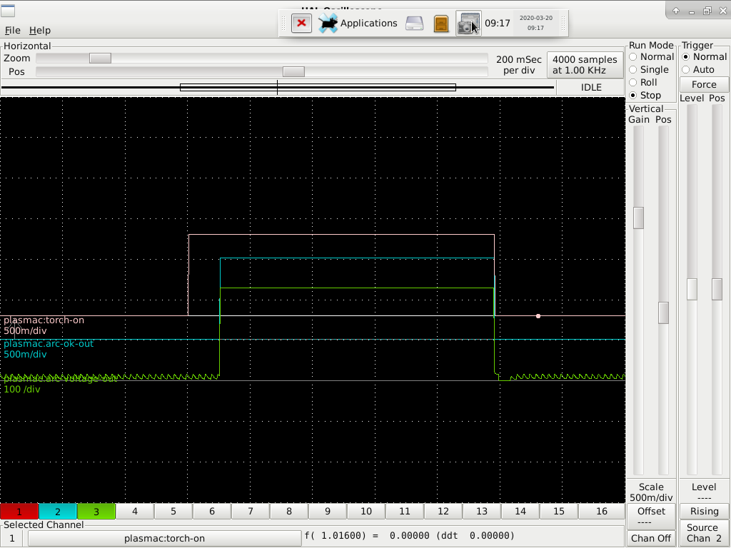

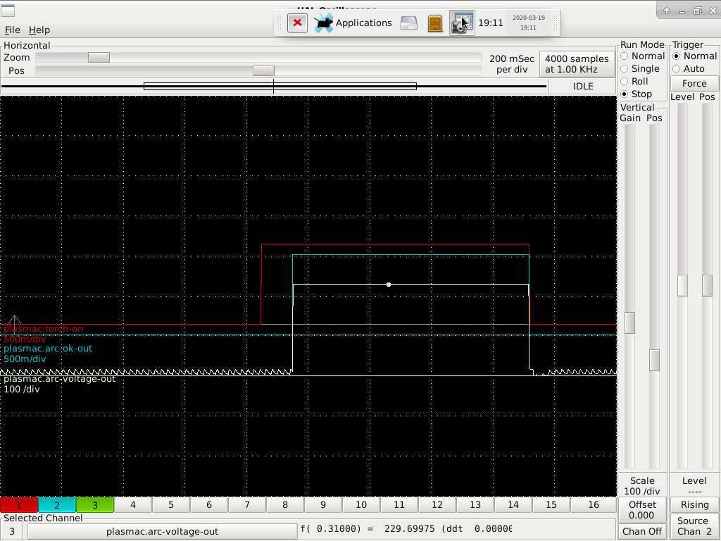

From all these plots it seems to me that PlasmaC is doing what it should do.
My take is that the fails are reading the pilot arc and not the cutting arc.
It is interesting that the first cut is always good and the waveforms do show that.
From the plot below it looks to me like the voltage drops off before the arc ok and the torch on which would be correct behaviour on PlasmaC's part but it would be nice to confirm that with say a 1ms or 5ms division.
Warning: Spoiler!
Phil thanks.
which signal should I change to 1ms or 5ms or are you asking for the Hoz display set from 200ms to 5ms

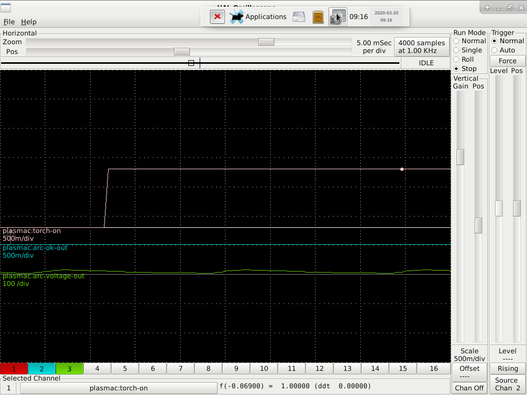

19 Mar 2020 22:58 #160789 by phillc54
Replied by phillc54 on topic PlasmaC torch starting problem
Yes, the horizontal thanks Clive so I can better see the timing of those signals.

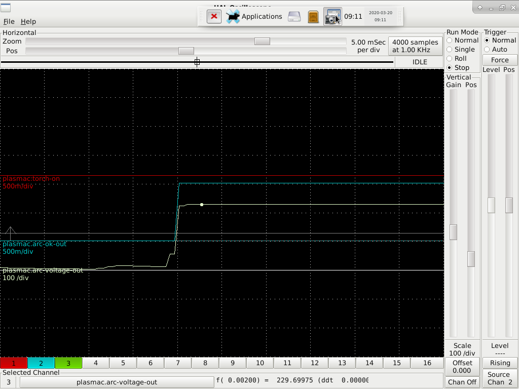

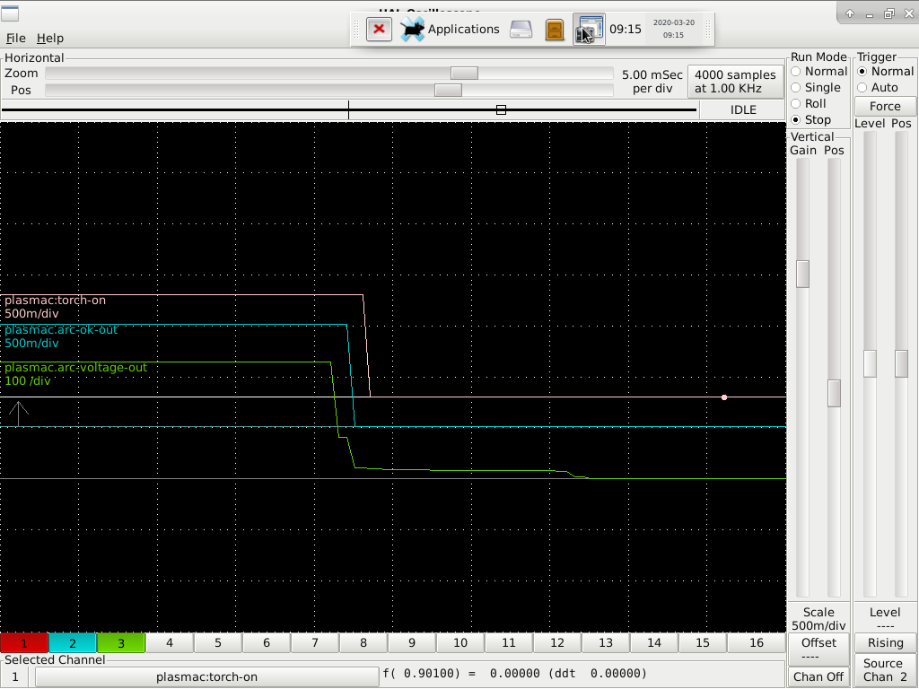

20 Mar 2020 10:14 #160846 by Clive S
Replied by Clive S on topic PlasmaC torch starting problem
fail 5ms
End trace 5ms
start trace 5ms
full trace 200ms
20 Mar 2020 10:20 #160847 by phillc54
Thanks Clive, the second trace shows PlasmaC behaving correctly.
It seems Tom and Rod are on the right track about the pilot arc not transferring so the pilot arc turns off.
It may be worthwhile doing some probe tests and check the height. It should end up at Pierce Height until it times out and returns to the start point.
