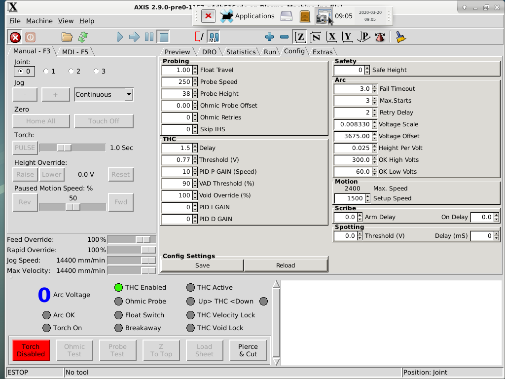

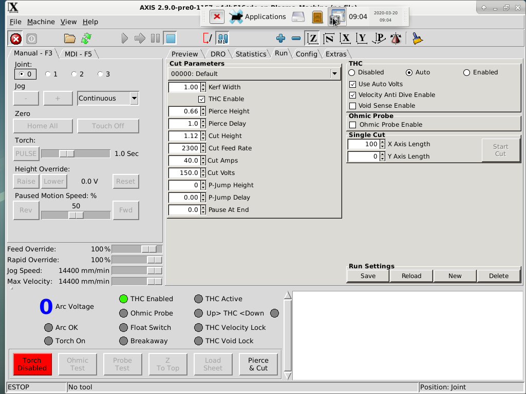

[="tommylight" post=160819]Clive, i am sorry for the mess we have created for you, and also sorry for having to ask you this, but several posts back i asked you to check the torch distance from the material after the first and the second probe, now Rod has mentioned the same thing, so please do check that.
I have done that and they are the same
So to recap:
-Please do not lower the low voltage threshold ever again, it did cause us some head scratching, and some stray answers .....,
-PlasmaC is configured and working correctly,
-Wiring is all good,
-The noise is present while the inverter power stage is on, so nothing to worry about, most probably,
-Please oh please lower the pierce height and the cut height ! :) :) :)
Pierce at 2mm and cut to 1mm, test and report back
pierce height is 1mm - cut height is 1.12 - Low voltage threshold is 60V
I have posted this vid on Rods post as well photos.app.goo.gl/6zcqkkwaVM8b5MBN8
I noticed the air purge stops briefly when the button across the relay contacts is pressed. The button need to be pressed for about 250ms
I also noticed some times when the button is pressed I see a weak pilot but then it always goes to the full pilot

I may be missing something here. It seems to me that the PlasmaC generated Ark Ok signal should only be true when the plasmac torch on signal is true
Yes, I believe this is correct. PlasmaC will only continue if both are true even though Arc OK is capable of being displayed without a Torch On signal.
@Clive.
Did you try a probe test?
I think you have your Pierce and Cut Heights reversed.
It may be worthwhile checking you gas pressure and setting it toward the lower end of the recommended setting.

Did you see the vid I posted in Rods answer re the pilot arc with a button across the relay contacts.
photos.app.goo.gl/CMsrzHHvmNoPguUR9
