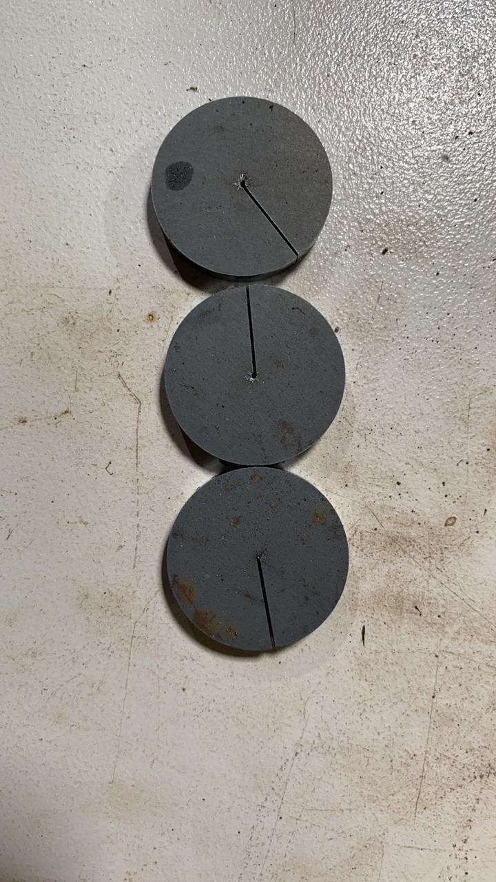

08 Jan 2021 17:40 #194522
by taloot
Replied by taloot on topic PlasmaC Fiber laser 1Kw head height control + auto focuas
- grijalvap

- minhthanh
- Posts: 1
04 Jul 2021 13:39 #213684
by minhthanh
Replied by minhthanh on topic PlasmaC Fiber laser 1Kw head height control + auto focuas
hello,
its been a while since last update,, but i will descried some of problems im working in now
advanced fast THC with very low tolerance
,multi stage piecing
without those 2 its impossible to achieve good cut and super tiny pricing hole
Any new update on your project, I am a fiber laser user and have upgraded co2 laser machine to fiber but using china controller. I am very interested in your project. Can you give me your contact? I want to talk more.
