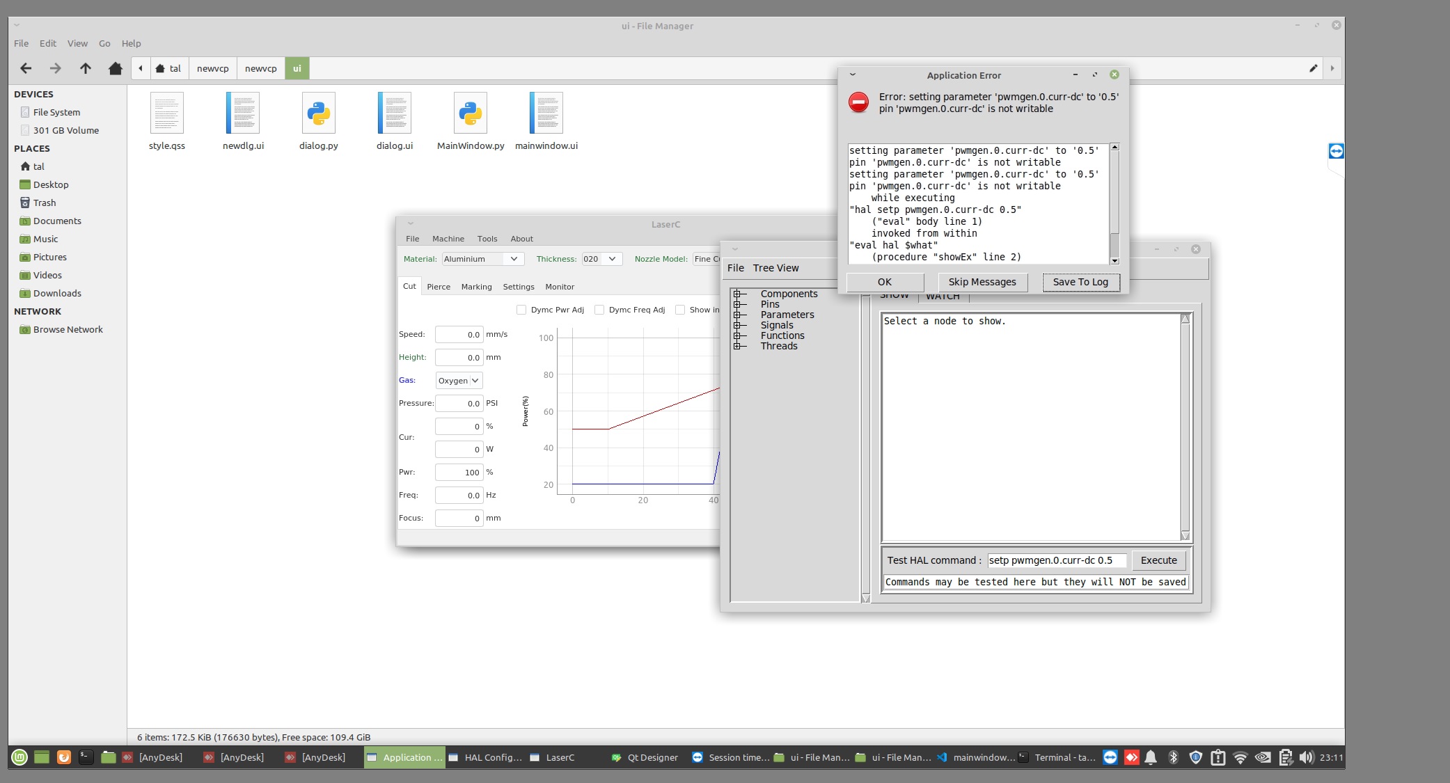

24 Aug 2020 09:31 #179209
by taloot
this is it working in simulator,,,
but i dont know how can i run the qtpyvcp embedded
Replied by taloot on topic PlasmaC modification to fit fiber laser rs485 control head capacitance Autofou
- phillc54
- Posts: 5711
- Thank you received: 2100
24 Aug 2020 09:35 #179210
by phillc54
Replied by phillc54 on topic PlasmaC modification to fit fiber laser rs485 control head capacitance Autofou
Looking good, did you try Qtvcp. I think that can be embedded similar to Gladevcp.
