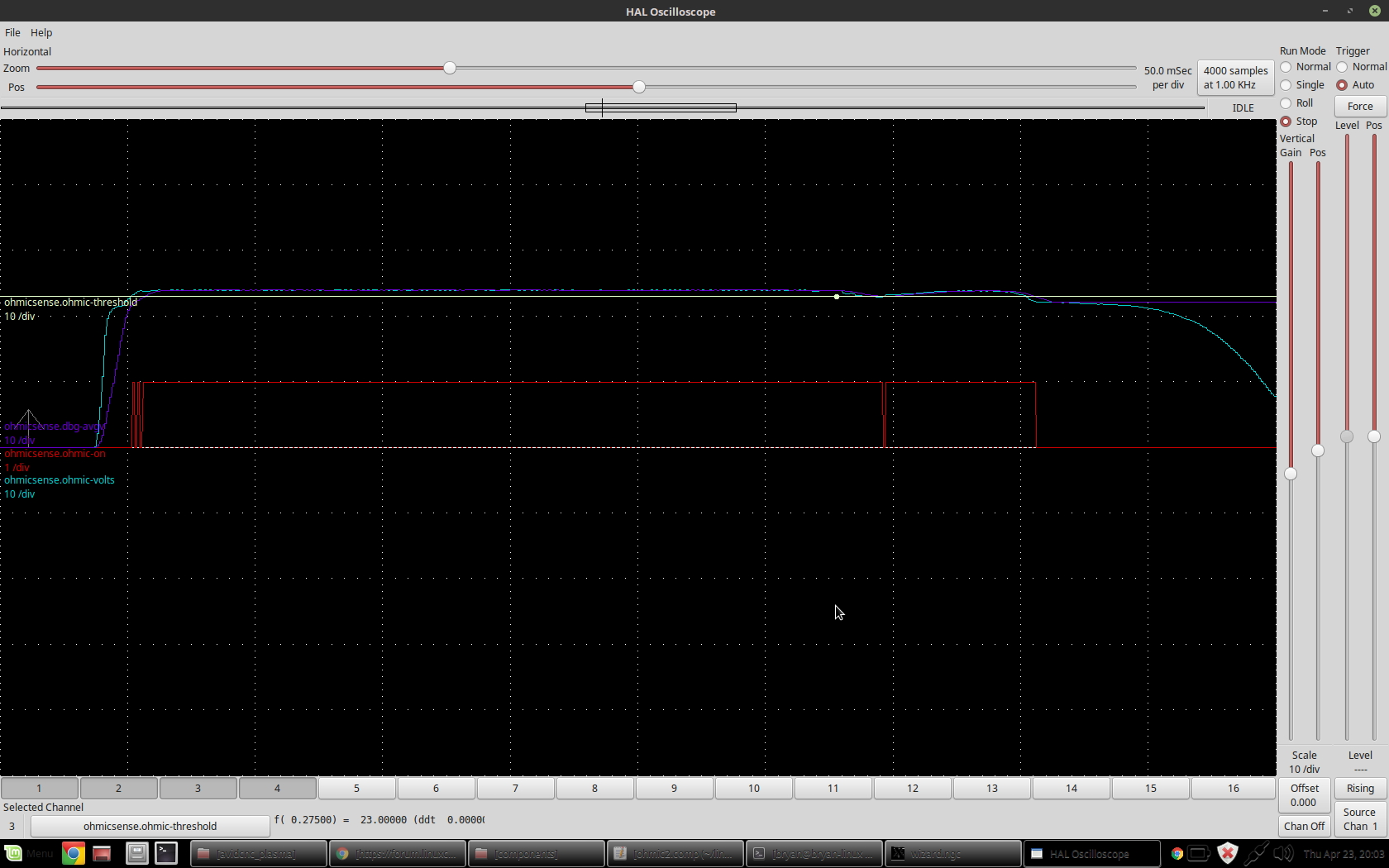

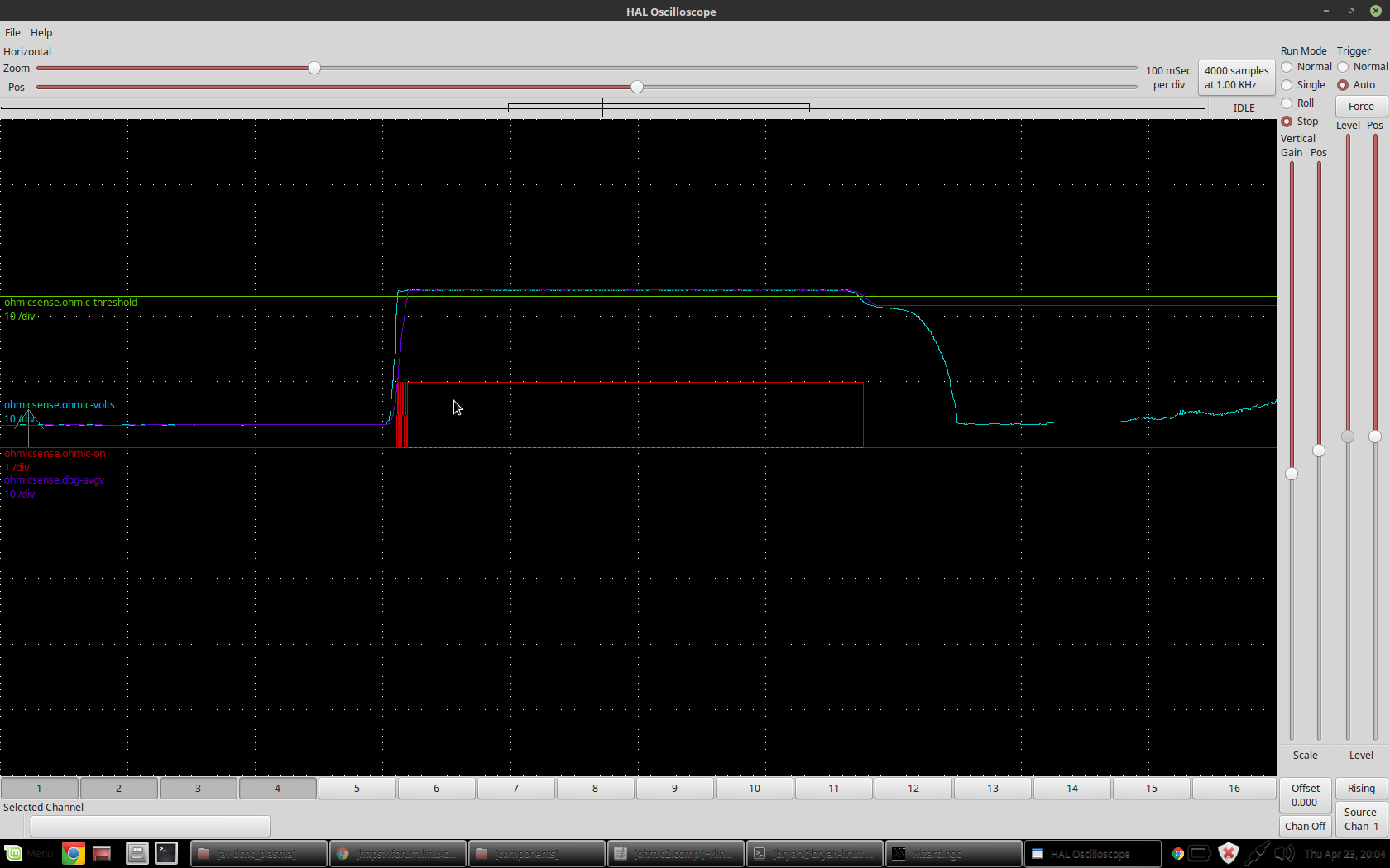

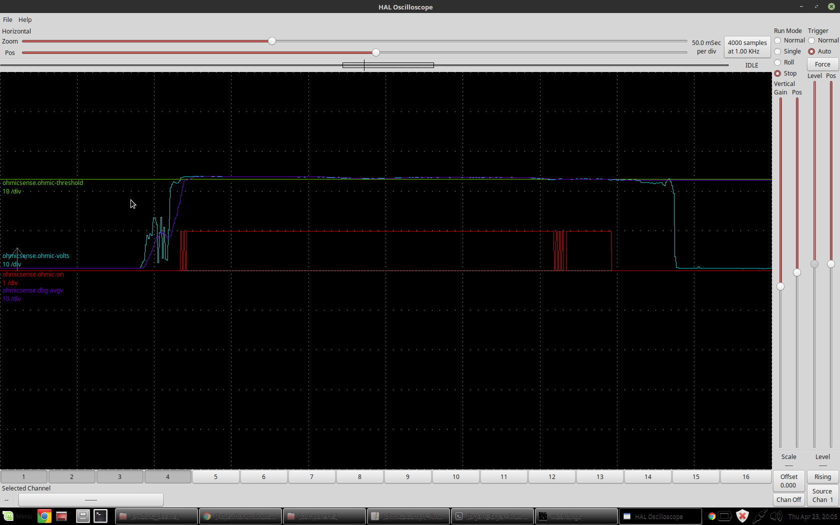

I did another bolt hole circle. Cut fine with no issues. Here's the data
Also include the .log files (renamed to txt) if you want to analyze it further

Looking good. Can you bring the threshold down a bit so you don't get the probe signal going off in the middle of the run?
It looks like your threshold is right at your full scale voltage. Maybe 1 volt to be safe but even 0.5 volts. would be nice.
The signal is nice and smooth now anyway

Yeah it would probably benefit from some tuning. My threshold is actually at 23v. If you're looking at the pictures, the cut section is later and was cropped out.
The signal is much cleaner, great work on the comp!
