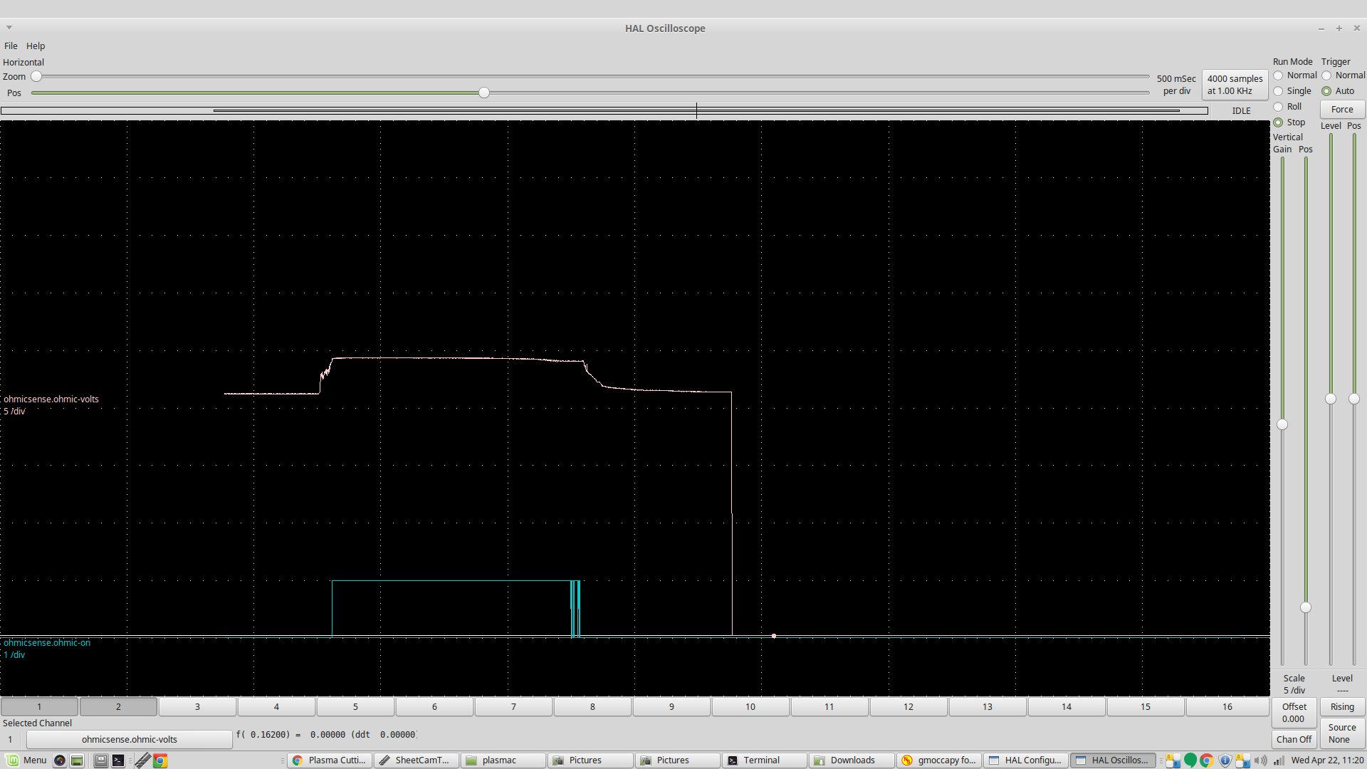

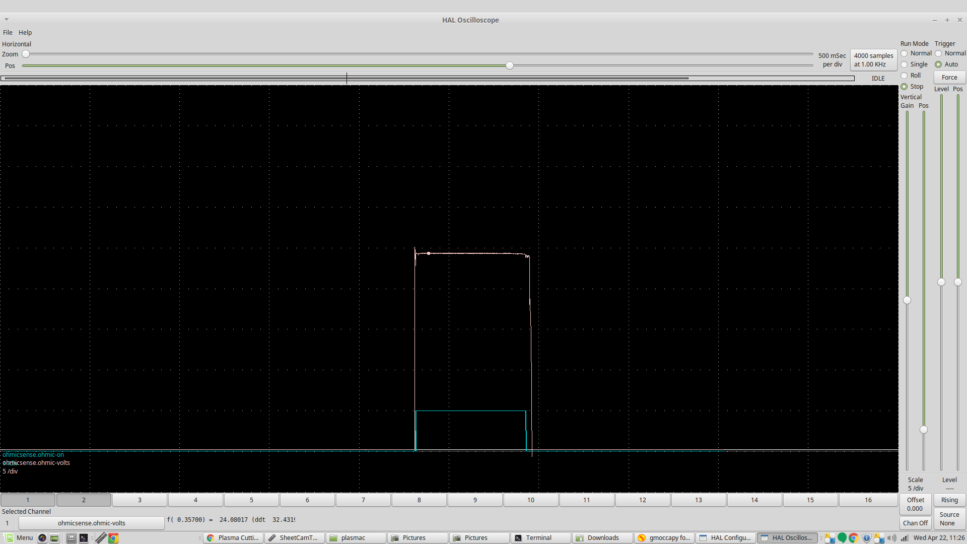

Well, it looks like this was a success. The following two plots show
Dry Torch
Wet torch
Goes from about 21 volts to 24 volts so I've set my threshold at 22 volts using mode 1 on my new component
I cut a test part with 48 probes with a wet torch and it did not falter.

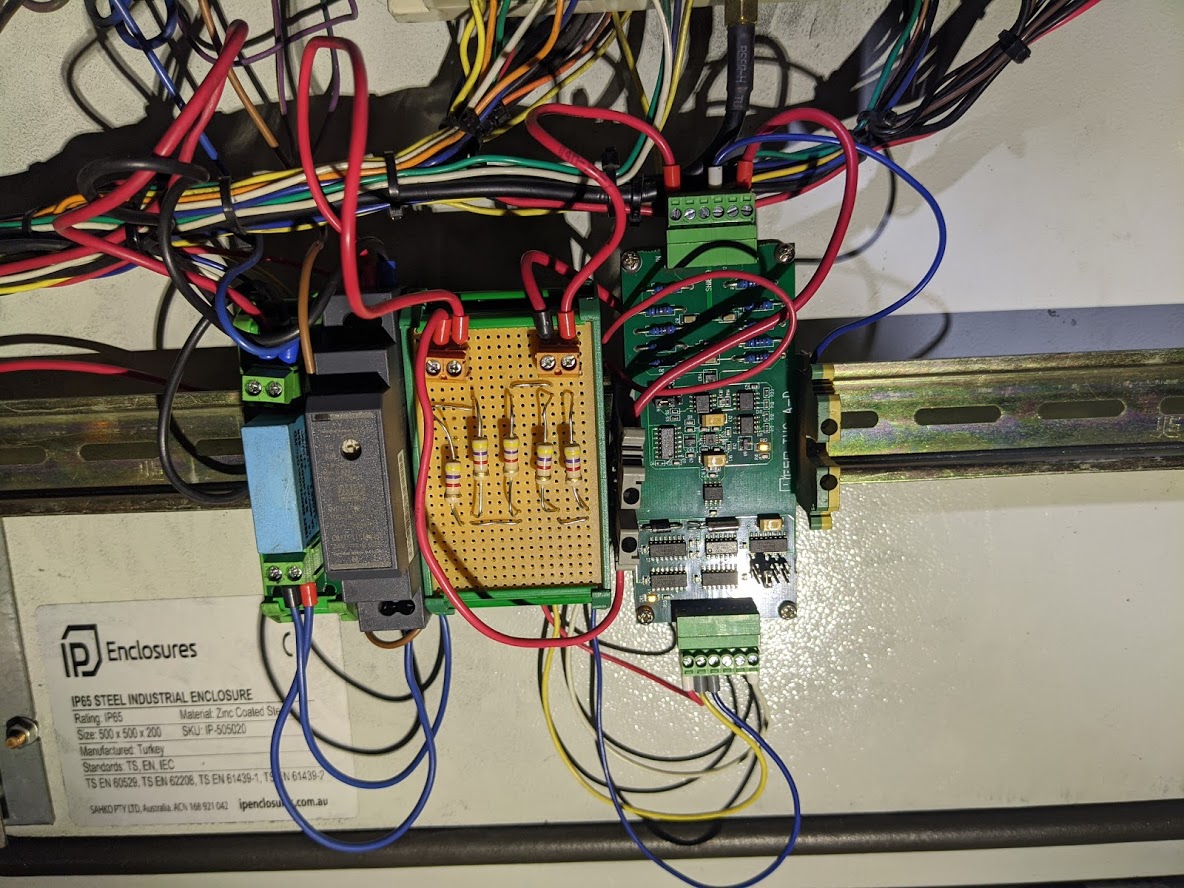

22 Apr 2020 02:11 #165030 by rodw
Replied by rodw on topic Hypersensing questions
So here's what I have now in the control box. Having two terminals on each side of the resistors made it very easy to install.

Actually, looking at that plot, we are getting some rapid changes in the ohmic-on pin at the end of probing. I think I need to revise the component so when the probe turns off, it stays off until the end of the probing event. I'll wait until you guys test and report back!

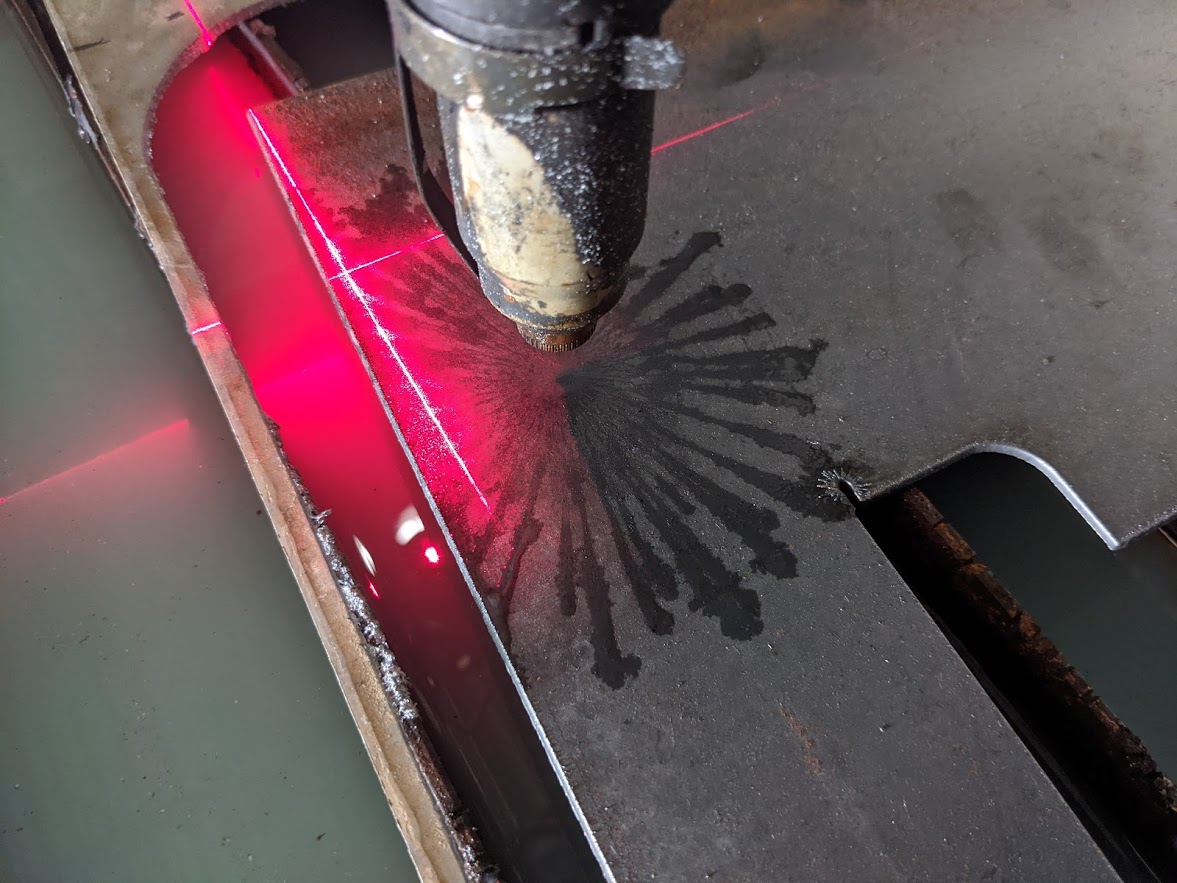

22 Apr 2020 09:40 - 22 Apr 2020 09:40 #165061 by rodw
And this pic shows the amount of water expelled from the torch after pulsing it at the end of a cut
