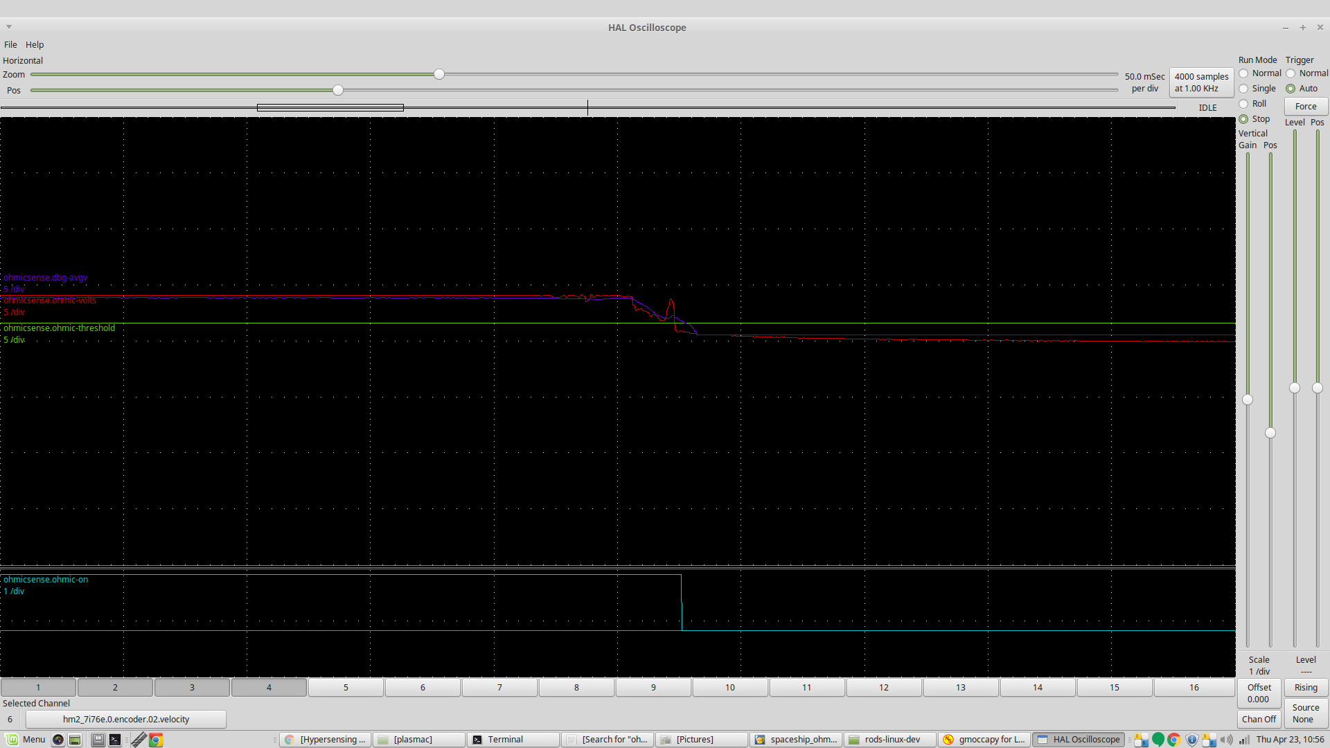

I think we should get feedback from Snowgoer as well. I think also that using a moving average will help smooth the signal and remove some of the noise. Here is a plot of average volts with N=10. I found N=5 was still a bit twitchy.
Blue line is the average, red line is actual volts... I've also added some pins so I can turn the relay on when motion.motion-type > 0
That lets the relay turn on when an axis moves so it can start averaging volts before a probe event.
I'm still not done playing here though.
Peter is smoothing the signal wise do you think?

I think you said it is then travelling at 0.001mm per servo cycle. Absolute worst case is the surface is out 0.01mm but in reality, the voltage is dropping very quickly from the full scale reading so I would expect any delay is a lot less than 10 servo cycles due to the added weight of the last couple of readings. What we don't want is the probe signal to oscillate on and off because of voltage spikes when contact breaks.
What I'd like to do is to come up with a method that self learns and auto calibrates continuously so the concept of a threshold is rendered obsolete. As it is, we have done away with the low threshold, we just need to do away with the high threshold now.
