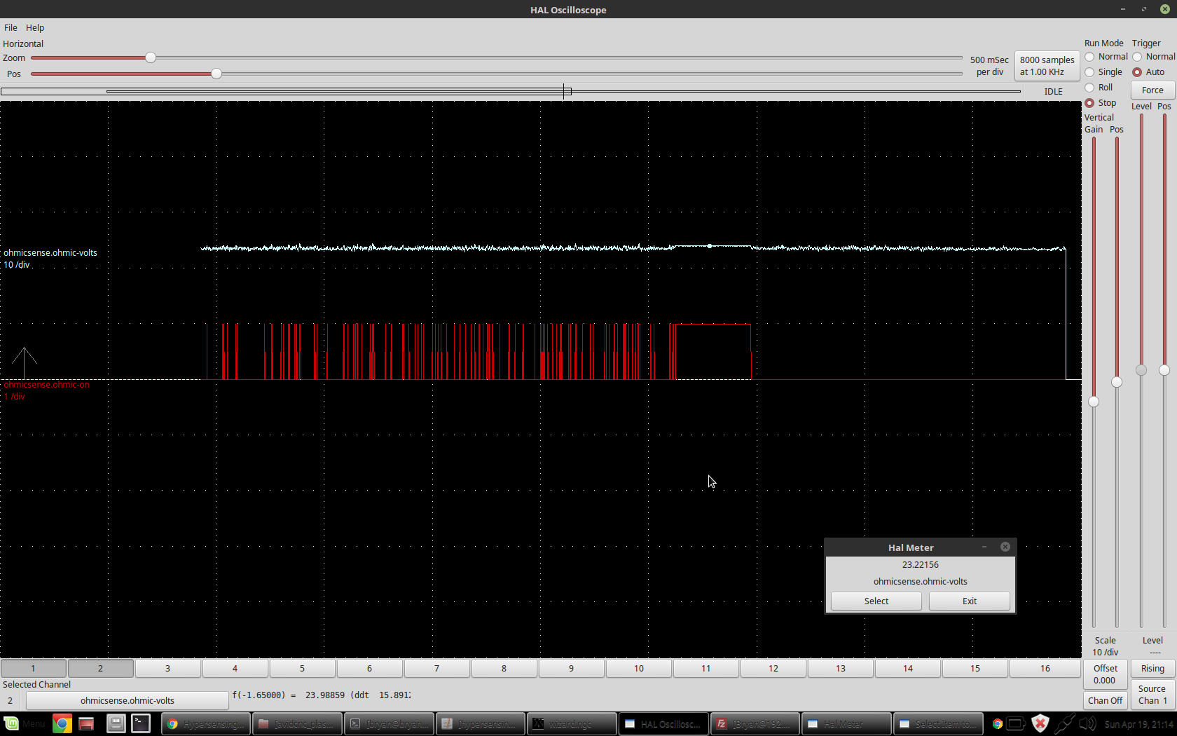

20 Apr 2020 01:33 #164706 by Uthayne
Replied by Uthayne on topic Hypersensing questions
Did a few more tests and its looking good!

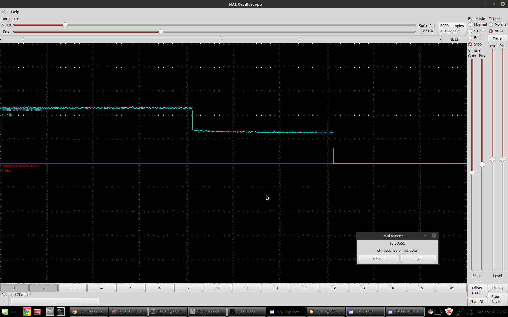

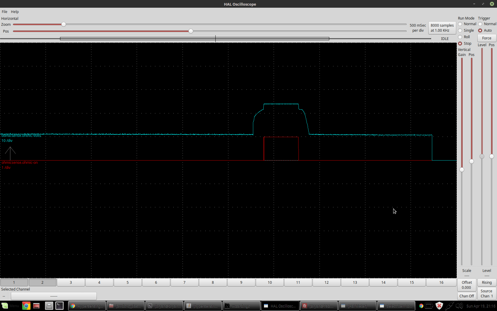

Before I test Rod's comp changes I figured I would add (temporarily) a 1/2W 22kOhm resistor and see what it does to the voltage when the torch is soaked. Proof is in the data
This is the baseline case. Lots of triggers. Using ohmic2.comp, but not quite the newest version with changing the ohmic threshold to look at argvolts.
Then I added a 22kOhm 1/2W resistor between +24V and IN- (torch) and the voltage dropped quite significantly when not probing.
And here's a probe event with the 22kOhm resistor in place (torch was off the entire time!)
It seems as though the easiest fix is to add a 22kOhm 5W resistor between +24V and IN- as it still retains its ~24V sensitivity when contact is made, but drops to about 15-16V (from 23V) when the torch just has water in it. I obviously did not fire the torch in any of these cases as my resistor is not high enough wattage. We'll get to that in a few days.
I still plan on testing the comp changes that Rod suggested to see if a software fix works and is reliable. Should be able to post that data tomorrow.

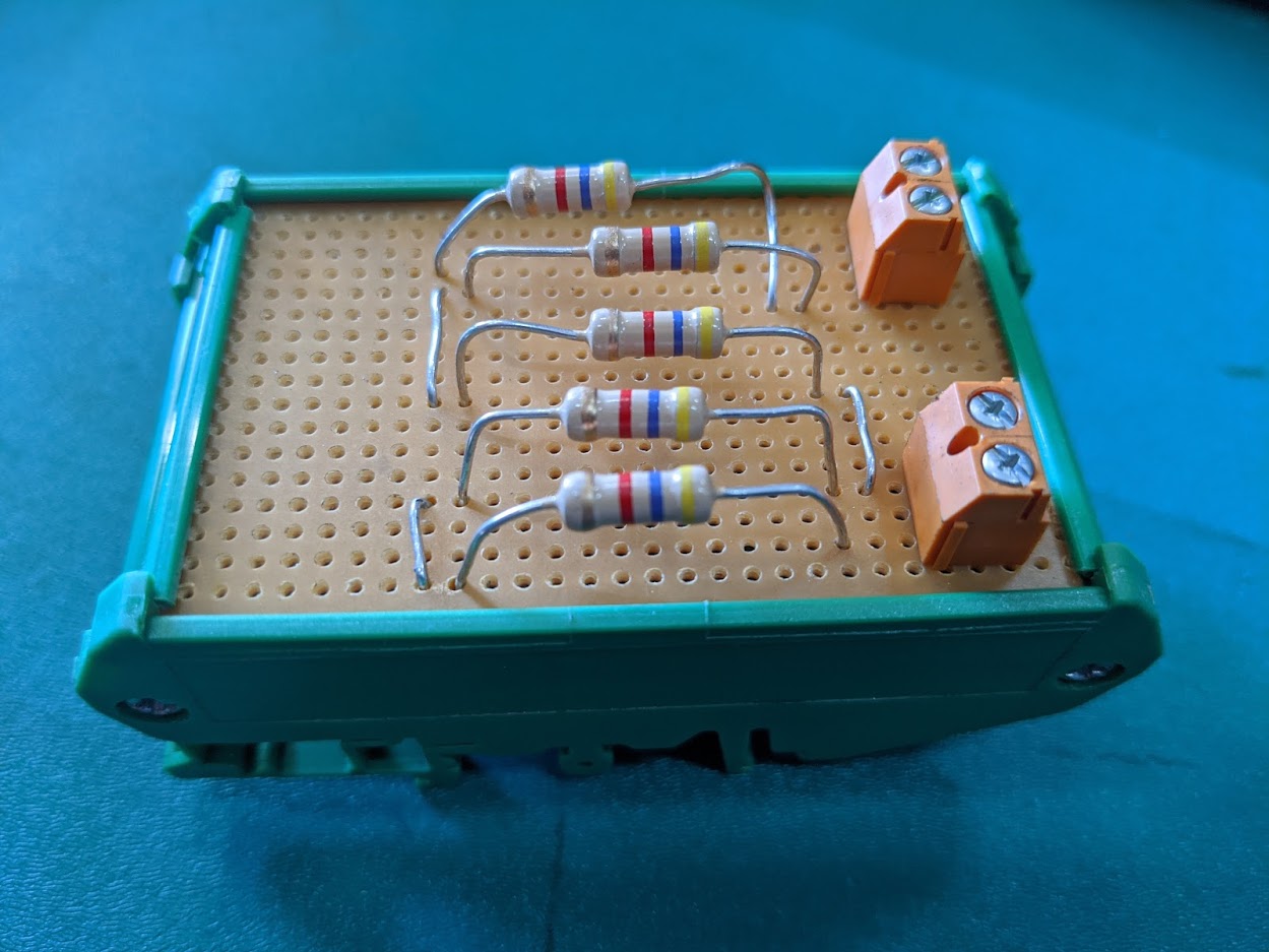

I had to start the day with a couple of extra coffees to fill in time before heading off to Jaycar our local electronics outlet on my rounds to pick up parts. Even then I still had to wait a few minutes for them to open. That was a good thing because PCW's resistor calcs arrived while I was filling in time.
Jaycar did not have anything in 5W > 4.7k so I came a way with 5 x 4.7k 1 W resistors which in series should give me 23.5k at 5 Watts. I don't think it will matter much about the values used as long as they are in the ball park. The value selected is a bit dependent on your suppliers range of components as people like Jaycar do not keep the full range of available values.

Well I had the circuit board and DIN rail holder so this was what came up with
But I think I'll let you guys blow something up first!
I figured those resistors might get hot so kept plenty of air around them....
