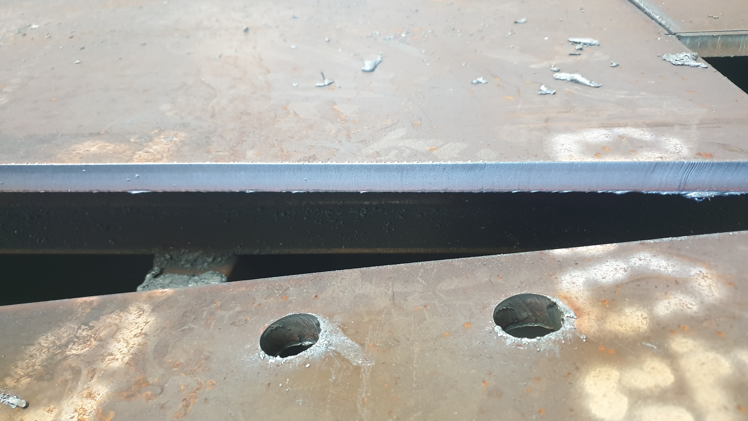

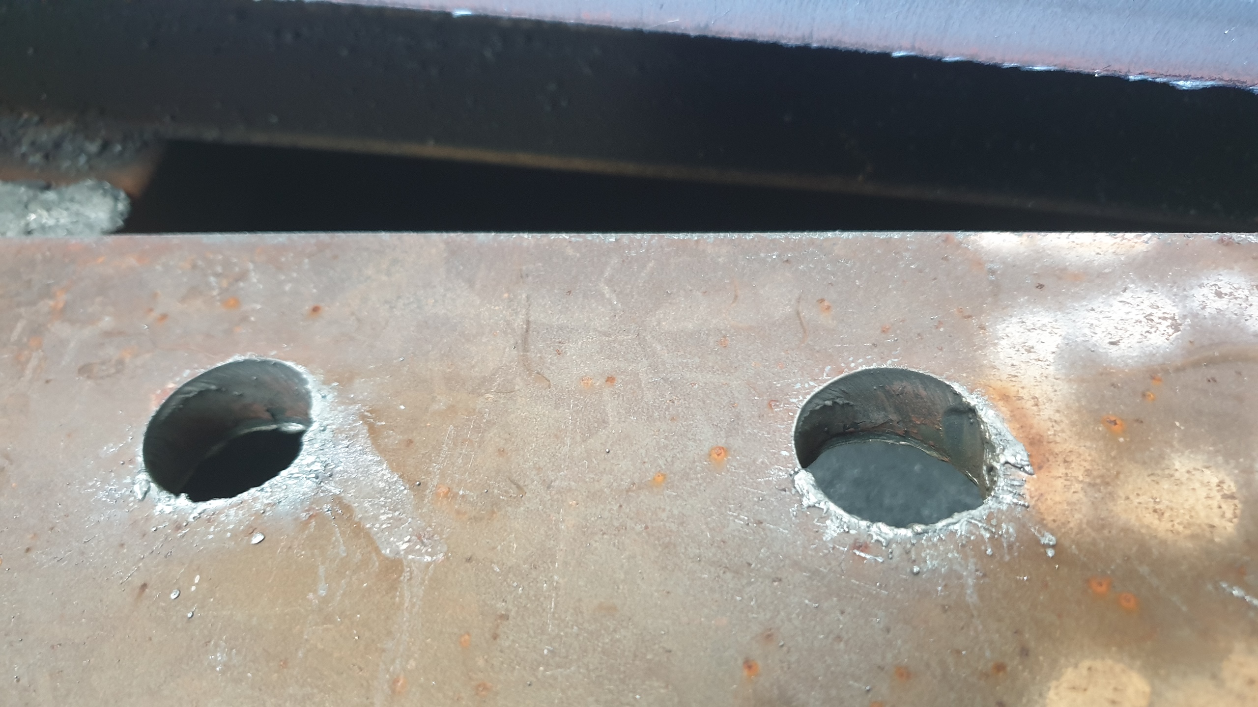

15mm thick mild steel, 24mm holes, cut with Trafimet torch and consumables, nozzle orifice 1.4mm, cut at 85A and 600mm/m.
No pictures of the finished part as there were over 20 people around the machine by the time it finished the first run of 10 parts.
Very little dross on the underside as can be seen on the first picture.
