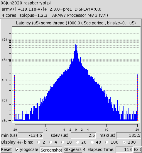

08 Jun 2020 22:03 #170705
by tecno
Replied by tecno on topic Raspberry Pi 4 with PlasmaC
- Posts: 21985
- Thank you received: 7485
08 Jun 2020 22:07 #170707
Replied by tommylight on topic Raspberry Pi 4 with PlasmaC
That looks much better.
Do you get lost connection now ?

08 Jun 2020 22:09 #170708
by tecno
Now time for this old fart to get some rest, will report tomorrow.
What puzzles me is uname only says SMP and not SMP RT PREEMPT

08 Jun 2020 22:16 #170711
Yup, that is why i asked, seems strange.What puzzles me is uname only says SMP and not SMP RT PREEMPT
- tecno
- Posts: 1850
- Thank you received: 127
08 Jun 2020 22:18 #170712
by tecno
Looks lika another day compiling LOL
- Posts: 21985
08 Jun 2020 22:19 #170713
Test it first, check if it works, no need to recompile/ The latency looks right where it should be.
