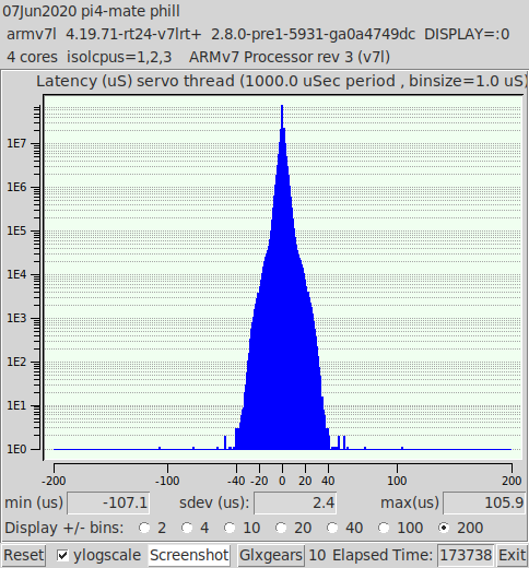

Replied by PCW on topic Raspberry Pi 4 with PlasmaC
If you launch LinuxCNC from the command line,
does it say:
"Note: Using POSIX realtime" ?
You may have missed the part where you select "Fully Preemptable Kernel"
in the configuration editor (or forgot to save the modified config file)

09 Jun 2020 01:22 - 10 Jun 2020 01:58 #170737
by phillc54
I had this same issue and it went away after I changed the servo period to 2000000. I didn't try find out why as it seems to work ok at this servo period.
This is mine after 48 hours:

Replied by phillc54 on topic Raspberry Pi 4 with PlasmaC
I added isolcpus = 1,2,3
But I stll get hm2/hm2_7i96.0: error finishing read
EDIT: This is now a complete image forum.linuxcnc.org/plasmac/39179-raspber...smac?start=80#170904
