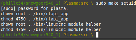

To confirm you are on the correct branch, add the following the the end of ~/.bashrc
 function parse_git_branch {
     git branch --no-color 2> /dev/null | sed -e '/^[^*]/d' -e 's/* \(.*\)/(\1) /'
 PS1="\[\e[32m\]\$(parse_git_branch)\[\e[33m\]\h:\W \ \[\e[m\]"
 export PS1
save it then either logout and login again or run from a terminal:
source ~/.bashrc

Luckily I woke up a bit early today, so I had a few minutes before I have to leave for work.
Did the above, the "source ~/.bashrc" makes my terminal look funny now:
Any way to change that back?
At any rate, updated, ran it quick, it still does the exact same thing as last night. :(

It will only show the git branch when you are in a valid git branch. If you don't like it remove the lines and run the source line again.
That is crazy, I cannot get it to go wrong. I will try on my machine tomorrow if I get time, I am only testing in sim mode.
No, it's ok, I just didnt know it was supposed to stay that way. It's good to know what branch I'm currently pointed at.
Hmm, I'm not sure I know how to test in sim mode (to see if it would act normal in my sim mode vs a real machine).
As far as things that could be different, did you add Rod's Ohmic3.comp to the simulation you are running? That's about the only thing I could figure wouldn't be the same because. Off the cuff, I wouldnt know what difference that would make, but I guess we have to consider everything at this point.
