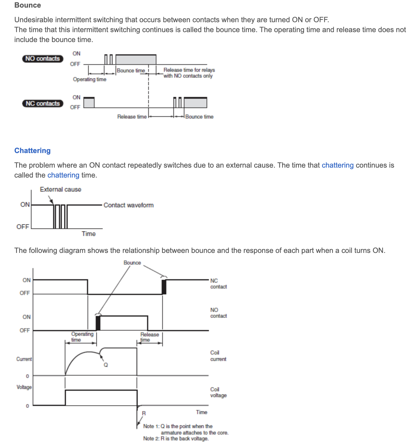

Replied by Aciera on topic Random arc signal lost
Ah, I think Operate and Release time are referring to the time required for the magnetic field to build up and deplete. So this is a delay between the change of the electrical signal to the coil and the mechanical movement of the contact.
Contact bounce happens when the contacts actually make contact or separate.
Anyway, my point is that these are two different things that should be kept in mind. It's not a question which of the two is right and which is wrong.
Anybody CAN be affected by either one or both.
[edit]
In my oppinion EVERY signal coming from a mechanical contact should be debounced before its used in logic circuitry because ALL mechanical contacts have bounce.
Contact wetting CAN become an issue depending on the environment that the relay is in, but if you happen to be affected by it its a total pain in the neck. So to follow the minimal current guidelines can save you a LOT of trouble.
Just my 2 cents.

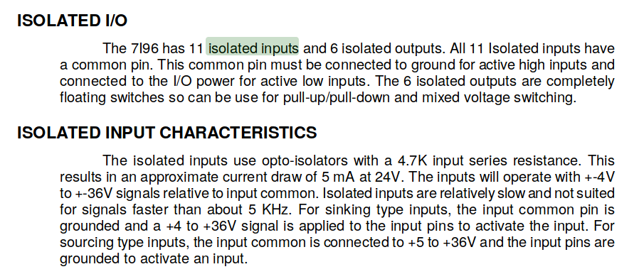

I thought 7i96's used Pull up resistors. In that diagram, I believe the 4.7k resistor is a pull down resistor, which takes me back to some of my confusion in the beginning of this thread.
Either way, early on you said you used a 1k ohm resistor from the input to the field power ground (which matches your diagram above). Assuming the board resistor actually does match what you drew, that would give you 824.56 ohms, and assuming a 24 volt system, you've presumably only been pulling 29mA this whole time (71mA below the recommended min value).
Replied by snowgoer540 on topic Random arc signal lost
So here is the circuit diagram. You can see that the 7i96 is unaffected. It still draws its 5 mA and the 3 x 270 ohm resistors take 267 mA
So this becomes my weekend project. To bring my existing circuit in line with the Jury's recommendations.

08 Sep 2020 21:10 #181321
It has nothing to do with the internal pull ups. Its the internal resistance of the circuit quoted by Mesa that matters. The 4.7k resistor drawn is actually the internal resistance of the 7i96, not a discrete component.
The 7i76 has a different internal resistance but the same values will apply due to the 10 x rule. I'm not really concerned about what I've done in the past, It what I do in the future for continual improvement that counts.
Replied by rodw on topic Random arc signal lost

08 Sep 2020 23:58 #181340
by phillc54
Replied by phillc54 on topic Random arc signal lost
Yes, as described in this extract from OmronAh, I think Operate and Release time are referring to the time required for the magnetic field to build up and deplete. So this is a delay between the change of the electrical signal to the coil and the mechanical movement of the contact.
