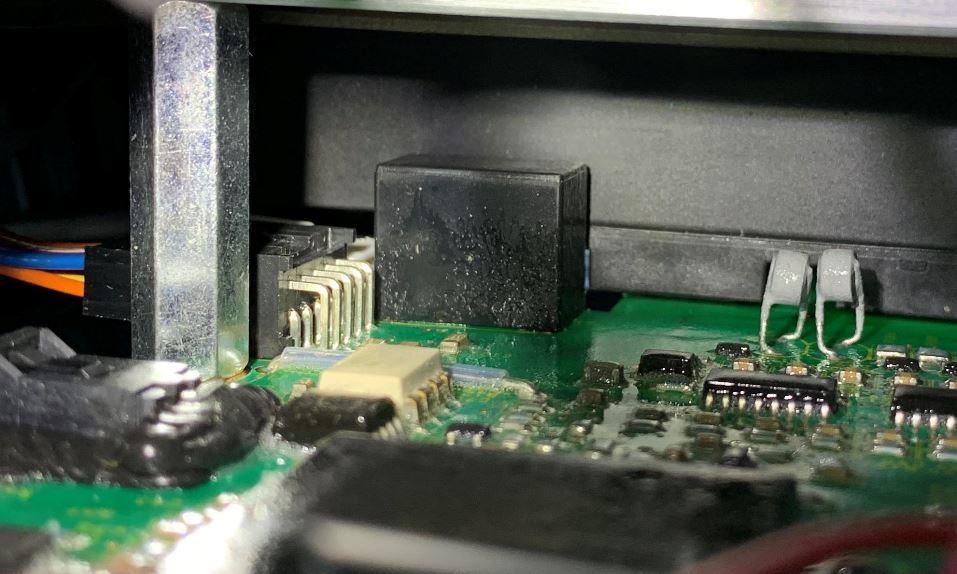

06 Sep 2020 00:20 - 03 Mar 2021 00:56 #180876 by snowgoer540
Replied by snowgoer540 on topic Random arc signal lost
As promised, I took the Hypertherm apart to see if there is any sort of hardware debounce.

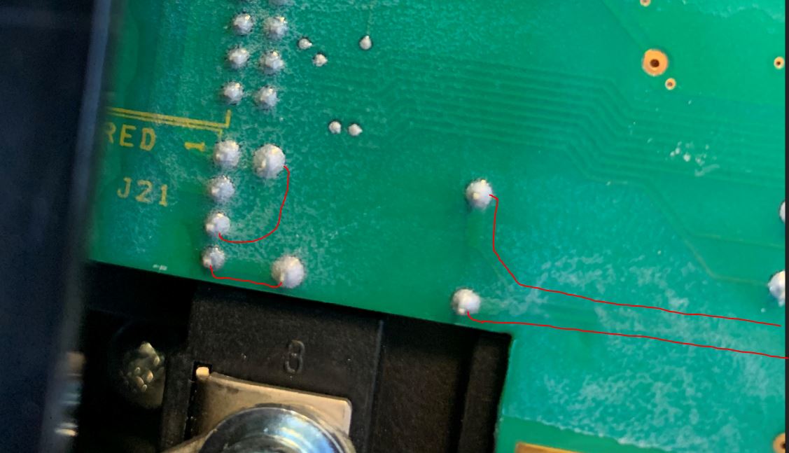

Dry Contact Relay:
Circuit (traces marked in red to make it easier to see due to the board coating):
The traces on the left hand side go directly to a connection for a set of wires that go to the CPC port. There is no hardware debounce (RC style or otherwise).
At any rate, just wanted to confirm that the it wasn't "dry contact relay" with some hardware bounce filtering they failed to mention.
Also it took far longer than I care to admit with a mirror and a flashlight to get the part number from the relay. The specs for the relay (TE T77S1D10-24) did mention a min. recommended contact load of 100mA at 5VDC. Further investigation showed that manufactures recommend that spec for contact wetting to break through oxide layers and "clean the contacts" to keep the resistance as low as possible. Several sites said that when contacts fail due to this condition, they usually just plain don't work. At any rate, I think Rod and I are describing two different problems, and their solutions.
Last edit: 03 Mar 2021 00:56 by snowgoer540.

06 Sep 2020 01:32 #180880 by rodw
Replied by rodw on topic Random arc signal lost
OK, so that confirms that your Hypertherm plasma cutter is susceptible to oxide build up just the same as I observed and discussed earlier in this thread. I did see a post where Jim Colt said that Hyperthemr have used the same relay on all their machines for many years.
so from ohms law, a 5 volt circuit requires an impedance of 20 Ohms to achieve minimum current draw.
So the question is, what is the minimum current on a 24 volt circuit? (R = I/R)
So if I take I = V/R, for 24 volts, I get I = 24/20 = 1.2 amps. I don't know if that is right or not so I'll go back to my electronics advisory for a suggested impedance value.
I think this is almost correct. From my experience I would say "Eventually, possibly after a period of intermittent operation, they just plain don't work" The oxide takes time to build up before the failures occur so for a while before it fails totally its intermittent.
This is bad advice as it ignores Ohm's law. and the manufacturer's own recommendation There needs to be enough resistance to achieve the minimum current recommendation. Cleaning the contacts may apply if the contacts are turning on a 3 phase 30 HP motor but that is not an under current situation!
I think you still have a problem. While debouncing may have solved the issue for now, you have not addressed the underlying cause (oxidisation). I expect the fault will come back..
Anyway, I'll see what my analog experts advise.
06 Sep 2020 01:43 #180882 by snowgoer540
I’d think the same 100mA would apply, the reading I did suggested they pick a standard amperage value. So for 24V I’d need a 240ohm resistor... somewhere... to make the same 100mA draw. I do know my board is rated at 800mA max (7i76). I planned to measure the current amperage draw tomorrow out of curiosity.
I’m sure oxide does form, just not sure how much of an issue it is. If Jim Colt has advised these same relays have been used for years and years, again, you’d think the manual would bring it up so they didn’t see as many field issues.
