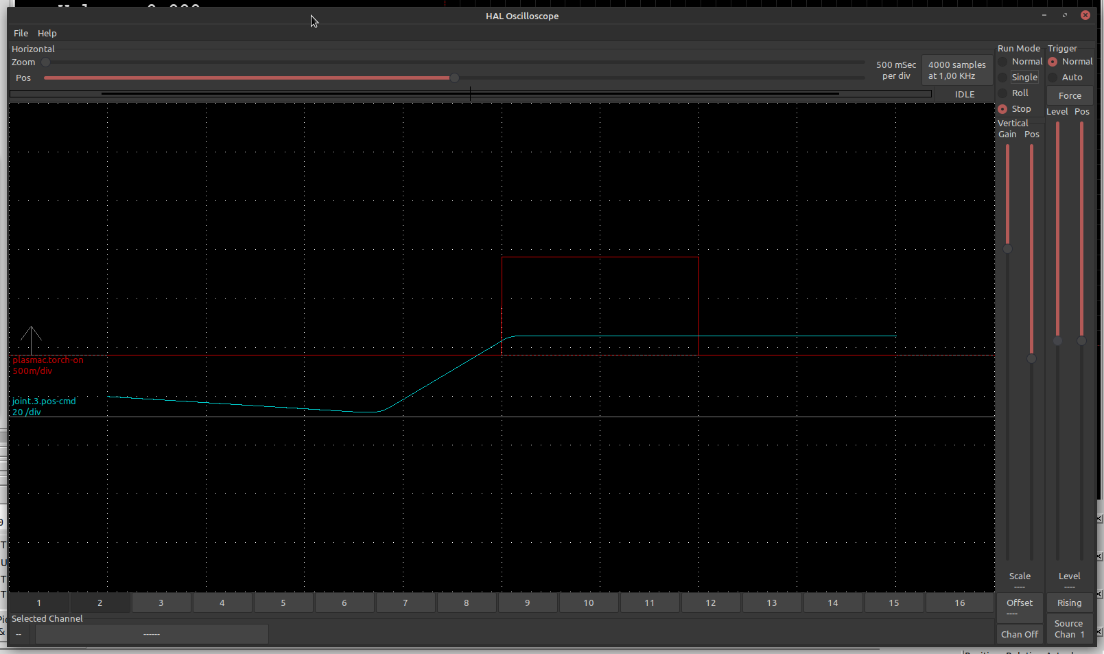

I think i found another reason for lost arc during piercing when using plasma sources that fire instantly when they receive "torch on" signal:
It seems the torch on signal is given before the torch reaches the pierce height and stops, did it over 40 times today and as far as i can tell it is firing while moving up.
Just did some sim tests, It does trigger before reaching setpoint ! :blink:
As usual latest master.
The following user(s) said Thank You: Mud, snowgoer540
14 Oct 2020 22:14 - 14 Oct 2020 22:17 #186132 by phillc54
Replied by phillc54 on topic Some thoughts and some findings using PlasmaC
Yes, it would be possible that the last servo thread of Z motion hasn't completed when the torch is activated. A relatively easy fix if it is an issue.
EDIT: that would equate to about 0.016mm per 1000mm/min
Last edit: 14 Oct 2020 22:17 by phillc54.
14 Oct 2020 22:40 - 14 Oct 2020 22:43 #186136 by PCW
If you look at the time/division, Torch-on happens about 60 ms before the motion is complete
(so close to 60 servo periods). This is about 2.5 mm before the endpoint.
Last edit: 14 Oct 2020 22:43 by PCW.
