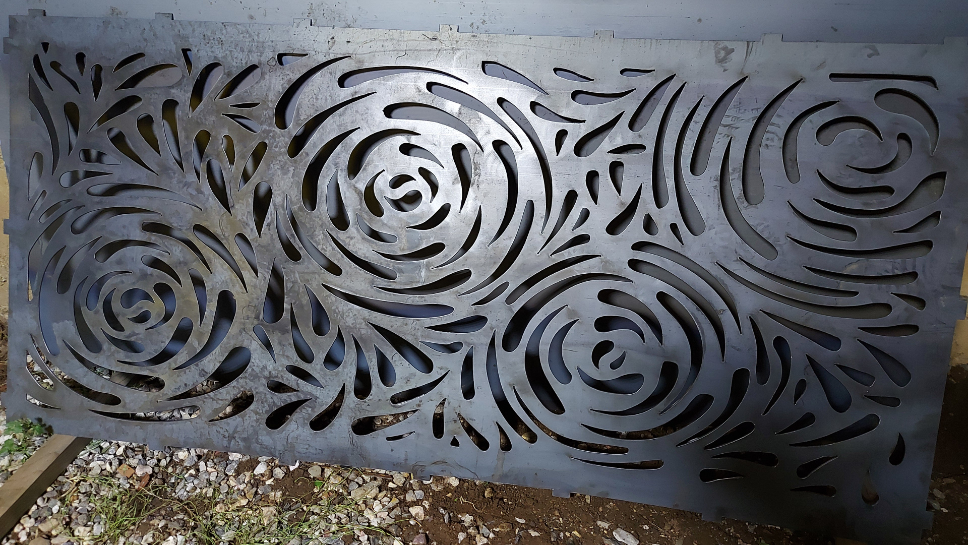

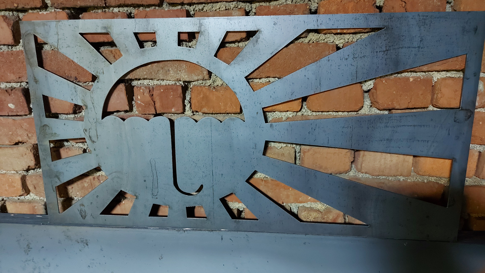

Replied by tommylight on topic Some thoughts and some findings using PlasmaC
Had a strange issue today that i could not reproduce any more, namely the probe height/speed where ignored for over 50 probes and after stopping with ESC and resuming with "run from here" it did work properly for some 300 more probes.
Beside that, it was a pleasure working and watching the machine work, no wonder my eyes are hurting !
More cutting tomorrow hunting gremlins ...
To make this topic happier, here are some of the parts cut today:
The following user(s) said Thank You: phillc54, Clive S, rodw
