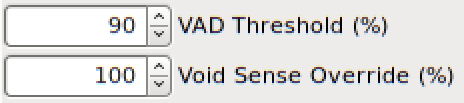

19 Oct 2020 02:39 #186542
by phillc54
Replied by phillc54 on topic Some thoughts and some findings using PlasmaC
How about this Tom?
Run Panel:
Config Panel:
Monitor Panel:
Regarding VAD, are you using F#<_hal[plasmac.cut-feed-rate]> as the feed rate or Fnnnn.
For void sensing I have had good results with 100%. I guess there may be some differences between machines. There is an as yet undocumented hal parameter that you could try. It is named (for historical reasons) plasmac.kerf-errors-max. It is the number of consecutive times the threshold is exceeded for the lock to be valid. The default value is 2. It may be better for you to increase that to 3 or maybe even more.
Run Panel:
Config Panel:
Monitor Panel:

19 Oct 2020 12:12 #186571
Replied by tommylight on topic Some thoughts and some findings using PlasmaC
Much better and more uniform, thank you.
And yes i am using #F as i am doing all the testing from the wizard.
I'll give that a try whenever i get the chance and report back.
Thank you.

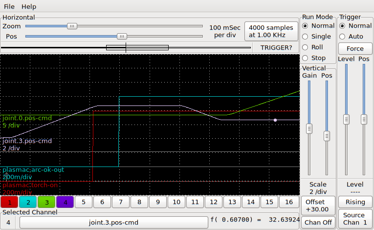

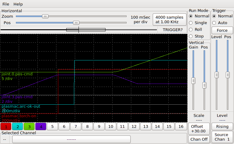

21 Oct 2020 03:13 - 21 Oct 2020 03:15 #186787
by phillc54
Last edit: 21 Oct 2020 03:15 by phillc54.
The following user(s) said Thank You: tommylight, pinder

21 Oct 2020 12:32 #186809
Looks much better, when can i give it a run?
Thank you.

21 Oct 2020 15:53 #186816
by snowgoer540
That's a question only you can answer; she's live now!
Seems to work well from what I saw. Seems like it solved a lot of the joint following issues we were seeing as well.
I didn't get to do a ton of testing on it, but preliminary results were very encouraging.
Replied by snowgoer540 on topic Some thoughts and some findings using PlasmaC
Thank you.
