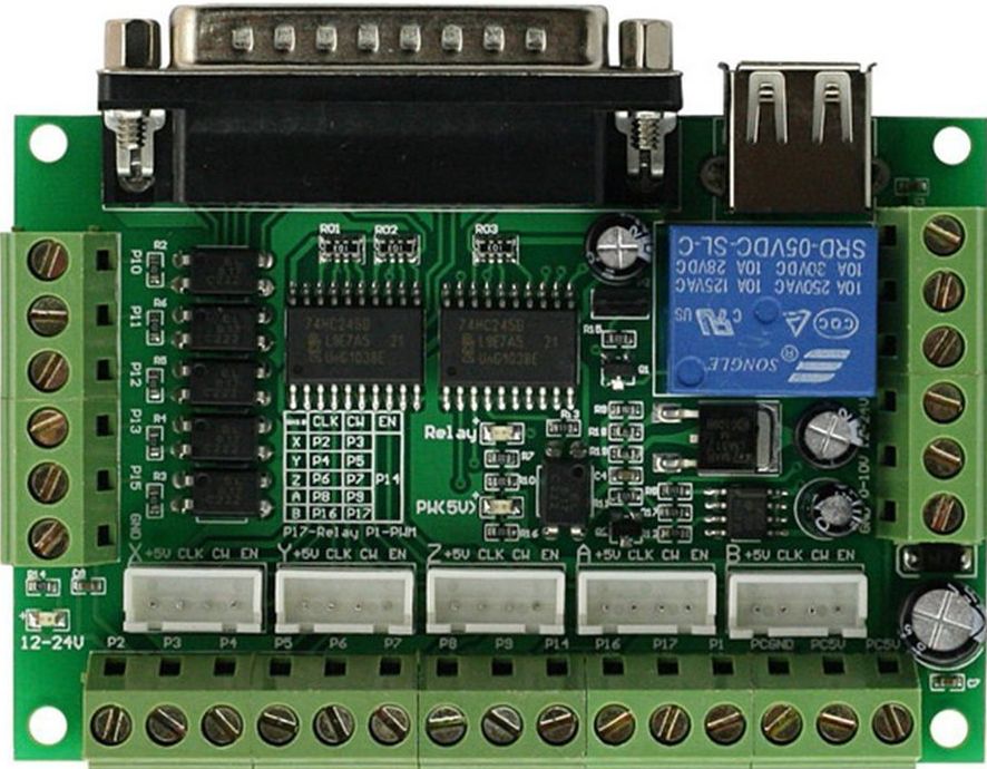

Hi guys,
i build a CNC base machine with one Mach3 (5 axis) BOB (chinese one).
With this BOB i don't have much inputs pins and outputs pin.
So i have to use some pins multiple times.
I do this with the home switchs and this works fine.
Now i want to configure my plasmac and use some pins also multiple times.
But when i am starting the machine i get the error
"Pin "xxxx" was already linked to signal "xxxx"
In this case i can't share any pins? Do i need 2 bob's?
Or is there another possibility to realize this?
thanks so far,
regards
Giuseppe

27 Jan 2021 14:31 - 27 Jan 2021 14:32 #196766
by Giuseppe
Replied by Giuseppe on topic Configure PlasmaC with only one BOB
i need 2 pins for home. because i am using autosquare.
What about ohmic enable? The manual says you need it if you use ohmic.
As i need 2 pins for home i have to use one of this pins for ohmic too.
Can i use the home pin for ohmic an home?

- Posts: 19899
27 Jan 2021 23:28 #196848
Replied by andypugh on topic Configure PlasmaC with only one BOB
One P-Port input pin, which becomes an output in the HAL layer, can drive several inputs in HAL.
But HAL inputs can only be driven by one output pin. Otherwise the system has no way to know which value to use.
You can work around this in HAL by using logic such as and2, or2. Ot you can compine several inputs into a single (selectable by more logic) output by using the mux components.
(for bit-type signals you have to use mux_generic )
- Posts: 12161
- Thank you received: 4151
28 Jan 2021 03:01 #196883
Extending on this if you were to use mux-generic to repurpose pins, you could probably could use the joint.N.homed pin to deterime if say the float switch was a home switch or a float switch... wire the switches in series as NC to one input and in hal "split" the value to float switch in and home switch for joint N using mux-generic. If joint.N.homed is false, its a home switch...
Replied by rodw on topic Configure PlasmaC with only one BOB

28 Jan 2021 09:46 - 28 Jan 2021 09:49 #196914
by Giuseppe
I'am a little confused. I will append my hal and ini. Of the plasmamachine.
This was generated from the basemachine that works fine.
But when i start the plasma machine i get the message
"Pin parport.0.pin-11-in was already linked to signal din-00"
Maybe it is easier to buy a secound BOB?
This is the BOB

HOME_FINAL_VEL = 5This is the BOB
