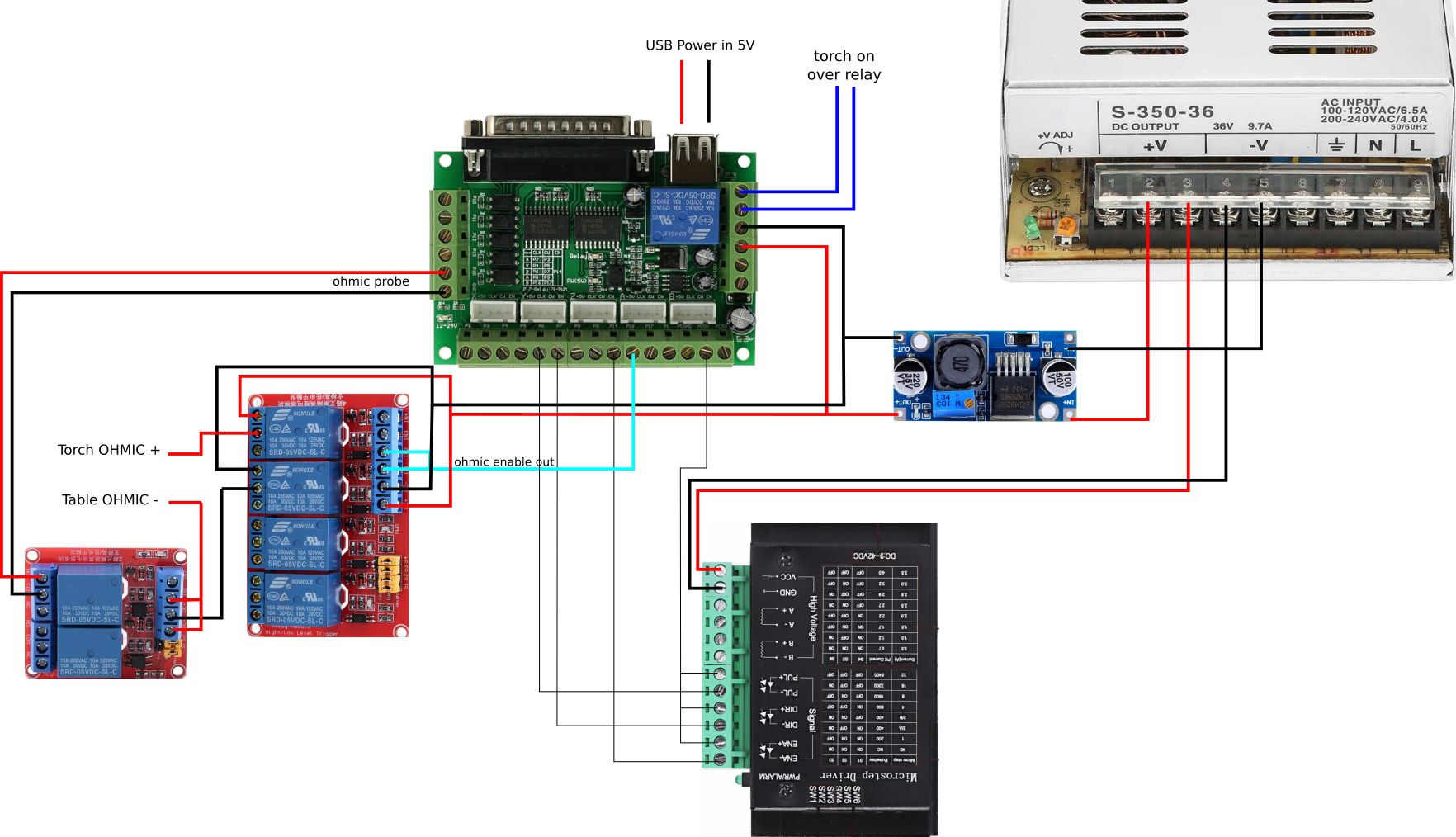

04 Feb 2021 15:23 - 04 Feb 2021 15:25 #197655
by Giuseppe
Replied by Giuseppe on topic Configure PlasmaC with only one BOB
Thanks for all comments.
The first Problem with the error massage is solved. I think so. I will check it later when my THC is working.
Now i am planing how to wire the THC with the relay board.
I have here a my own shematic
Can anyone tells me if this will working so?
After the DCDC converter the voltage is 24V
Last edit: 04 Feb 2021 15:25 by Giuseppe.

04 Feb 2021 16:50 #197661
by Clive S
Replied by Clive S on topic Configure PlasmaC with only one BOB
You will also need 5v for the BOB as well
- Giuseppe
- Posts: 81
- Thank you received: 9
04 Feb 2021 17:21 #197663
by Giuseppe
Yes i know. I have 5v over USB i don't draw it in the diagram. The BOB works.
I need to know if the Relay Board will work so?

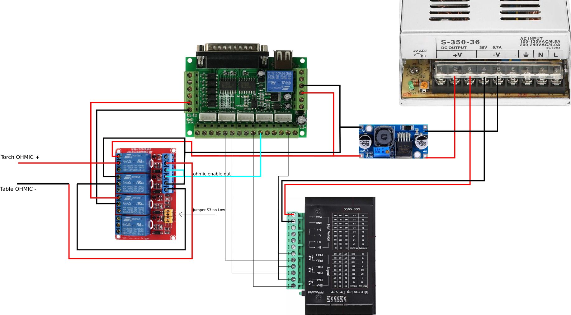

05 Feb 2021 06:33 - 05 Feb 2021 06:38 #197707
by Giuseppe
