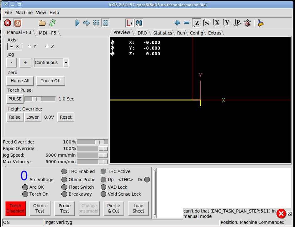

01 Mar 2021 10:09 #200533
by tecno
Ahh, missed that one. But still no go.
Selecting StepMode this happens
Replied by tecno on topic WANTED MPG HELP with xhc-whb04b-6
You seem to be missing joint.2.jog-scale:
net pendant:jog-scale-out pendant:jog_enable_mux.out => pendant:jog_mult2.in0 net pendant:scale_div_1000 pendant:jog_mult2.out => axis.x.jog-scale axis.y.jog-scale axis.z.jog-scale net pendant:scale_div_1000 => joint.0.jog-scale joint.1.jog-scale
