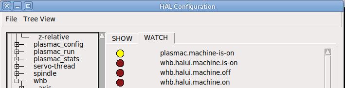

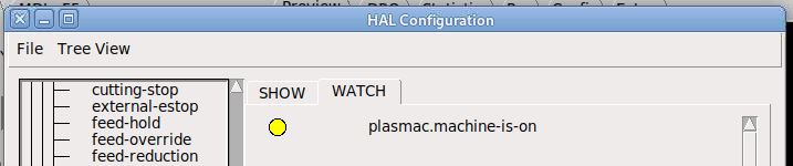

Done some tests and found following that I can not solve.
Below snippet from plasmac.tcl
So far all is well
Below snippet from pendant hal
So, I get no error message starting LCNC. What is wrong here?
if {[hal list sig machine-is-on] != {}} {
net machine-is-on => plasmac.machine-is-on
} else {
net machine-is-on halui.machine.is-on => plasmac.machine-is-on
}So far all is well
# On/Off signals
net machine.is-on whb.halui.machine.is-onSo, I get no error message starting LCNC. What is wrong here?

03 Mar 2021 11:14 #200886
by phillc54
Replied by phillc54 on topic Want to test MPG
Try changing the pendant.hal line to:
net machine-is-on whb.halui.machine.is-onPlease Log in or Create an account to join the conversation.

03 Mar 2021 11:21 #200889
by tecno
Replied by tecno on topic Want to test MPG
YOU ARE THE MAN !! I owe you a pint or two Phil.
At last I have axis moving via the wheel.
Cheers from a happy camper.
