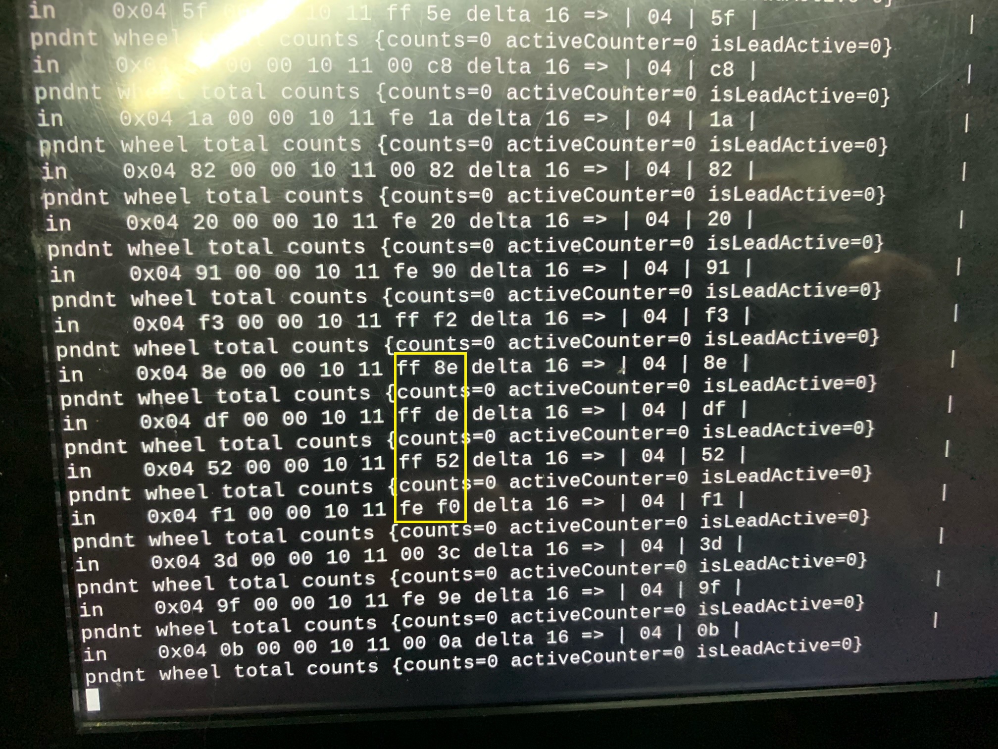

It does not work straight out. I have modified line by line until I get LCNC running.
Most commented out lines are 'buttons' and MDI so it should be working without those functions, but obviously not.

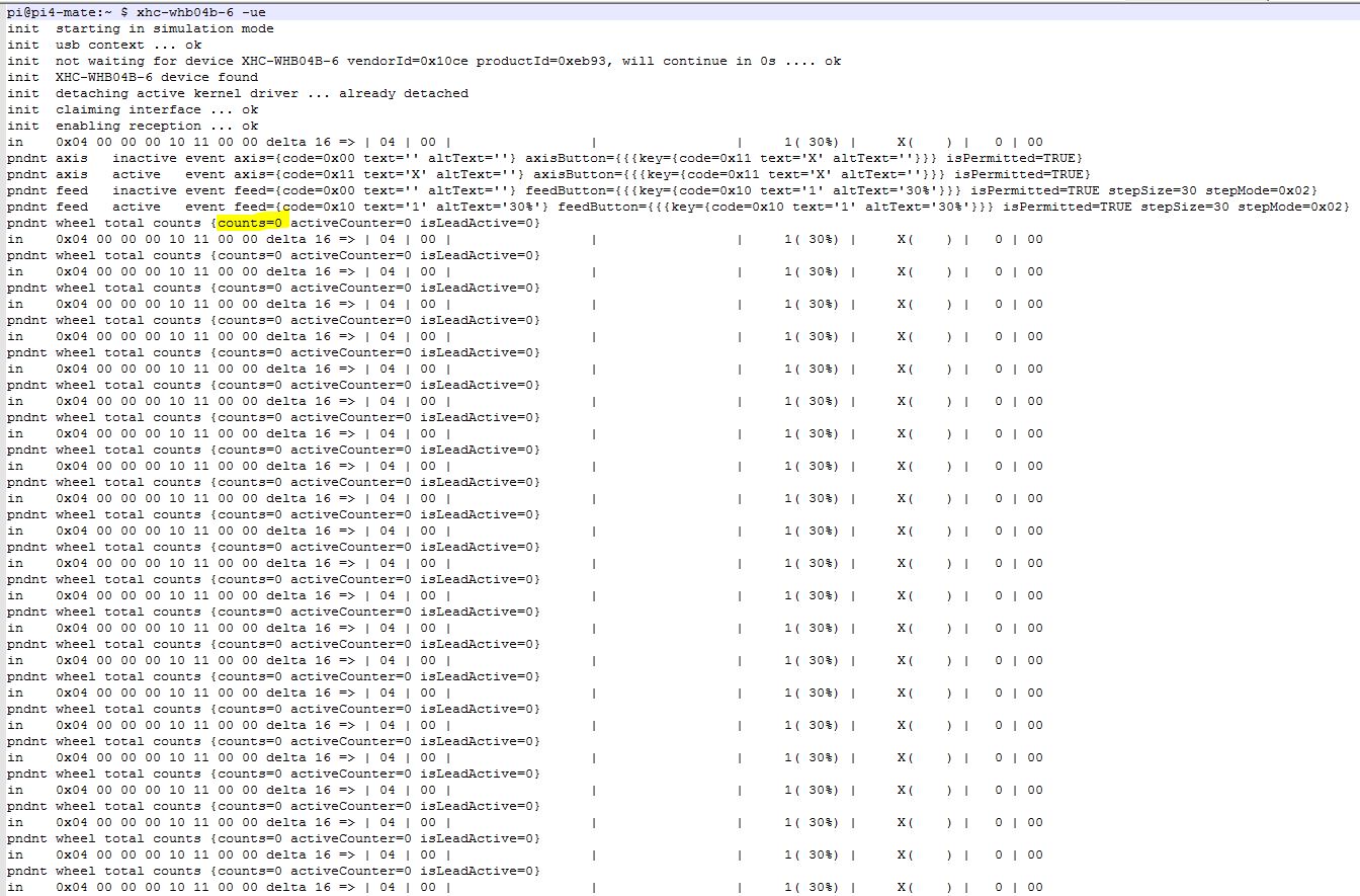

Can somebody with a WHB04-6 with RF/WiFi run tis test and show results
xhc-whb04b-6 -ue
xhc-whb04b-6 -ue

02 Mar 2021 21:20 #200829
by alkabal
Replied by alkabal on topic WANTED MPG HELP with xhc-whb04b-6
We can suspect your wheel is not managed exactly like the rf version.

02 Mar 2021 21:29 #200833
by tecno
Replied by tecno on topic WANTED MPG HELP with xhc-whb04b-6
the numbers you refer to are counting. But not the Yellow in my picture.
So in that case my wheel is OK

03 Mar 2021 00:57 - 03 Mar 2021 01:01 #200862
by alkabal
Have you try to push continuous or step button before moving the wheel ?
In your picture i see only 00 00 for the wheel value
