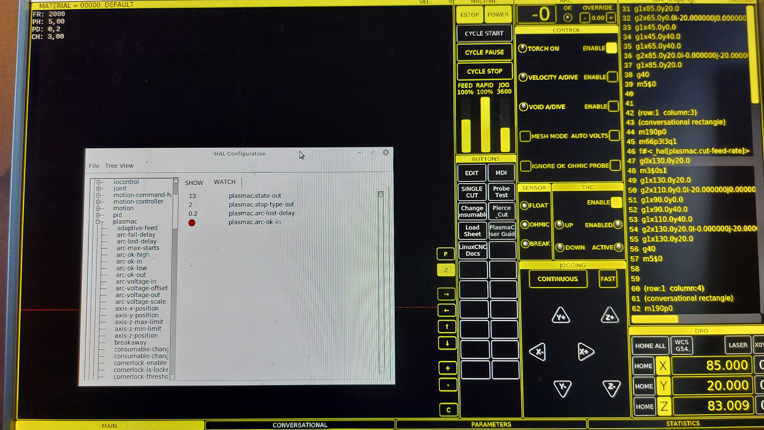

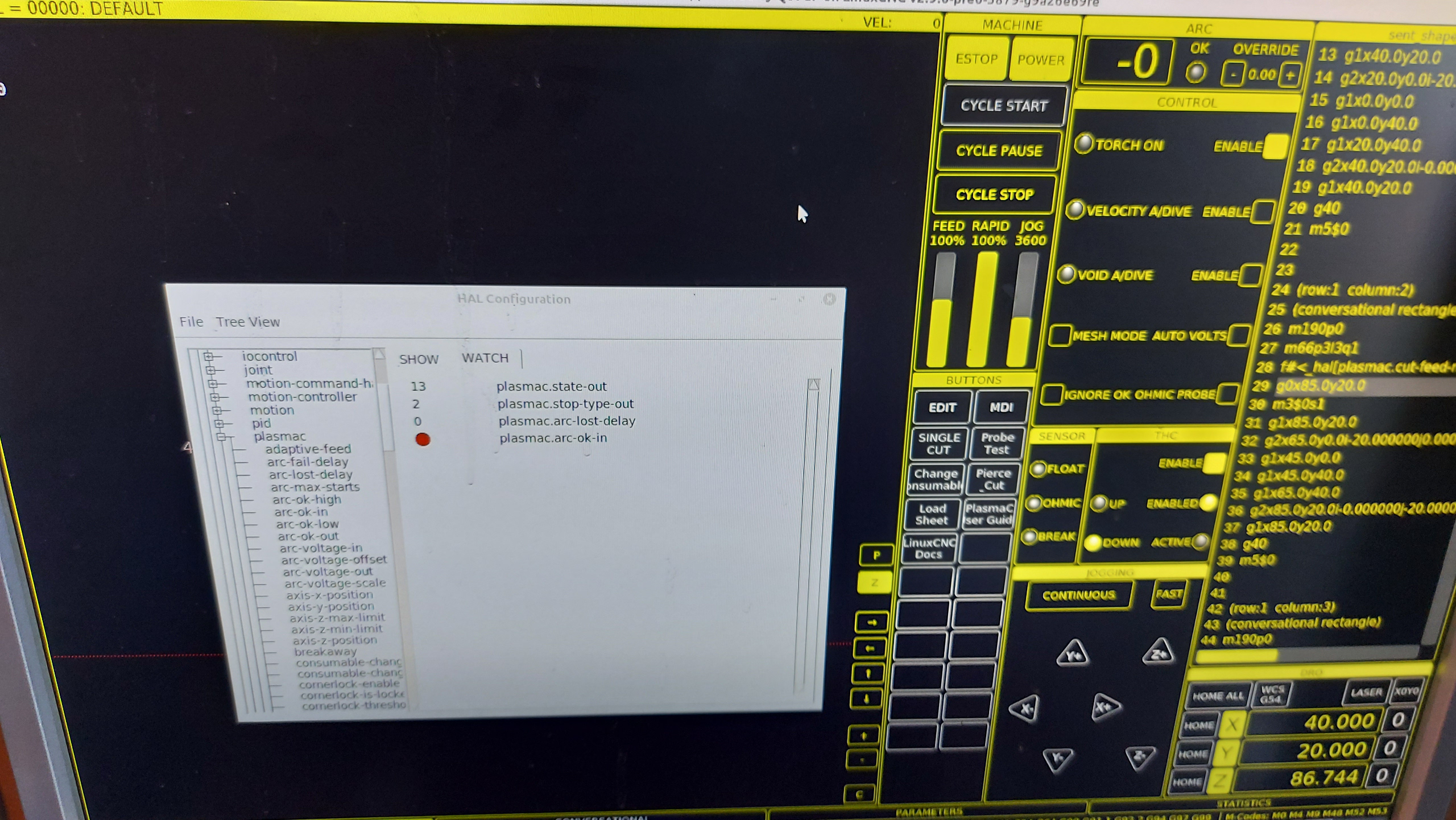

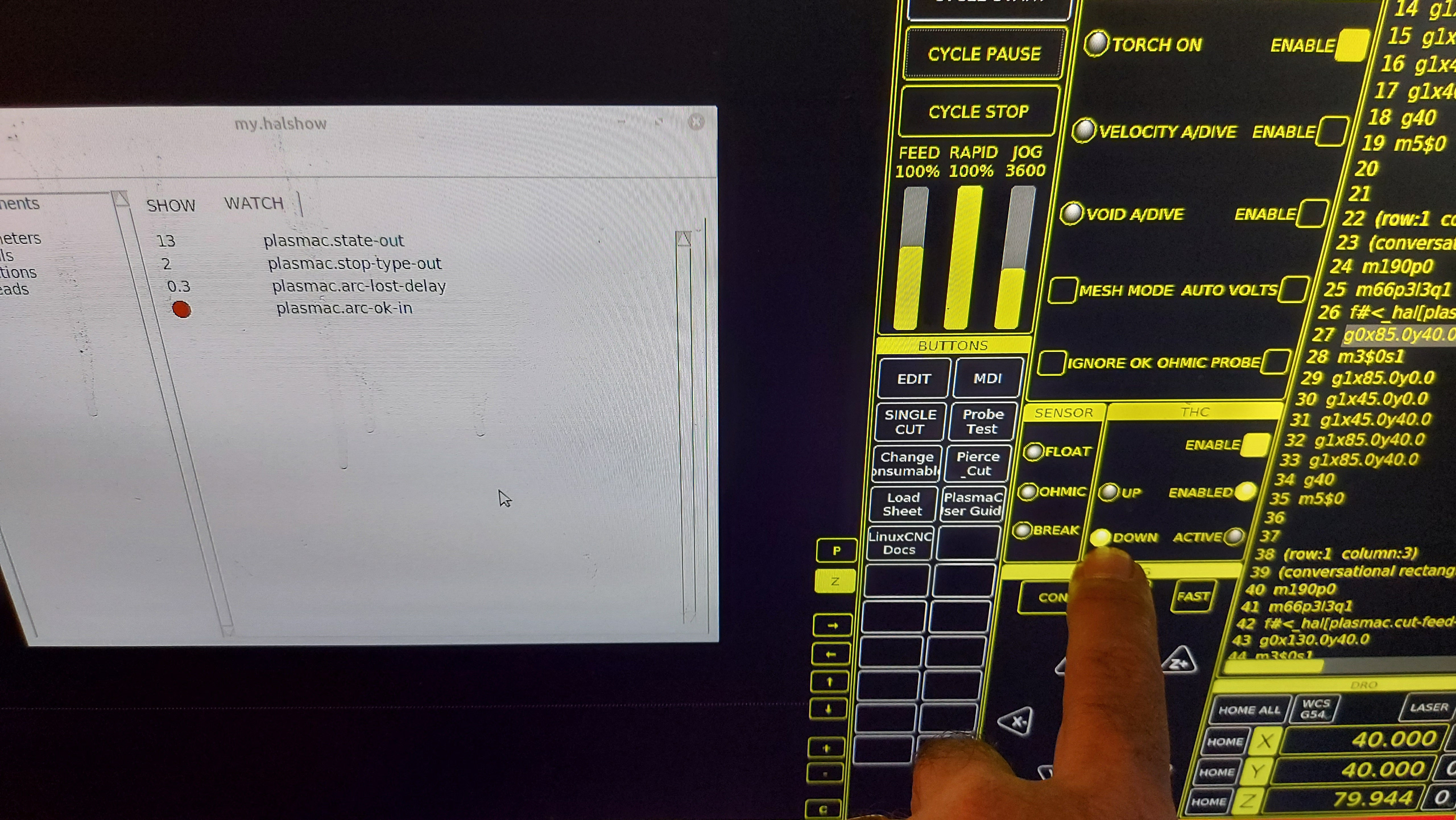

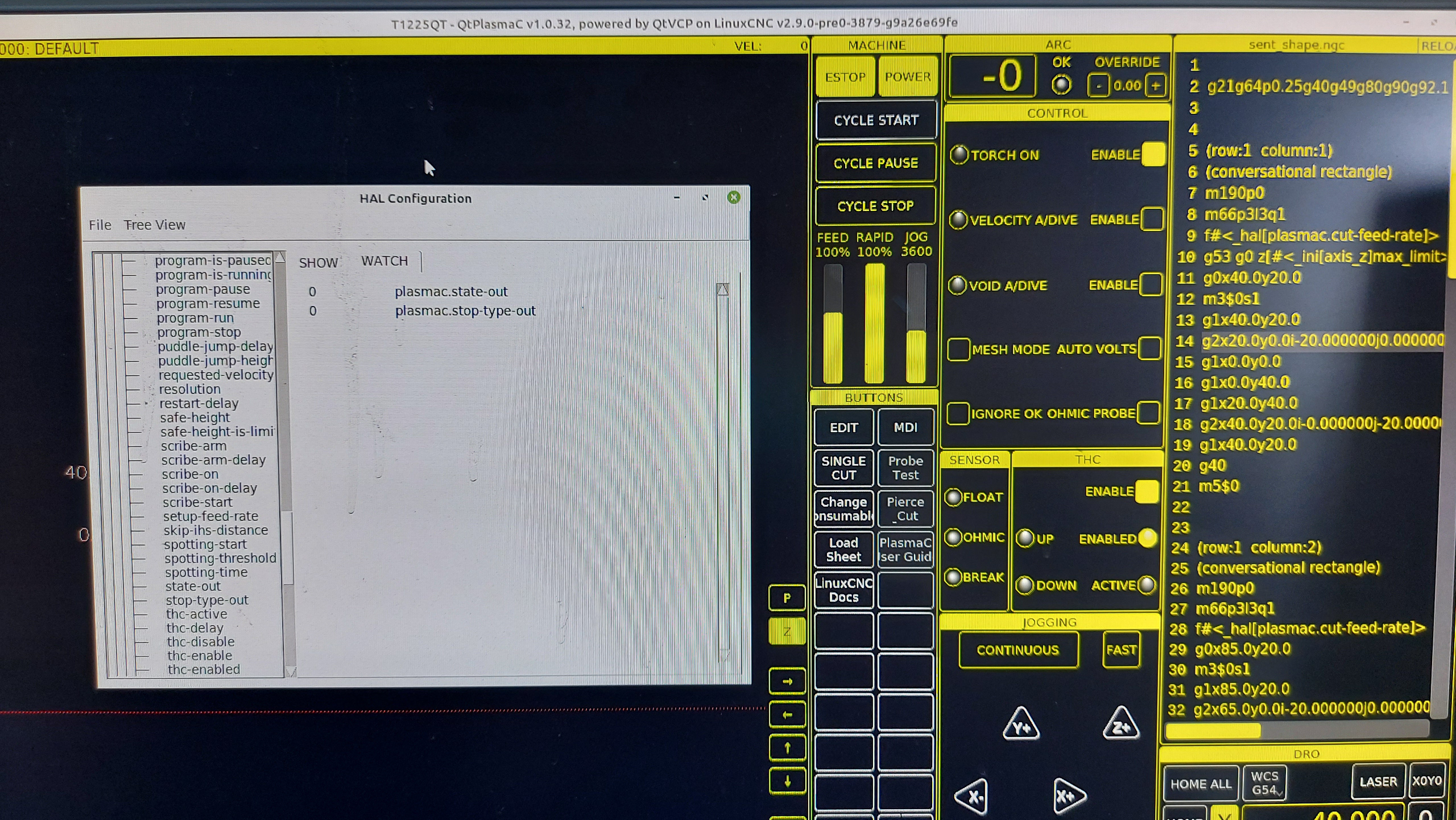

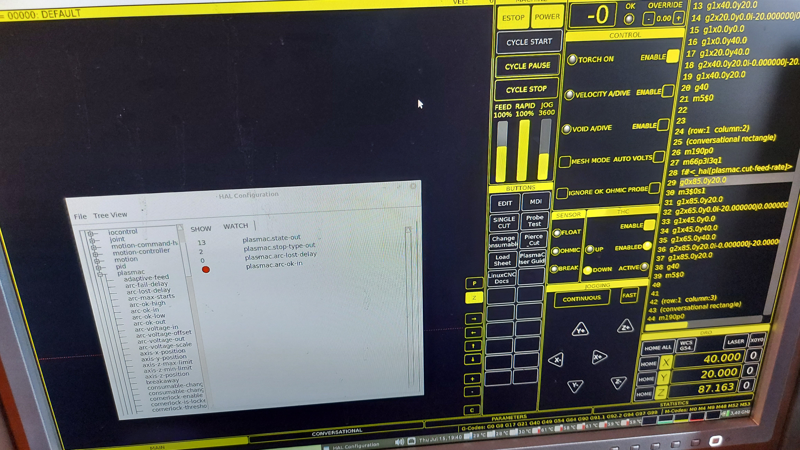

16 Jul 2021 00:04 #214953
Replied by tommylight on topic QtPlasmaC release.
Here it is, sorry for the delay, reasons below ...
I think i do have smaller parts of that design, will check when i get to one of my PC's. Or what dimensions would you need as i can do it in under 5 minutes ?
Thanks Tommy, actually the one you posted is a perfect size, if you had a dxf of that I could probably split it up and index a sheet and move it around.
- Posts: 21986
- Thank you received: 7487
16 Jul 2021 00:12 #214956
Happened 5 times today in about an hour, cut a piece or two then stop and wait and wait ....
Proof incoming:
The first two shots are with the latest Stretch build, other 3 are after updating to build 4140 i think from the Buster repo:
-yeah no, editor not working so cannot embed pictures...
There is a bonus picture, went to see how one of my machines is doing and this is what i was greeted with on the owners truck !
Sometimes the Down LED gets stuck on, sometimes not, happens on both versions...
Went back to PlasmaC, it worked for over an hour without issues.
Now i can say it out loud, i hate anything QT, just to much cr@p under the pretty looks.
Proof incoming:

16 Jul 2021 00:42 #214960
by phillc54
Replied by phillc54 on topic QtPlasmaC release.
OK...
state-out = 13 indicates the Z is moving to safe height.
stop-type = 2 indicates it is waiting for a M3 to start the next cut.
All the pics show that the current line is a move to Xnn/Ynn but if you look at the DRO X/Y they show the current position as being the last X/Y position from the previous cut.
This indicates that the component thinks that safe height has not been reached and it is still setting feed-hold on (plasmac.feed-hold). There should be no differences in QtPlasmaC and PlasmaC as they both use the same component and all this is controlled from the component. Maybe if I try one less decimal in the float comparison it may help. I'll play around a bit later today.
I "think" the Down LED may just be a timing issue of what it was doing last when the previous cut stopped and it got hung up...
