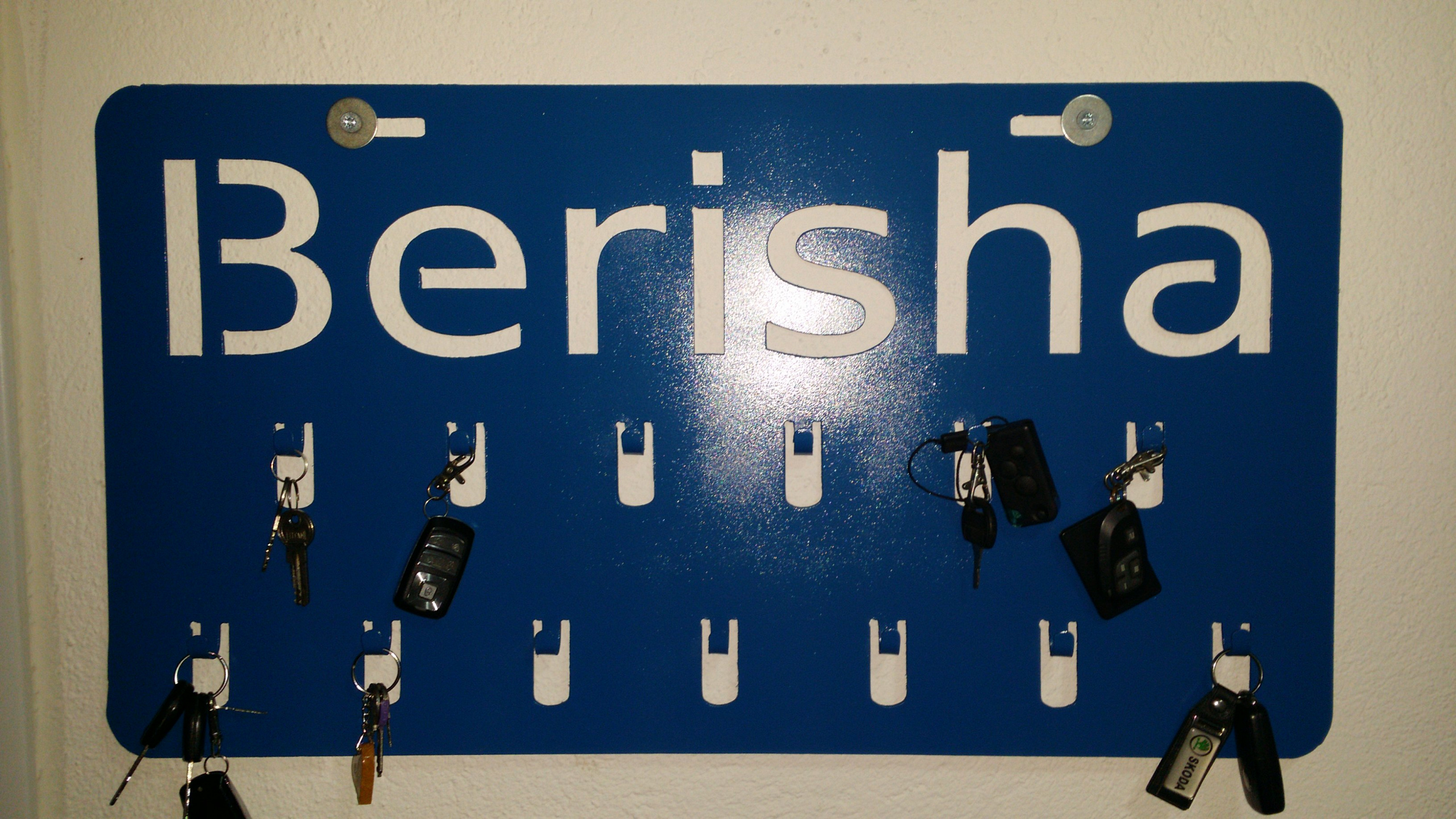

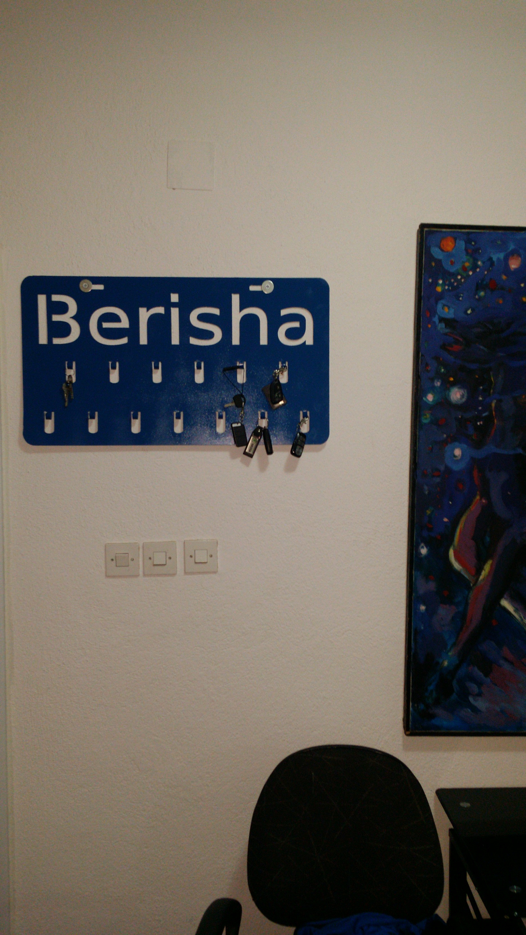

Maybe tomorrow i can get some quality time with the big machine and do an update, have to cut some key hangers, so here it is in one of the versions, that be my family name and it is hanging in the hall way for over two years now, also the SVG if anyone want to edit and cut this:
