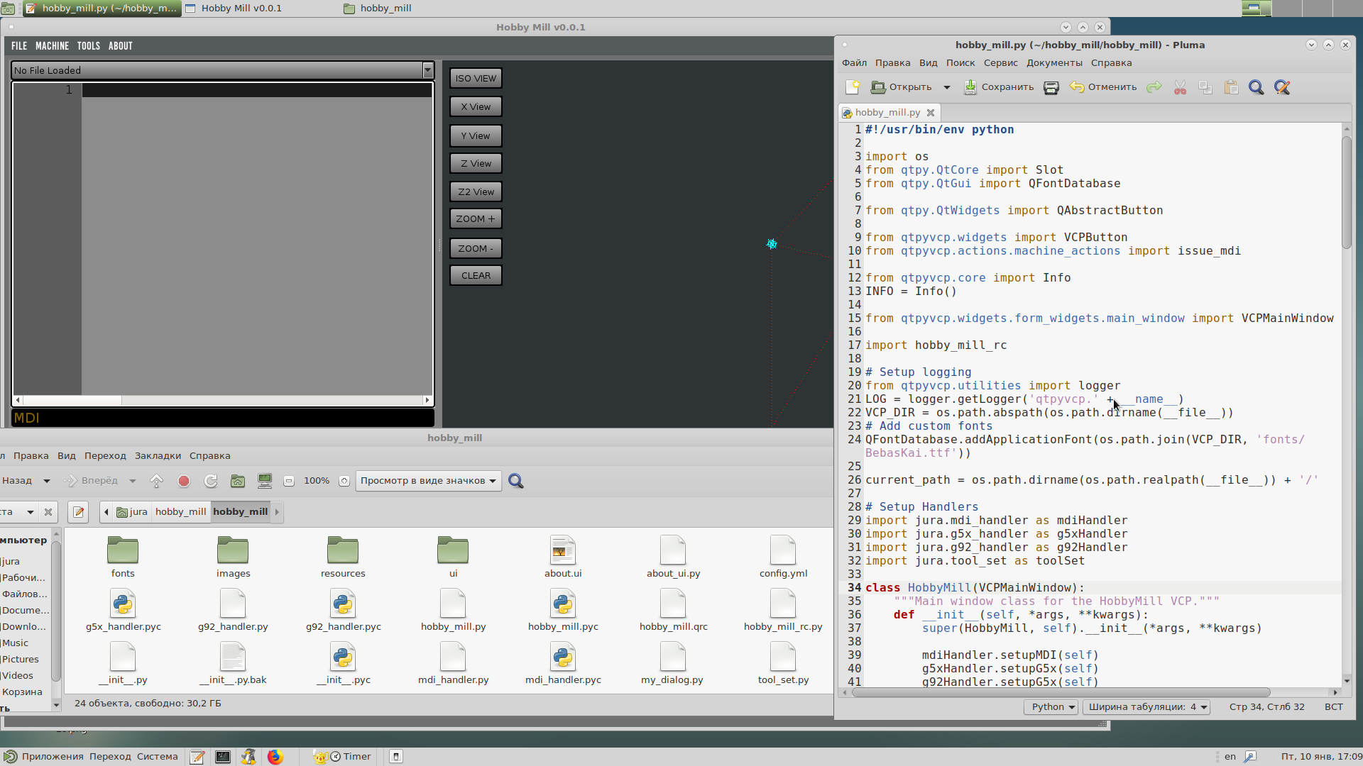

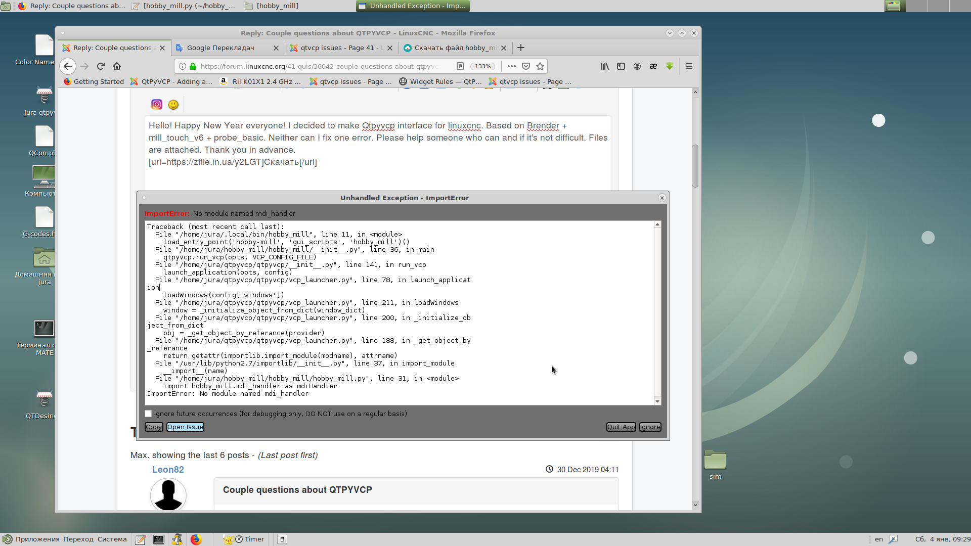

Hello! Happy New Year everyone! I decided to make Qtpyvcp interface for linuxcnc. Based on Brender + mill_touch_v6 + probe_basic. Neither can I fix one error. Please help someone who can and if it's not difficult. Files are attached. Thank you in advance. In the attached file, we’ll remove the hobby_mill error L, two L does not solve the problem.

It's not finding the mdi handler.
You may have to tell it where to import it from.
I had to do it to get an image to work in the background after qcompile.

Download the file, unzip it to your home directory and install according to the attached instructions. Run the simulator and you will see everything. Thanks for attention.

I will supplement my question. In the home directory there are two identical VCP jura and Hobby Mill. Hobby Mill works when I prescribe import jura.mdi_handler as mdiHandler if import hobby_mill.mdi_handler, no named module. For some reason, he sees from a neighboring directory. Can this be fixed somehow? Without a directory, jura does not work.
