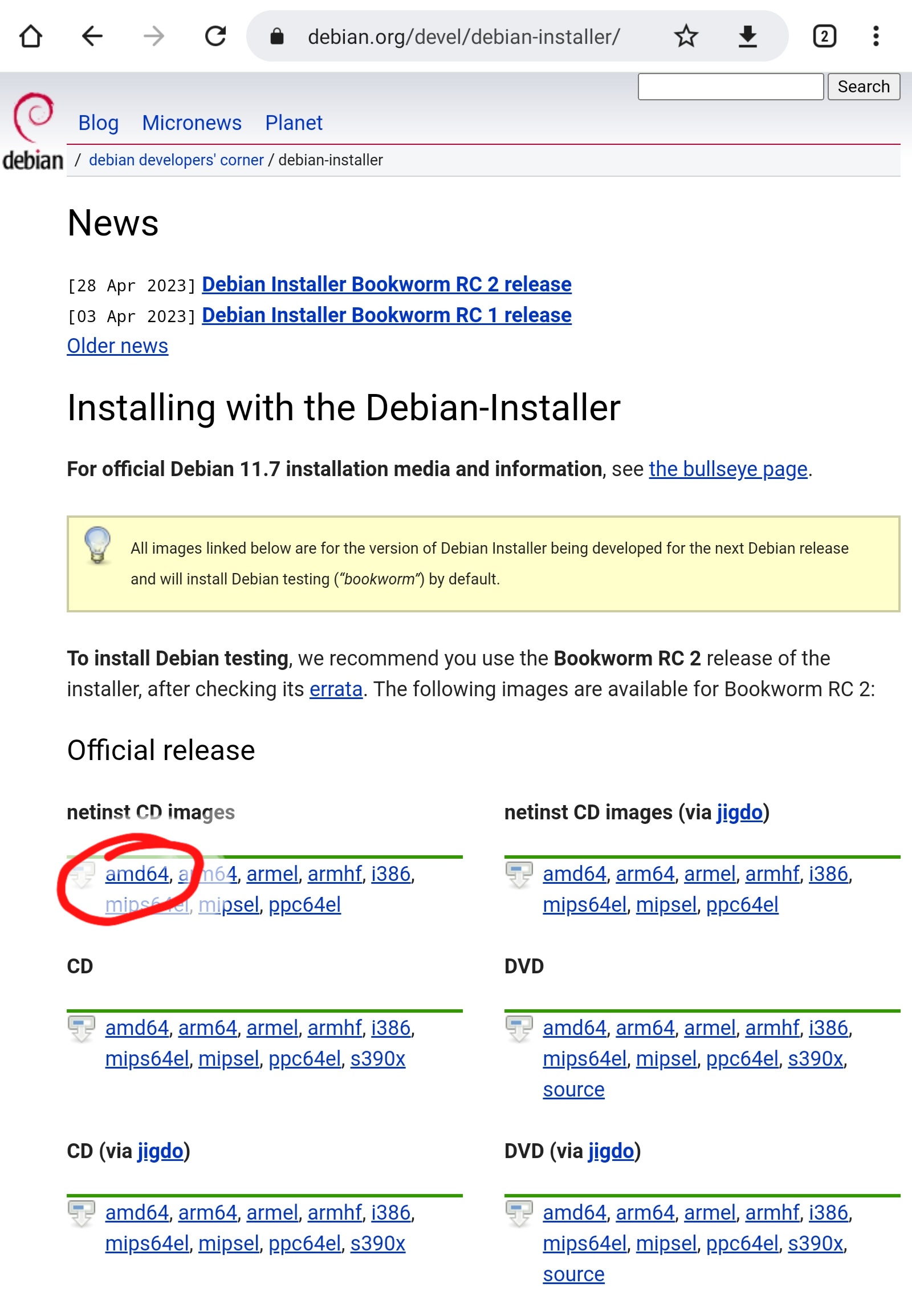

The only supported OS is DEBIAN 12.
If you follow the instructions in the link I providecan you will be good to go.

Yes I see that in the instructions. This post is for MX21 that's why I asked. One of the previous replies said everything was working but did not say which version they have working.
In any case I will give this a go. I could use a little help getting going.
I looked for Debian 12 and the page I found did not say Debian 12 or Bookworm anywhere. Which page on Debians website has 12 so I can try this out. Thank you.
