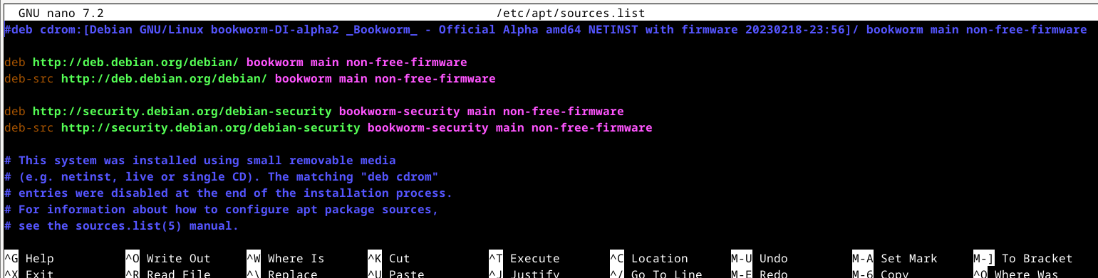

I can confirm that the new packages and instructions work on a fresh install of Debian 12. The only thing that I noticed is that the "sudo apt --fix-broken install" step after the python3_probe_basic package install will fail if you haven't already started LinuxCNC and copied an existing config to your home directory which creates the /home/user/linuxcnc/configs/ folder. You could also create those folders manually. Re-running the command after creating the folders works. I will edit my first post to not confuse new readers.

I have noticed that the carousel images are not loading. Anything I should check?

confirmed, somewhere while fixing the sims folder issue the atc widget broke.. will get that found and fixed in the morning with some luck. thanks for pointing it out!I have noticed that the carousel images are not loading. Anything I should check?

I wonder if the resources aren’t being compiled so the ATC images are not able to be loaded.
