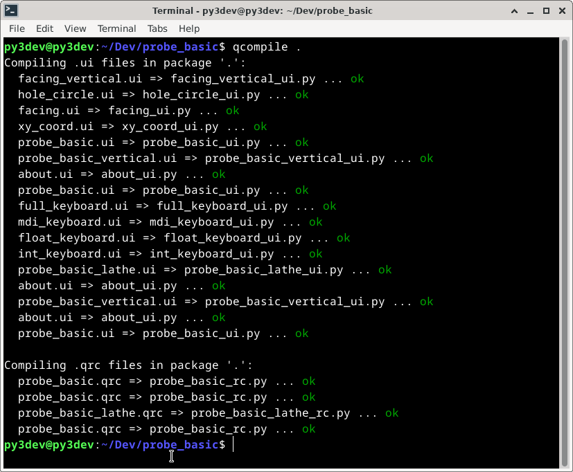

we did recently change to compiling before building to eliminate left over folders when uninstalled from compiling on the target system. it appears to be compiling correctly here, wonder if the build is not capturing the compiled resources.. good thinking, i will explore that avenue! PS.. your baby QtPyVCP is DOA at the moment and in desperate need of some Hazzy help :o.....

Hazzy,I wonder if the resources aren’t being compiled so the ATC images are not able to be loaded.
