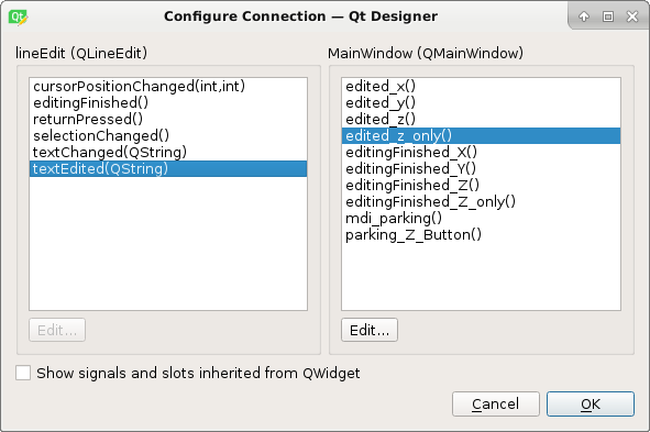

12 Jul 2018 16:00 #114086
Replied by cmorley on topic qtvcp issues
it would help to know what linux distribution you are using -
I'll assume debian stretch but there are only little differences.
When you have loaded your screen into designer add a plain button to the screen.
You could change the name of the button to something interesting like 'test_button'
There are two ways to edit connections - I will show the 'graphical' way
There is a button on the top for editing signals.
After pushing it, if you click-and-hold on the button it will show a arrow (looks like a ground signal from electrical schematic)
Slide this arrow to a part of the main window that does not have widgets on it.
A 'Configure Connections' dialog will pop up.
The list on the left are the available signals from the widget.
The list on the right is the available slots on the main window and you can add to it.
Pick a signal, say 'clicked()' - this makes the slots side available.
click 'edit' on the slots list.
A 'Slots/Signals of MainWindow' dialog will pop up.
On the slots list at the top there is a plus icon - click it.
you can now edit a new slot name.
Erase the default name 'slot()' and change it to say test_button()
press the ok button.
You'll be back to the 'Configure Connections' dialog.
now you can select your new slot in the slot list.
then press ok and save the file.
Now you must add the function to the handler file.
The function signature is 'def slotname(self):'
We will add some code to print the widget name.
So from our example:
in you handler file (if you copied it) there is a section named:
In fact it doesn't matter where you put the commands but by convention this is where to put it.
add the code and save it.
If all went well, after you run your screen now, when you push your new button it will print the button name in the terminal.
Chris M

17 Jul 2018 07:02 - 17 Jul 2018 07:03 #114367
by Ilya
Replied by Ilya on topic qtvcp issues
I was temporarily going back to using Axis, to adjust the angular axes.
Your tutorial on signals and slots helped me. Thank you!
I need three buttons for fixed moves: the First to move X and Y to zero. The second to move Z to"N". The third is to move X to" N", Y to" N "and Z to"N".
The sketch
I'm not happy with my implementation yet, but it's working. Maybe it could have been done in a more correct way
I took your header file as a basis - tester_handler.py
Thanks,
Ilya
* The text on the button "Парковка"[Parkovka] - translated as Parking
The sketch

self.PATH = paths.CONFIGPATH
self.IMAGE_PATH = paths.IMAGEDIR
self.STYLE = Styles(widgets, paths)
# Special Functions called from QTSCREEN
# at this point:
# the widgets are instantiated.
# the HAL pins are built but HAL is not set ready
def initialized__(self):
# Give notify library a reference to the statusbar
STATUS.forced_update()
# set custom theme
#self.STYLE.dark_style()
#self.STYLE.bright_style()
self.STYLE.gorelovskiy_style()
KEYBIND.add_call('Key_F3','on_keycall_F3')
KEYBIND.add_call('Key_F4','on_keycall_F4')
KEYBIND.add_call('Key_F5','on_keycall_F5')
def processed_key_event__(self,receiver,event,is_pressed,key,code,shift,cntrl):
# when typing in MDI, we don't want keybinding to call functions
# so we catch and process the events directly.
# We do want ESC, F1 and F2 to call keybinding functions though
if code not in(QtCore.Qt.Key_Escape,QtCore.Qt.Key_F1 ,QtCore.Qt.Key_F2,
QtCore.Qt.Key_F3,QtCore.Qt.Key_F5,QtCore.Qt.Key_F5):
if isinstance(receiver, OFFVIEW_WIDGET) or isinstance(receiver, MDI_WIDGET):
if is_pressed:
receiver.keyPressEvent(event)
event.accept()
return True
if isinstance(receiver,QtWidgets.QDialog):
print 'dialog'
return True
try:
KEYBIND.call(self,event,is_pressed,shift,cntrl)
return True
except Exception as e:
#log.debug('Exception loading Macros:', exc_info=e)
print 'Error in, or no function for: %s in handler file for-%s'%(KEYBIND.convert(event),key)
if e:
print e
#print 'from %s'% receiver
return False
# callbacks from STATUS #
# callbacks from form #
def edited_z_only(self):
validation_qle(self)
def edited_x(self):
def edited_y(self):
def edited_z(self):
def editingFinished_Z_only(self):
global Z_only
Z_only = validation_qle_finished(self)
def editingFinished_X(self):
global X
X = validation_qle_finished(self)
def editingFinished_Y(self):
global Y
Y = validation_qle_finished(self)
def editingFinished_Z(self):
global Z
Z = validation_qle_finished(self)
def mdi_parking(self):
if ok_for_mdi(self):
self.cmnd.mode(linuxcnc.MODE_MDI)
self.cmnd.wait_complete() # wait until mode switch executed
self.cmnd.mdi("G0 Z%f" % Z)
self.cmnd.mdi("G0 X%f Y%f" % (X, Y))
def parking_Z_Button(self):
self.cmnd.mdi("G0 Z%f" % Z_only)
.........Thanks,
