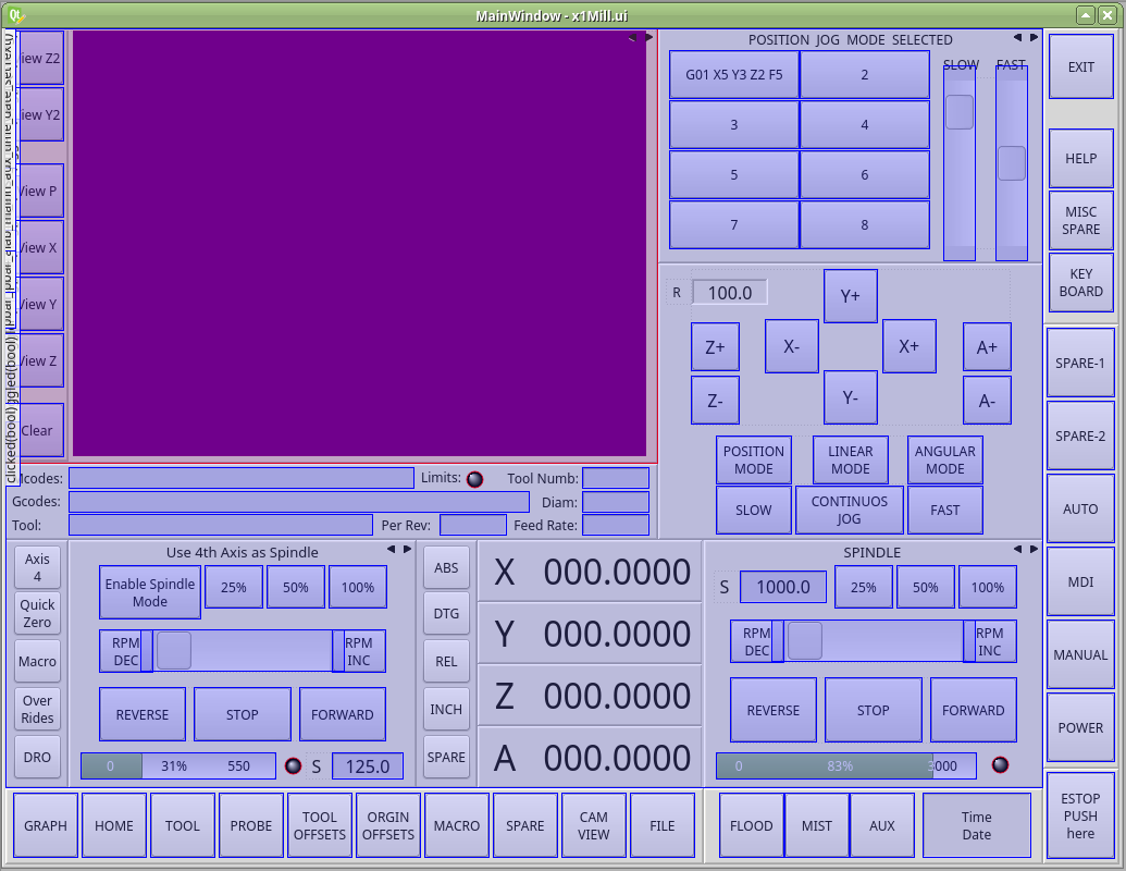

In one of my prior post I had mentioned that I had some problem with the clutter that the qt designer signal/slot editor can create in more complex gui designs. As a result I do a good deal of this work by editing the .ui xml file. My 1xMill gui has 178 signal and slots defined right now. 178 signal and slots would equal 356 large labels and the 356 wires pointing to their connections. That will make the editor unusable because the labels will hide all buttons or other items that have already been entered for connections.
Since these labels are just used to give hints they can be moved out of the way and just stacked up in one location. If you remove the hint items in the .xml file qt will put them back in which is ok since they default to location x20 and Y20. I decided to move them all to x0 and y0 in my updated .ui file as shown in the power on button example below. There are 186 more with different items plus the associated slot also sown below.

Here is a picture of the result.

Chris and everyone interested in Qtvcp work in progress.
I have uploaded the 1xMillGui to git hub - not fully functional yet but getting very close.
I think most of the features I wanted to include in the 1xMill gui are there and pleased with it. Now starting to work on the special items to get those to work. If you load this gui the way it is now you may find that it is always in jog step mode. It needs more work but it will give you and idea how it works and what it can do when completed. I will mostly likely work on the handler file, and welcomes help and suggestions on how to get all the features working.
There could potentially be some button or other minor changes to other types if that is appropriate.
You can find it on get hub: auto-mation-assist/1xMillGui.

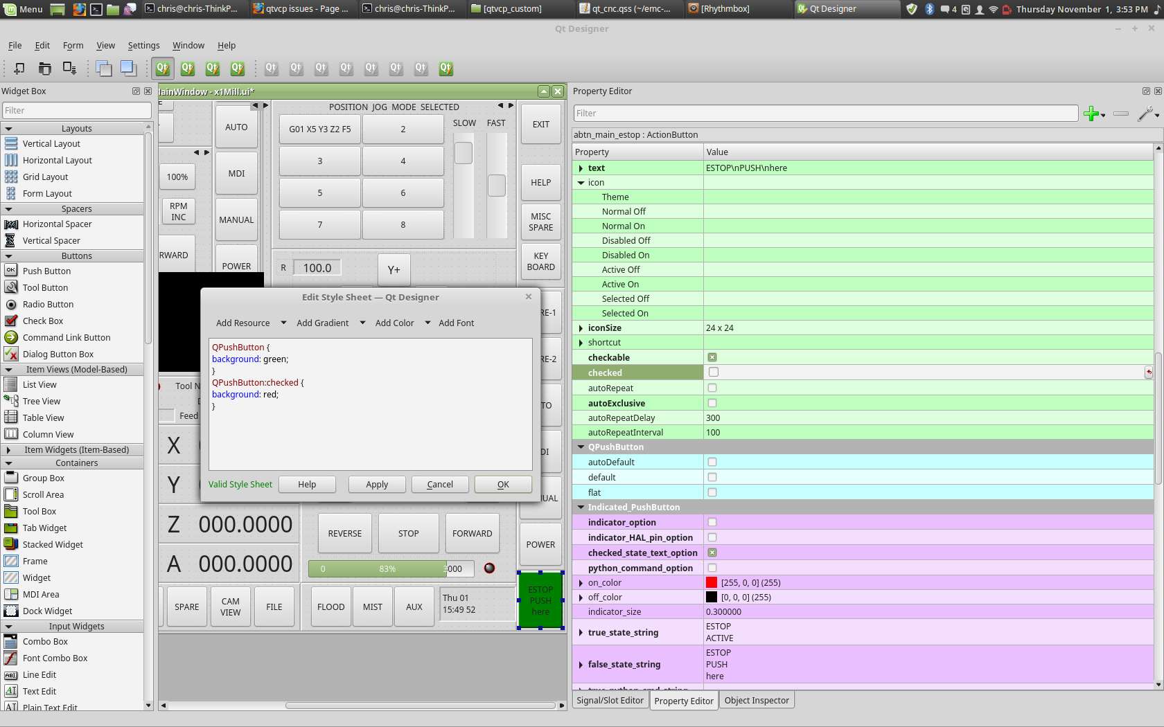

- Posts: 7368
- Thank you received: 2181
01 Nov 2018 17:56 #119793
Replied by cmorley on topic qtvcp issues
Here is a picture of change the backbround of a pushbutton using designer.
First you right click the button and choose 'set stylesheets'
This is just a very basic example.
Stylesheets use a cut down version of CSS and is a subject all on it's own
Chris M
Chris M

01 Nov 2018 21:37 #119801
by auto-mation-assist
Replied by auto-mation-assist on topic qtvcp issues
Chris,
While were talking about buttons I miss the ability to set the default state, like a check box making the current state the default state (True or False). I used this feature in Labview quite often. It bothers me that buttons seen to like to come up in that False state when bringing up my gui which does not reflect the actual state of what panels are actively shown at start up.
Same problem with the jog slow and fast buttons, one of those should always be true on start up.
I can set the panels shown at start up in the handlers .ini section but I have not found or can not recall the correct command to set the state of a button there.
- Posts: 7368
01 Nov 2018 23:31 - 01 Nov 2018 23:32 #119803
In designer under 'abstract button' you will see a property 'checked' (just under 'checkable') this will set the state of the button on startup - unless it is controlled by linuxcnc - then it will display the linuxcnc startup default.
For instance if you use the estop action, the button will reflect the state of linuxcnc no matter what.
If you want to set button state in the handler file (again as long as it isn't controlled by linuxcnc):
self.w.[SOME_BUTTON].setChecked(True)
If you want to set an action button that is controlled by linuxcnc, then you must set linuxcnc's state. This should remove Estop on start up, and the button should follow.
ACTION.SET_ESTOP_STATE(False)
These should be put in the initilized__ function (under the heading 'Special Functions called from QTVCP')
Chris M
