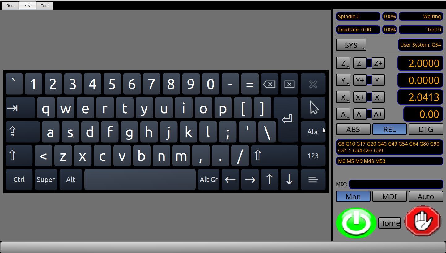

Replied by cmorley on topic qtvcp issues
- auto-mation-assist
- Posts: 425
- Thank you received: 81
28 Oct 2018 15:38 #119568
by auto-mation-assist
Replied by auto-mation-assist on topic qtvcp issues
Nice, the keyboard looks great I will see if I can get it to show up in my stackedWidget_2 index 1 later today. Is there some thing special that needs to be done to get it to load? My stackedWidget_2 index 1 has space for 954x228 objects which I figured was large enough for a key board.
I will also try out the other changes you have made after I get done doing some button work between the gui .ui file and the handler. I will go ahead a do a pull now.
I added a layout widget, then the XEmbed widget, change the command property to onboard --xid
I think i added a spacer widget to make the keyboard a bit better size.
Chris M
Well it seems while the keyboard a;ways embeds..it doesn't work consistently - at least for me.
Chris M
I would think that if the keyboard does not work constantly that is a good chance that its a timing related issue. I have not had a chance to look at it.
Ran into a little problem with push button action to bring up a page when used with python cmd string and is checked in checkable.
True cmd string: INSTANCE.stackedWidget_2.setCurrentIndex(1)
False cnd string: INSTANCE.stackedWidget_2.setCurrentIndex(0)
The thought is that the button should act like a toggle button, push on, push off. But as soon as the mouse is released from pushing the button to the on state it sends the false cmd with the button indicating that it is still in the true state. Thus it sends commands improperly under this condition.
