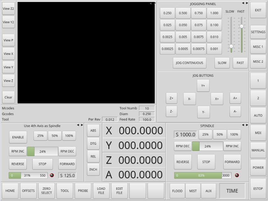

I thought that I would post a picture of the qtvcp gui that I have been working on for my Acra milling machine, I named it x1MillGui. It has four areas right now that uses stacked screens. It will take a while to make additions and changes until i'm satisfied with the layout.
The attached picture shows the present manual mode page.
I use this mill in manual mode a lot more that cnc mode and that shows up in the jogging section. There is a switch on the mills control panel that I built that disables the servo drives so that X, Y and Z can be moved manually. Z can be moved manually after releasing the clamp on the ball nut. A axis will stay under control of the gui. This mill also retains all of its normal none CNC functions.
