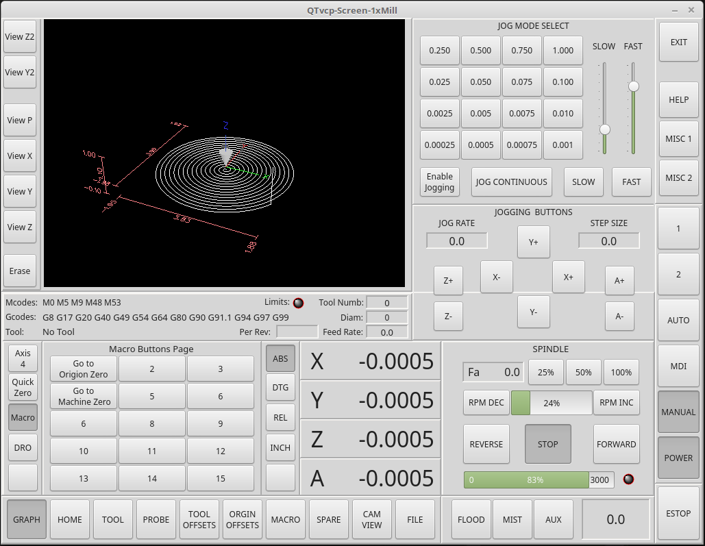

Im making good progress now that I have been able to program a good number of signals/slots. I still need to get more of its pages completed and work on a number of smaller things like getting the time and date in the small label to work and have the onboard virtual keyboard show up in its designated page. I have one page that that I need to hide when it is not in use since it has overlaps with another as can bee seen in the pictures. I'm sure there will be quite a bit more, but its talking to my machine now. I will work toward making it available as a QTvcp demo later.

It's looking very good!
I would love to add it as a sample screen when you are done if you are willing.
Chris M
