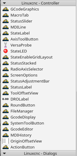

Ok I see now that all the plugin files are compiled by qt designer.
I should say the files are compiled when the designer is started.
Last edit: 20 Nov 2018 23:32 by auto-mation-assist. Reason: I should say the files are compiled when the designer is started.
- auto-mation-assist
- Posts: 425
- Thank you received: 81
20 Nov 2018 23:29 - 20 Nov 2018 23:33 #121102
Replied by auto-mation-assist on topic qtvcp issues
I have success now as show in the picture. It turns out that the link was there but likely invalid and unusable because the libpyqt5_py2.so file was missing. I don’t know how the file libpyqt5_py2 was removed. Perhaps is was done when I installed the full version of qt which I likely do not need and is very large and time consuming to down load. I don’t think the file was removed by a make clean operation for linuxcnc which is unlikely since this file has to placed there manually as root.
Perhaps the below info will be helpful in some way for others. The examples I have listed below are the paths in my development computer, yours will be different.
The tar.gz for this file can be found in /qt5vcp_py2/lib/python/qtvcp/designer/x86_64/ one of the folders there (qt5.5 or qt5.7). Use which ever is required by your system. I use Linux Mint so I use the qt5.5 version. You should just have to double click on the file to start the extraction process which will result in file creation with the name for either version of: libpyqt5_py2.so
This extracted file needs to be copied to the below location using root privilege. If the complete file path is not there such as a missing python folder you will need to create it.
/usr/lib/x86_64-linux-gnu/qt5/plugins/designer/python
After this ihas been completed a sim link has to be added to that folder as root. In my case I used the below but your path will not be the same to the location of the /lib/python/qtvcp/plugins folder.
# ln -s ///home/cnc/qt5vcp_py2/lib/python/qtvcp/plugins/qtvcp_plugin.py qtvcp_plugin.py
On the date of this note the items in the picture should display in the qt designer.
Last edit: 20 Nov 2018 23:33 by auto-mation-assist.
- Posts: 7368
- Thank you received: 2181
21 Nov 2018 07:40 #121123
Replied by cmorley on topic qtvcp issues
Excellent. That looks much better.
Chris
Chris

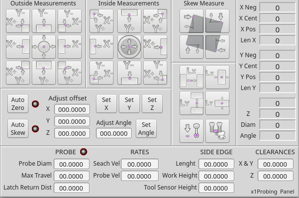

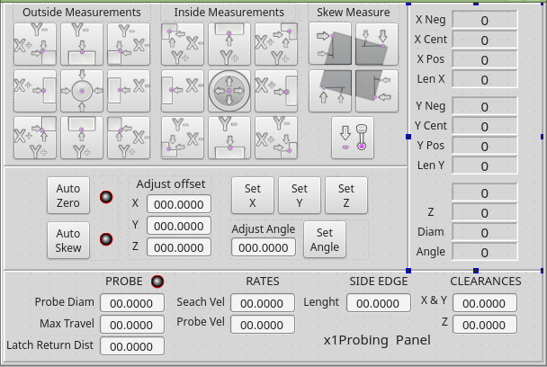

The plug that is on the cable coming from the probe provides a ground signal (True/False) to a hall pin that disables the spindle run function so that the spindle can not be turned on as long as the probe is plugged in. The connectors on all my probes are multi pin XLR types. This provides a logic interlock for added safety.
I have pushed a change for the verser-probe panel to get the probe function check led into the panel and gave the three led's that hal can use.
This change can be found in my git hub: x1Mill_branch/lib/python/qtvcp/widgets/

22 Nov 2018 00:31 #121205
Chris,
I have pushed the panel and handler for probe screen version 2.
The x1Probe_v2 handler has everything that was in the latest x1Probe handler plus the additions for the five extra buttons and two date inputs for the entries for tool probe height and the work piece height.
The update is in the sim folder for x1mill/x1Probing/x1Probe_v2.
