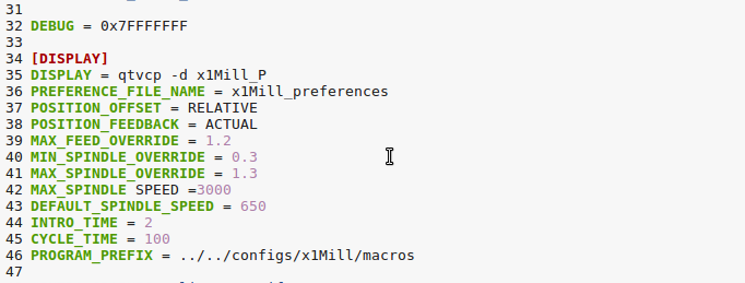

I have found something interesting that is potentially a problem that needs to be looked into.
If I modify the x1Mill_P gui to look like this and save it and making sure it goes into the folder where my .ini file is:
When running I get back:
So there is a path determination error in that the gui file being used is not the one in the folder that .ini is in.
Here is what I have for a gui path and this is expected to route correctly and likely the source of my problem.

To determine the actual file location of my .INI file and to use it as a base location for all other file locations for my x1Mill gui. I have some code in my handler file that I use to do this. Right now it only has determination for my preference file but other files or paths to files can be added easily from this base location.
I plan on having everything that the gui requires within the folder that the .ini file is in, including folders for icons, macros, or whatever. I do not like scattering these items all over the place. I want to be able to grab the entire folder for backup and have everything it needs.
Attached is the code I use in my handler that for right now only has my preference file added. Perhaps this will aid in properly locating the .ui file under all conditions when its name is added.

If you look at the debug output in the terminal, it should give you information about where it is looking for the UI and handler file.
The is already a mechanism for finding path information.
in the handler file's __init__ function, the 'paths' gives reference to this information.
for instance:
paths.CONFIGPATHS gives the path to the configuration file that was launched.
paths.IMIAGEDIR gives the path to standard image files.
There are more.
The qtvcp.core library 'Info' gives important INI information, including the INI path
There is already a mechanism for a preference file - that is one of the things the screen_options widget sets up.
In the handler file's initialized__ function, the variable 'self.w.PREFS' holds the reference to the preference file
for instance:
There are more.

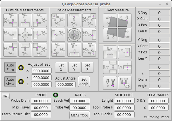

Since I got my project back on tract and finished with my buttons and hal pin self lessons I had time to get the 'form' probing panel up to date for the Versa Widget.
I have pushed the latest and perhaps final version of the probe .ui along with documentation that is in the document folder to my git hub account at: github.com/auto-mation-assist/x1Mill_bra...m/x1Mill/versa_probe
I would like to make this the Versa_probe.ui and then help work on anything required to integrate it and make it compatible with the versa_probe.py widget. Since I use the .ui in multiple projects I would like to keep the names within the .ui file the same.
Let me know what you wish me to do.

That looks great.
The only reason i haven't updated the ui file is because of the name changes.
Ultimately I con't care much what the names end up as, but during development, it's painful to convert from versa probes naming to yours, while still referencing versa probes function names.
I'm having difficulty to test the probe routine on a real machine as my machine is not sable with the newest distribution. I do note that we probably have to look at what to do if the motion controller is in out of metric mode. ( I assume you use metric )
Mind you it might a problem because the conversion is not completed.
I'm curious why you would still us the ui file separately after a widget is made - surely the widget is easier to use?

Working with what I have within the x1Mill gui related to probing allowed me to get a good feel on what was needed and how it could be accomplished in a way that was like original with only name and format changes. It does not need a lot more to become fully functional but I do not plan to continue on that path. But may come useful in the future so I will just put it in storage as a potential resource.
I will work on getting the latest .ui into the Versa Widget on my end and do any name conversions required and see how it goes. I think you may have the straight down probing working or nearly complete. I can easily test on my milling machine.
I know that changing the names from the originals on my end was a pain but did not mind doing it to match the .ui file that was generated long before looking at Verser code.

Ok I pushed updates to include your latestest design and reworked the names to use your defaults - other then I fixed a miss spelling of length.
It's on going work of course.
