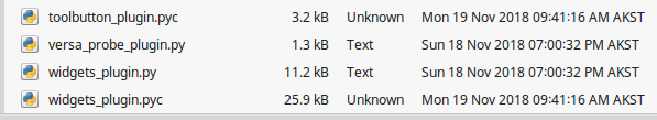

19 Nov 2018 13:07 - 19 Nov 2018 13:26 #121017
by auto-mation-assist
Replied by auto-mation-assist on topic qtvcp issues
Chris
gitk tells me that I'm up to date with it showing: qtvcp -versa_probe ongoing work
I have noticed a problem with: 'versa_probe_plugin.py'
This never compiles into .pyc which is likely the problem.
I usually ignore all the missing Icon error messages when the designer loads. in the middle of them there is:
[QtDesigner.QTVCP.WIDGETS.MACRO_WIDGET][DEBUG] Exception loading Macros: (macro_widget.py:307)
File "/home/cnc/linuxcncDev/lib/python/qtvcp/widgets/macro_widget.py", line 268, in _findMacros
for f in os.listdir(path):
OSError: [Errno 2] No such file or directory: 'None'
[QtDesigner.QTVCP.WIDGETS.MACRO_WIDGET][DEBUG] Macros Found: None (macro_widget.py:164)
This is likely not related to the versa_probe not showing up issue.

- Posts: 7368
- Thank you received: 2181
19 Nov 2018 15:31 #121026
Replied by cmorley on topic qtvcp issues
The MACRO error is expected and relatively normal. It just didn't find an INI setting for macro subroutines - because there is no INI for a widget in deaigner.
I fired up one of my computers and pulled in the new changes. This is a computer I don't used for development so is pretty clean -codewise.
It showed all widgets no problem.
can you post the file qtvcp_plugin.py.
there should be an entry 'from qtvcp.plugins.versa_probe_plugin import VersaProbePlugin'
If there is then this file isn't being called for some reason.
Then I would look at your designer plugin link to see what it is linked to.
Chris M
Chris M

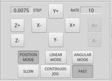

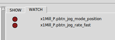

20 Nov 2018 00:02 - 20 Nov 2018 00:03 #121042
I'm running into a problem that is slowing down my progress a bit. Its a problem between logic states for the created hal pins within qtvcp and those developed in the handler directly from actual state of the buttons.
In my handler I have this code but the only important thing is that the button is either pushed in or not pushed in. I have added some print statements for testing. The print statements show that the button states are correctly determined, as does the logic that uses this function.
The problem with the hal pins is that they do not remain in the proper state. The hal pins will flash the correct 'pushed' in state and then clear to the 'not' pushed in state. As long as the mouse button is held down the states of the hal pins is correct. Thus the pins appear to clear on mouse button release. The buttons are checkable and autoExclusive.

Button state 'darker color is 'pushed in':
Hal show for these two buttons show that the state is incorrect.
