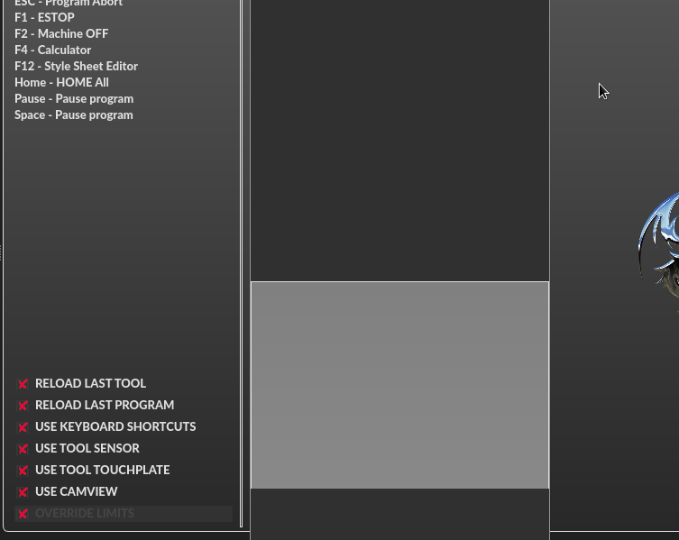

That is a really nice screen.The latest version of QtDragon_hd. Main differences are:
- added joypad widgets for jogging and program control
- support for an MPG
- replaced override sliders with adjustment bars
- new stylesheet
- several operational improvements
If you want to check it out, all the files are at github.com/persei802/QtDragon_hd
Ignore the blank space at the bottom of the screenshot. That's because my laptop has a UHD screen.
I wish there was one for turn that nice.

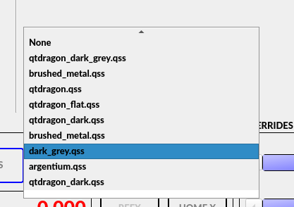

24 Sep 2021 21:15 #221519
by robertspark
Replied by robertspark on topic Sample Qtvcp Screens
QT Dragon HD, Argentium style sheet (+ others too)
Just wondering how you spin boxes are tabulated / filled with text, mine are blank, unless if I select the simple style sheets then they are populated with text.
ideas, what I am doing wrong?
