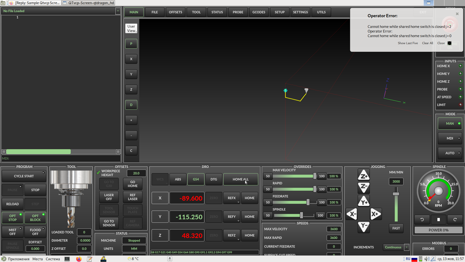

Linuxcnc 2.9 QtDragon_hd. How do I move the interface window? QtDragon.hd has an error when re-entering Home.All.

Replied by cmorley on topic Sample Qtvcp Screens
First this looks like Jim's version of dragon_hd - please be specific about what screen you are referring to if it's not obvious) when asking questions.
second This is a thread to primarily show off new screens/screen ideas - please keep questions to a minimum - a separate thread would be appropriate.
If the homing problem is only when in sim - it's just a product of the simulation. Try jogging the X axis to the left a bit then rehoming.
To move the window when there is no window top bar - press and hold the ALT key then click and hold the left mouse button while on the window - now the mouse will move the window/

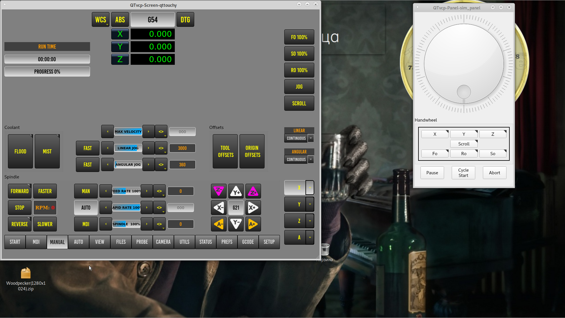

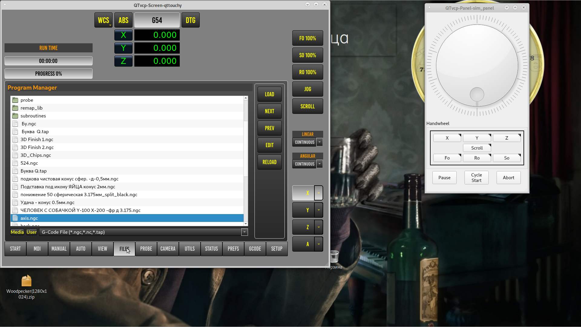

Changed sim.qttouchy a bit. This is the beginning, wishes are desirable. Thanks.
Certainly looks nicer then the default screen!
I had meant to add MDI history to MDI_Touchy.
I think a stacked widget with a button to flip between them - or something like that.

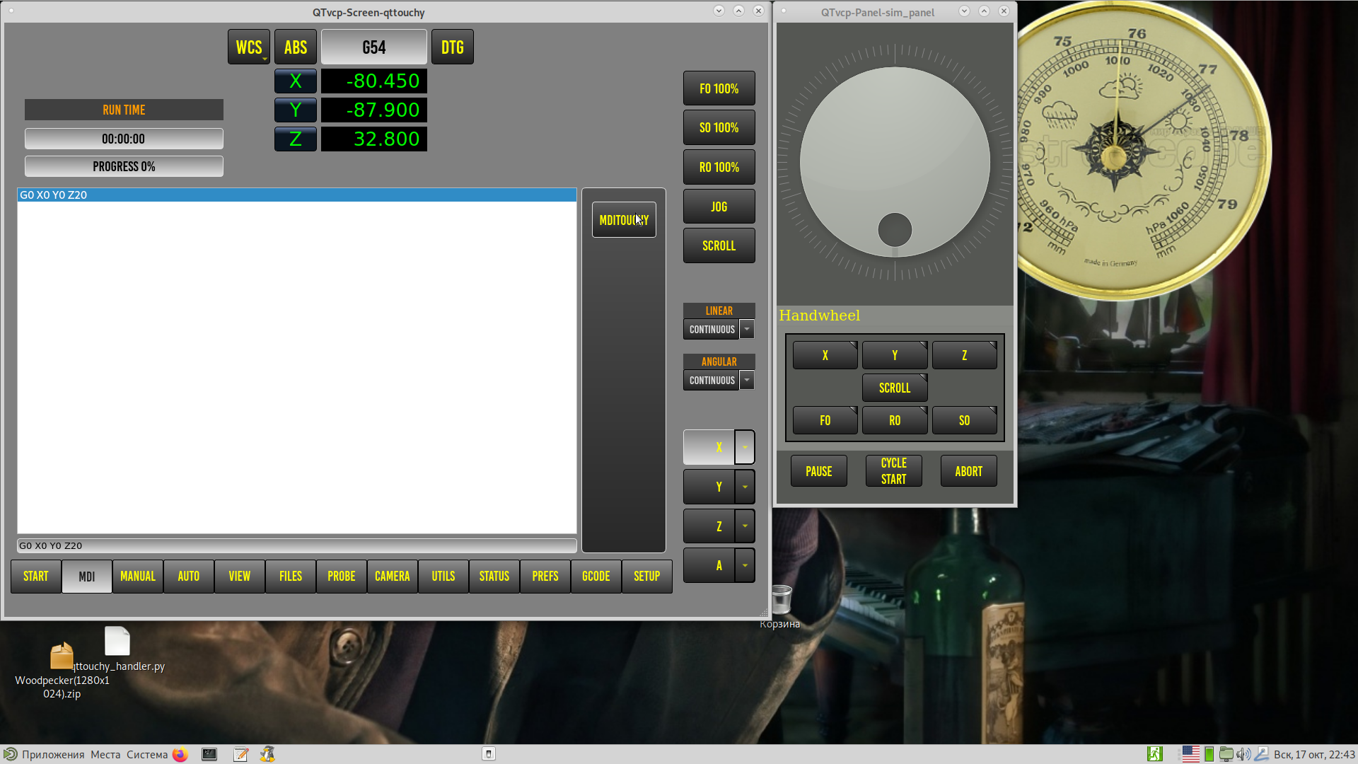

Replied by hottabich on topic Sample Qtvcp Screens
Thanks for the advice. It turned out like this.

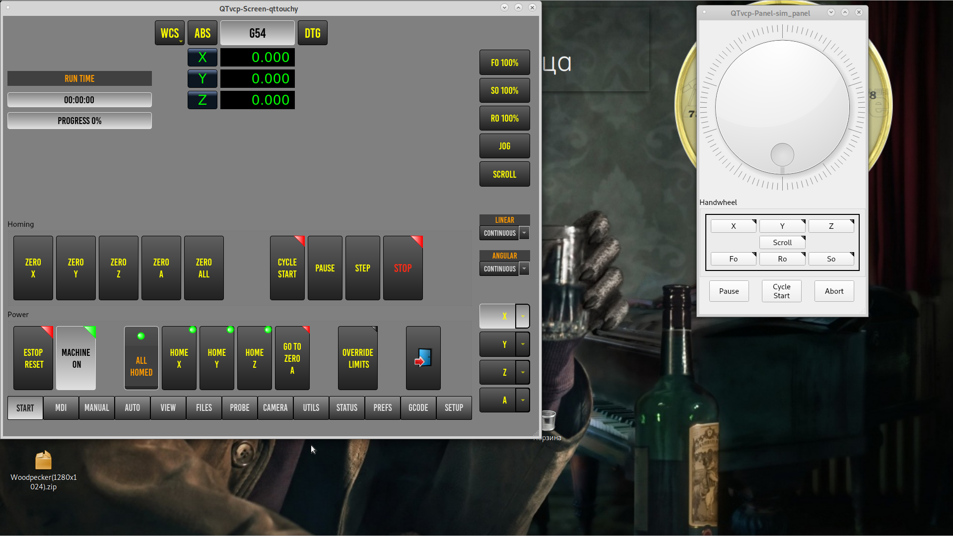

This is how sim.qttouchy looks like.

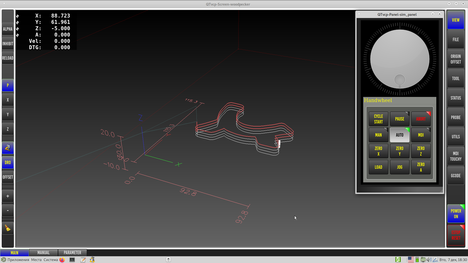

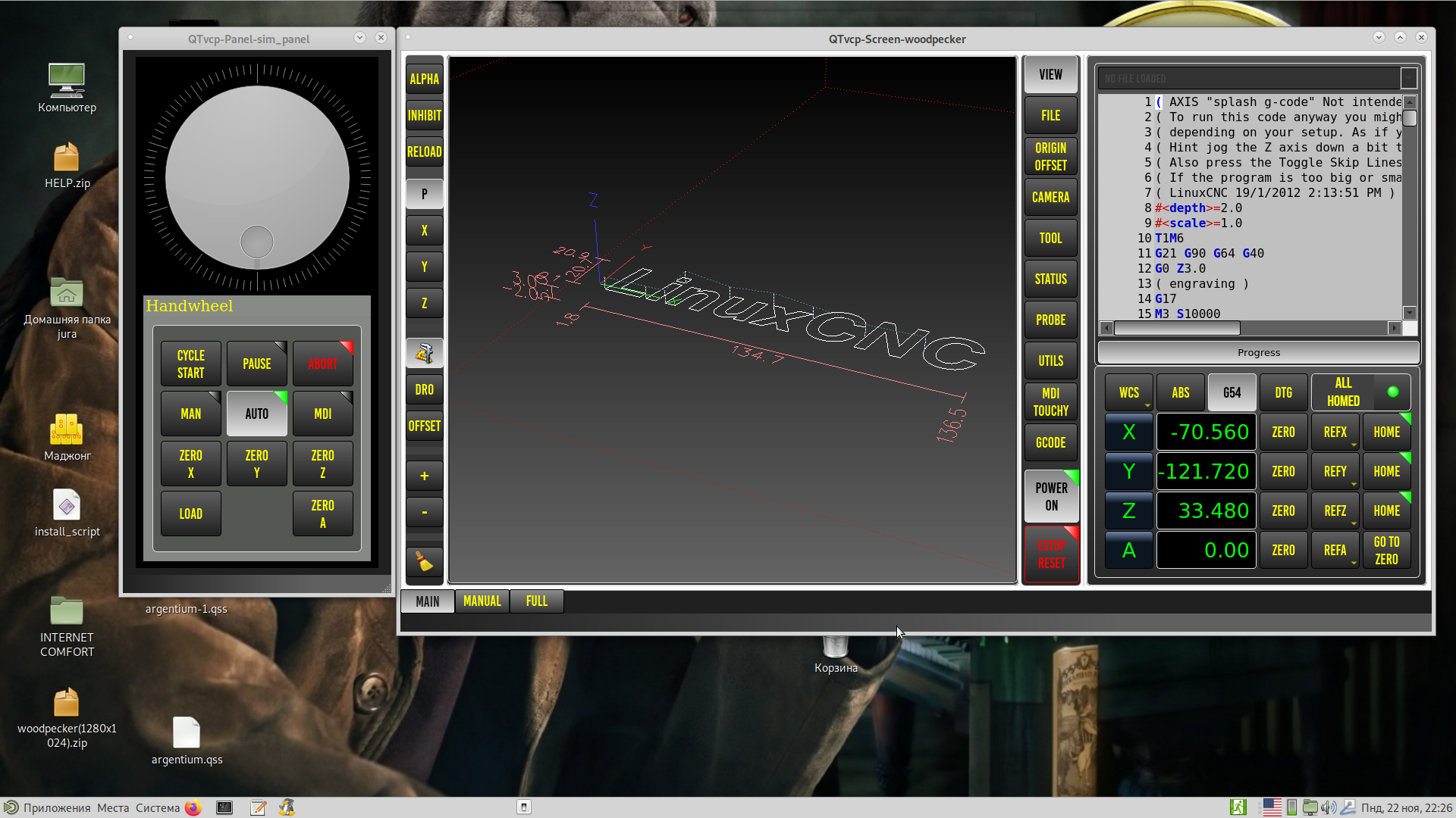

Meet woodpecker xxL from (1360x768) to (1920x1200).
The following user(s) said Thank You: phillc54, tommylight

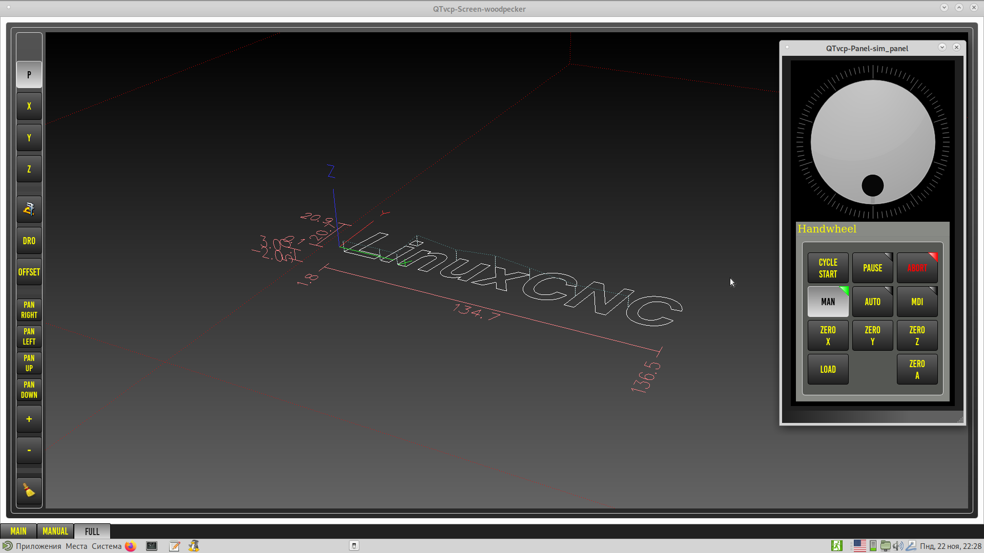

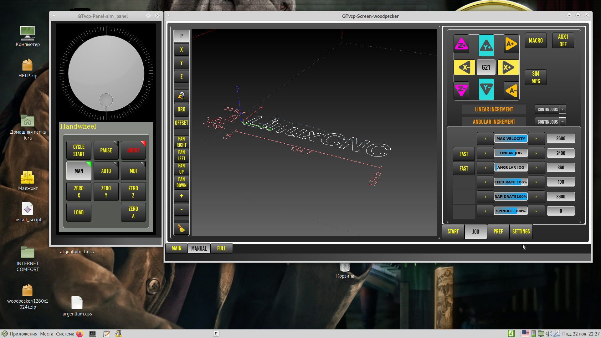

Woodpecker xxL from (1360x768) to (1920x1200).

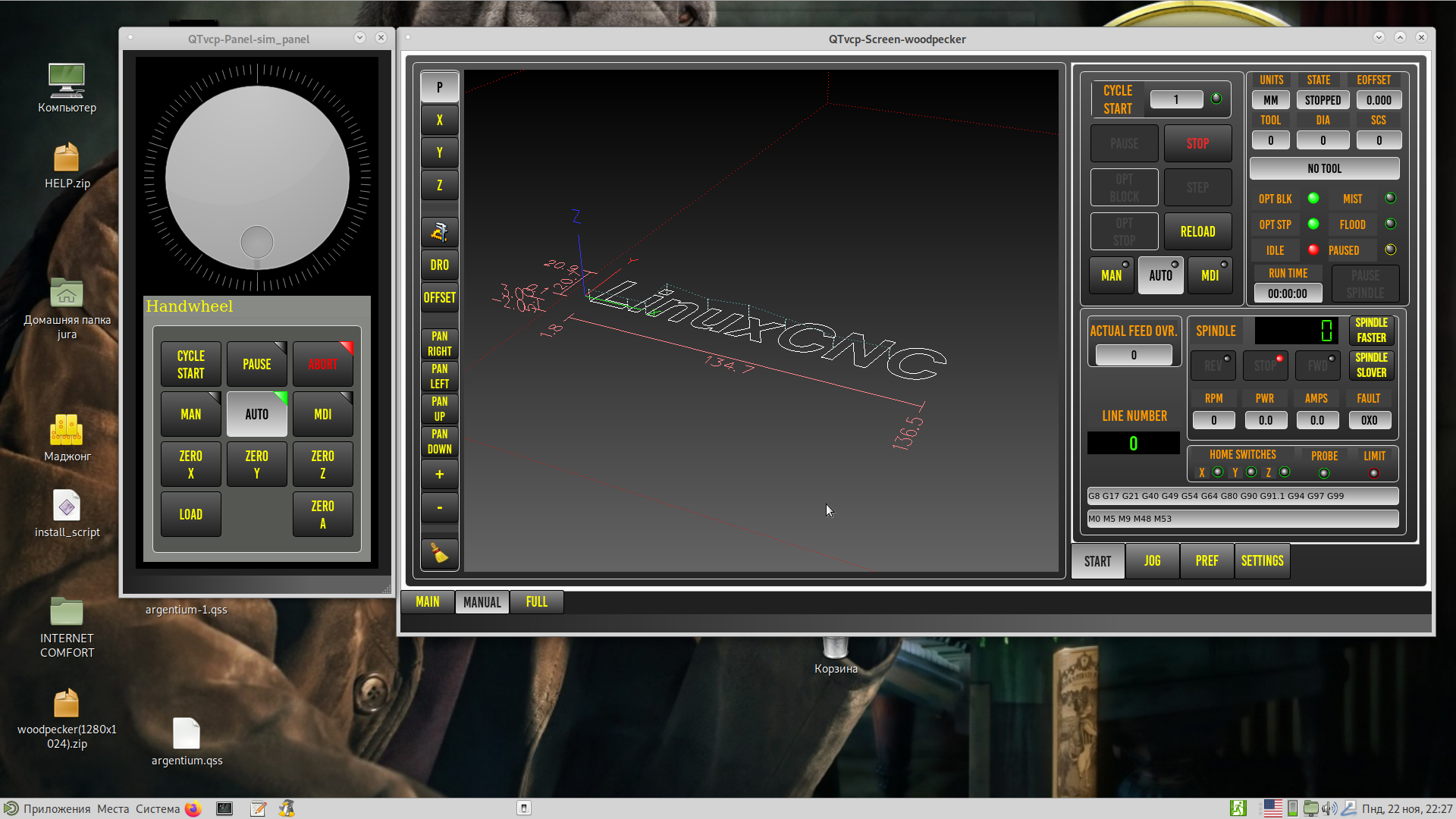

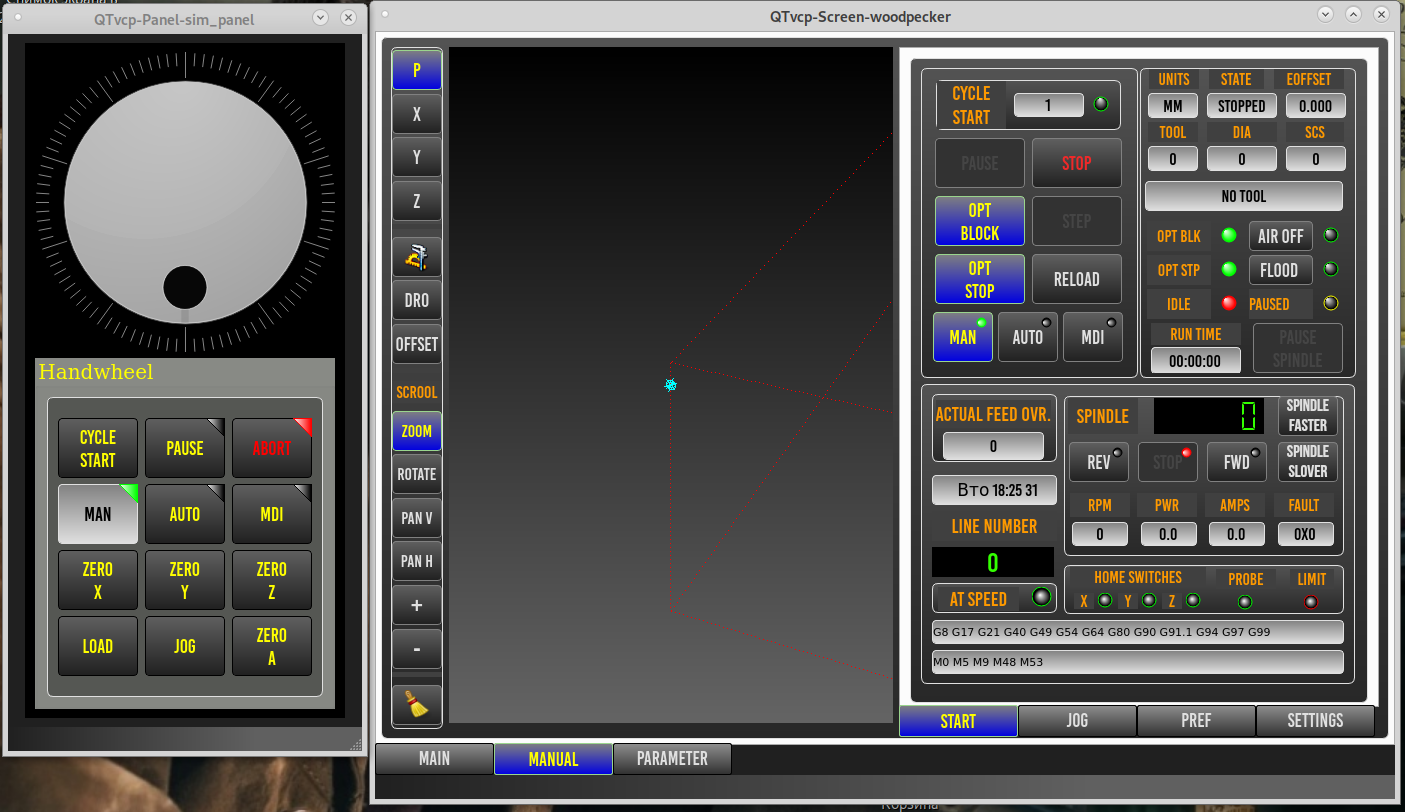

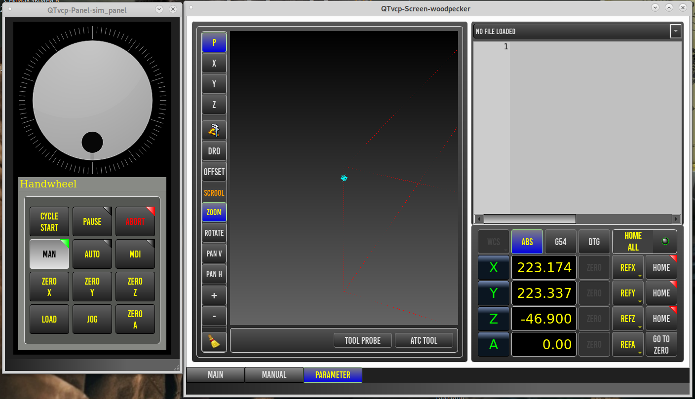

Meet woodpecker xxL from (1020x768) to (1920x1200).
