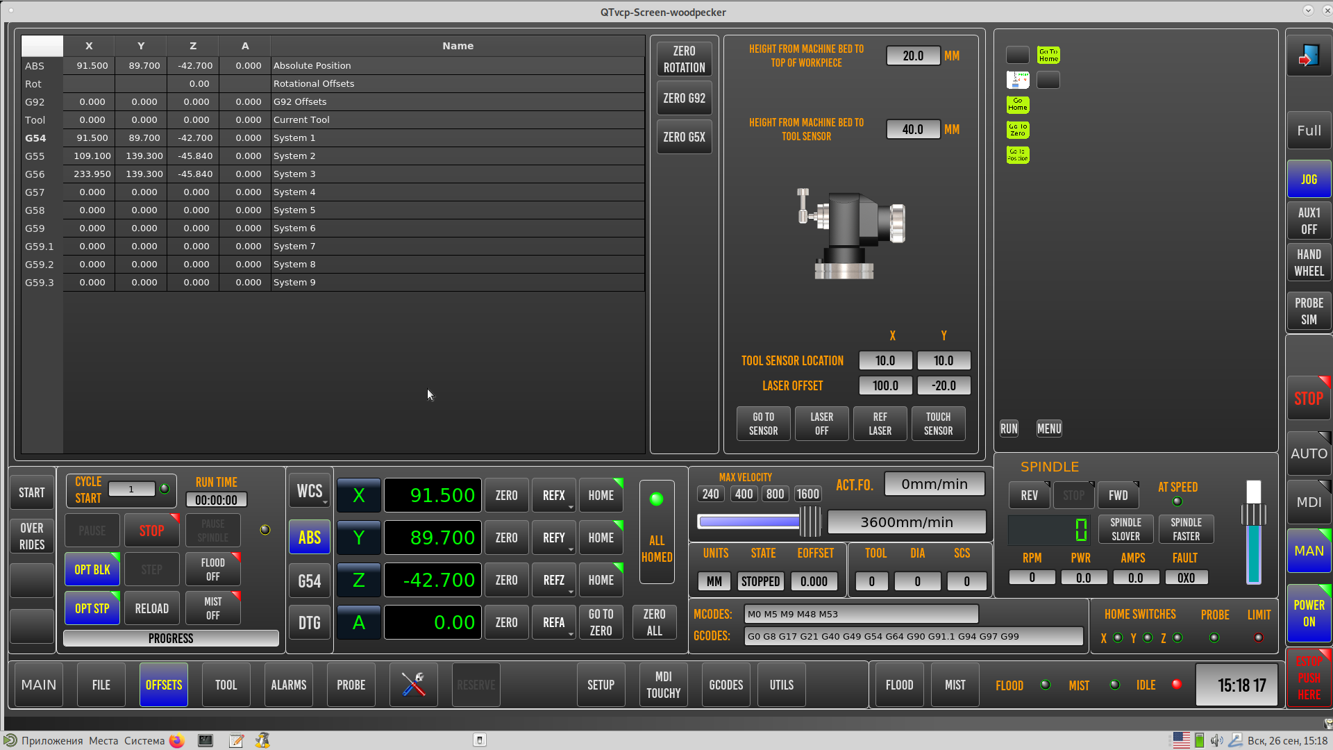

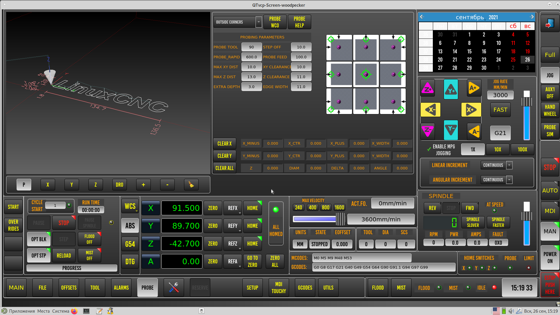

25 Sep 2021 11:30 #221543
by hottabich
Replied by hottabich on topic Sample Qtvcp Screens

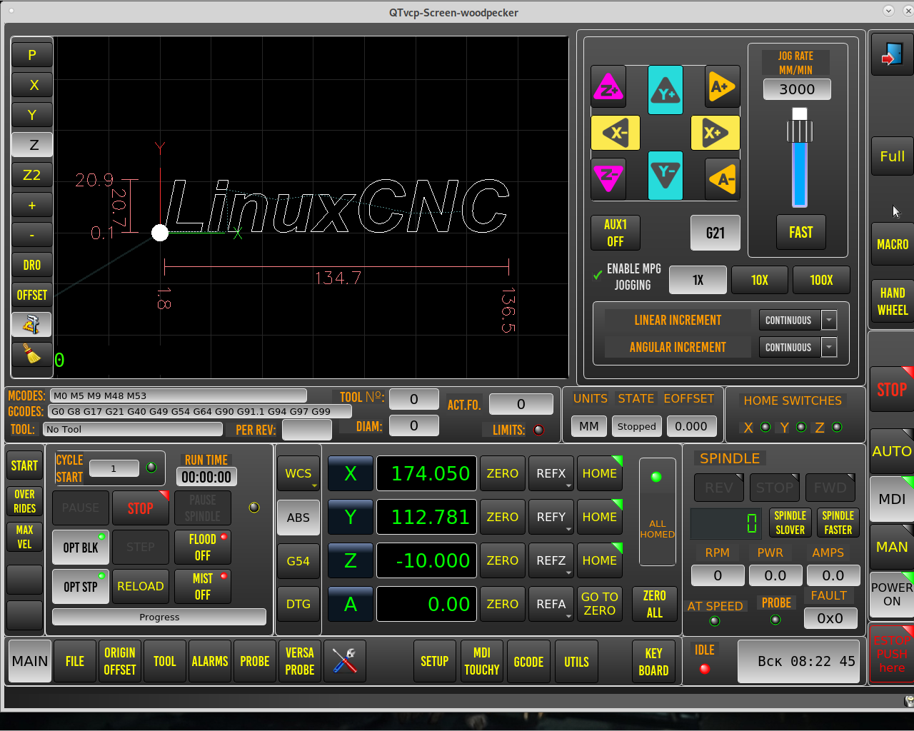

For woodpecker(1920x1150).

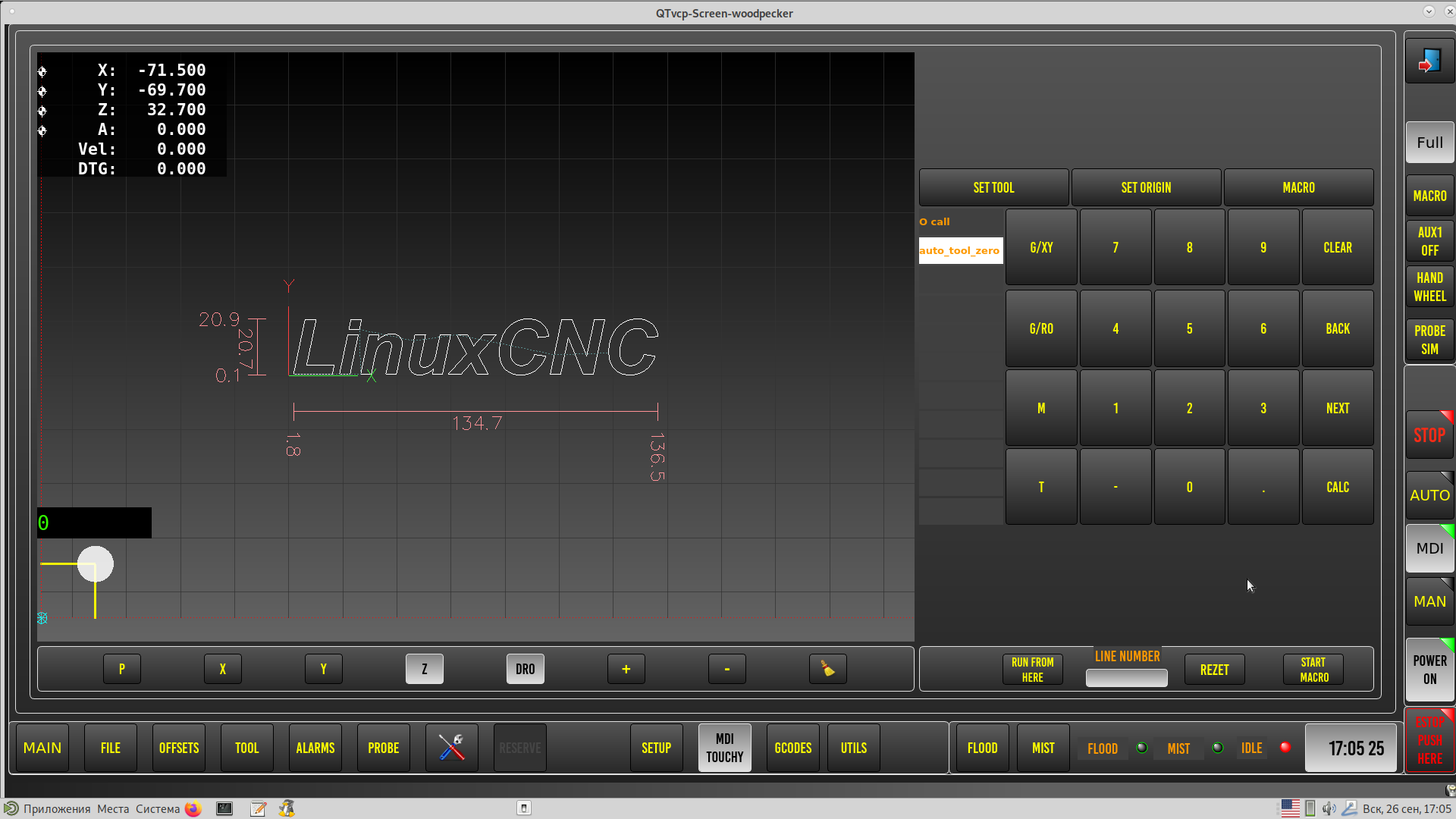

Replied by persei8 on topic Sample Qtvcp Screens
That particular combobox is populated with the contents of the stylesheet editor combobox. Qtvcp scans the config and shared folders for .qss files and populates the combbox with whatever it finds. I put it there as a convenient way to quickly change styles. To see how the handler populates that combobox, look for the section that starts with "# populate stylesheet combobox"

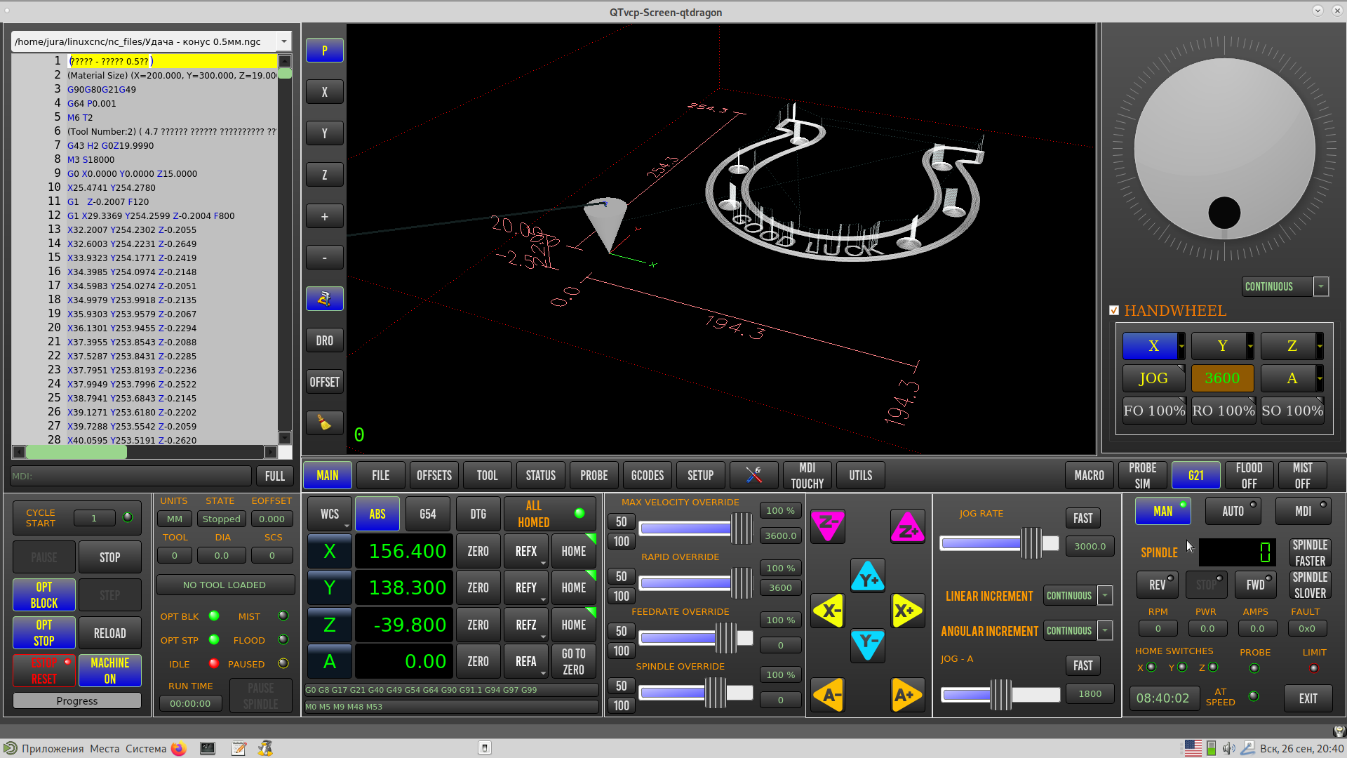

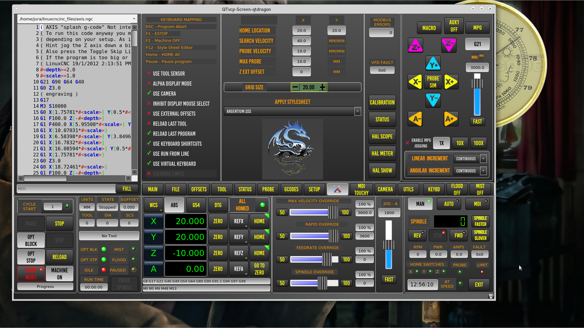

26 Sep 2021 12:12 #221628
by hottabich

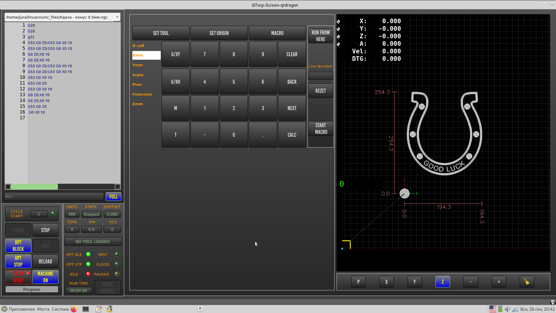

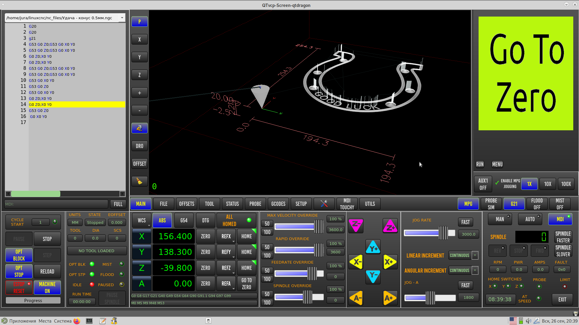

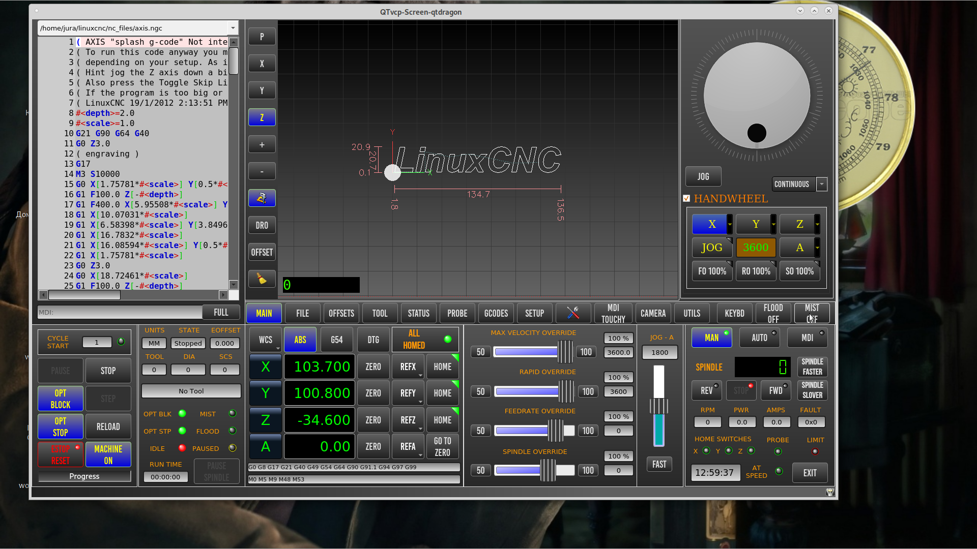

The qtdragon1600x960 interface . I suggest those who wish to test. Reviews are welcome. For Linuxcnc 2.8.2. Downloads: files.dp.ua/ru/WSHxVe

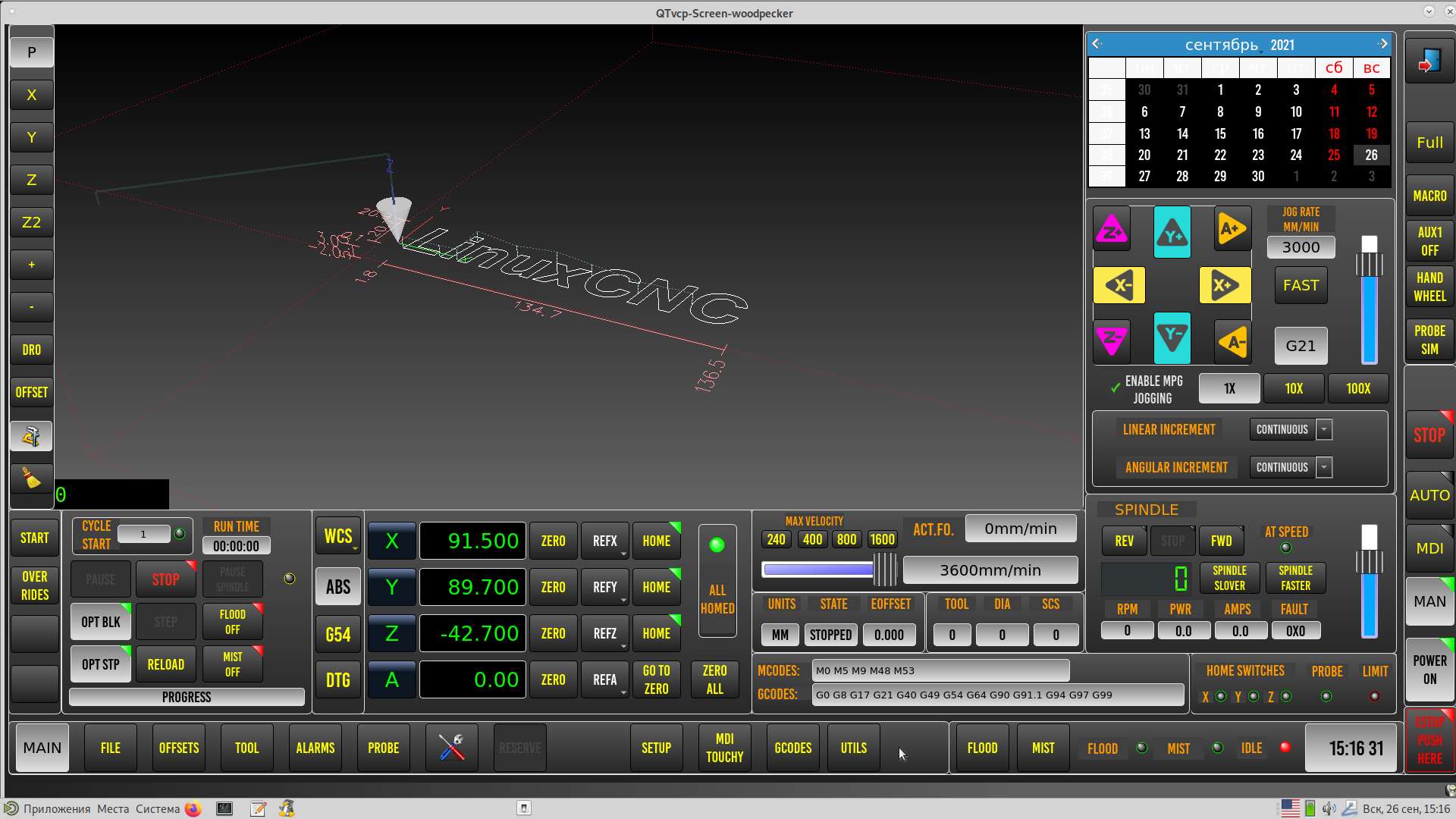

The woodpecker1920x1020 interface . I suggest those who wish to test. Reviews are welcome. For Linuxcnc 2.8.2. Downloads:https://files.dp.ua/ru/wGyKCm

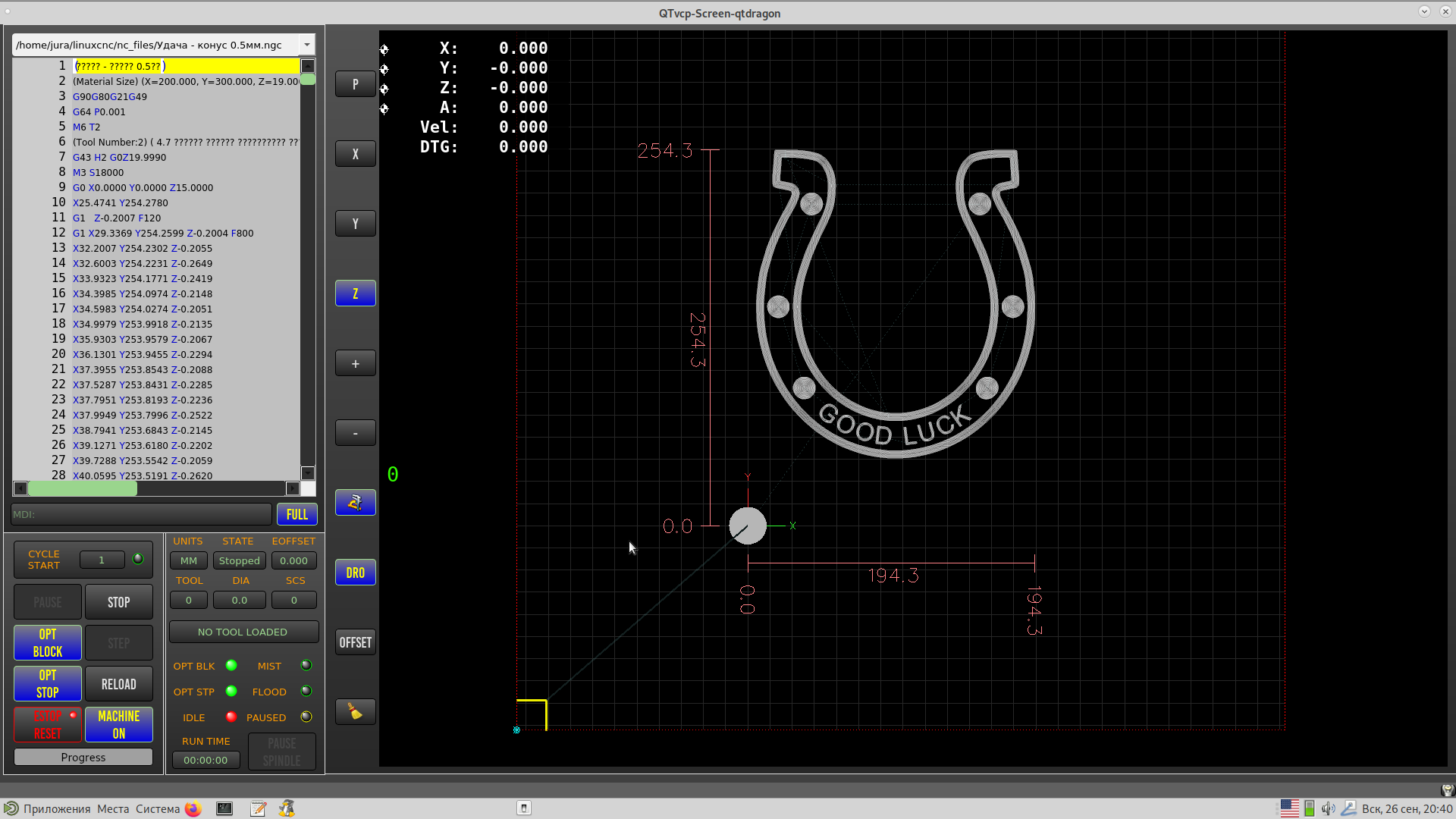

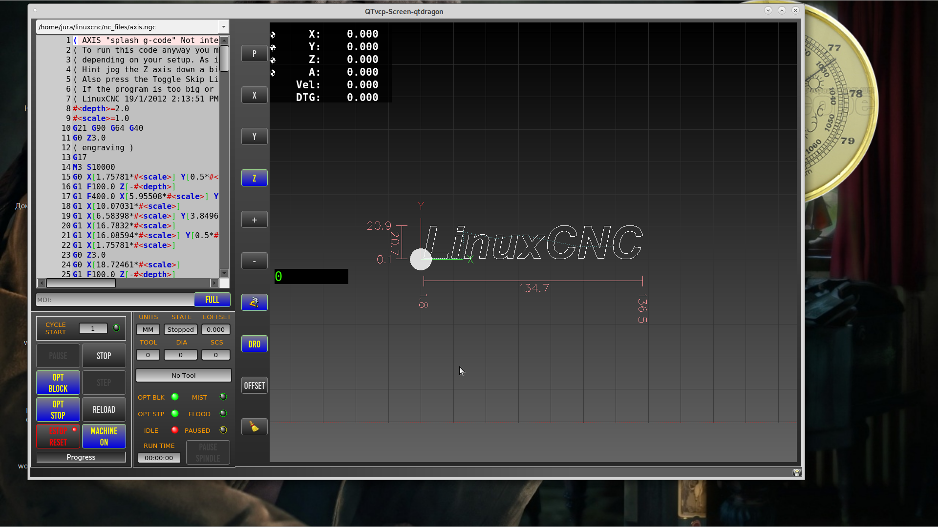

The qtdragon1920x1020 interface . I suggest those who wish to test. Reviews are welcome. For Linuxcnc 2.8.2. Downloads:https://files.dp.ua/ru/Gk86
- Posts: 7368
- Thank you received: 2181
27 Sep 2021 01:03 #221675
Replied by cmorley on topic Sample Qtvcp Screens

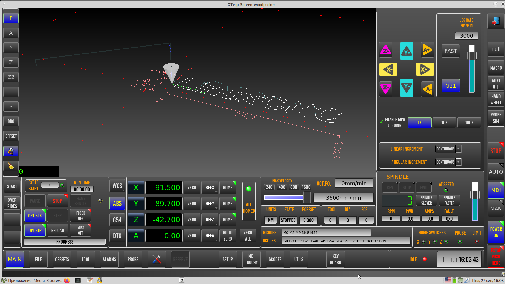

One critique comes to mind.
I notice you have flood and mist coolant buttons and LEDs in two places.
I think you should work hard to have controls and status in one place as much as possible.
Otherwise the screen gets to looks a bit 'busy' (cluttered)
IMHO I'd work on taking things away until usability issues come up.
ie I would remove the calender, if only to put a low-key image there.
I like woodpeckers layout and full view of all tabs. Keep up the work!
Chris
Chris

Thank you for your attention and tips. Ui file for woodpecker (1580x960), woodpecker (1920x1020) with your comments in mind.

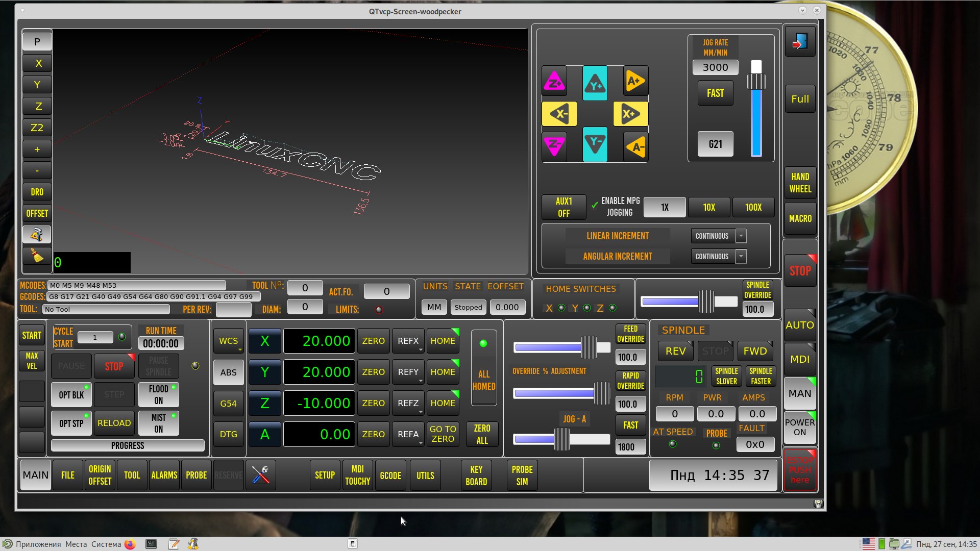

03 Oct 2021 05:29 - 05 Nov 2021 17:32 #222071
by hottabich
Changes for woodpecker (1280s 1024). For linuxcnc 2.8.2.

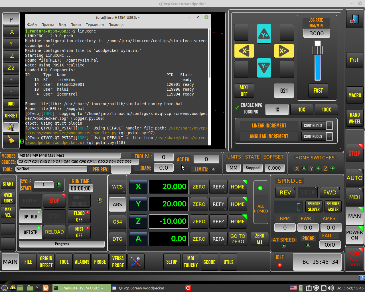

03 Oct 2021 12:53 - 05 Nov 2021 17:32 #222100
by hottabich

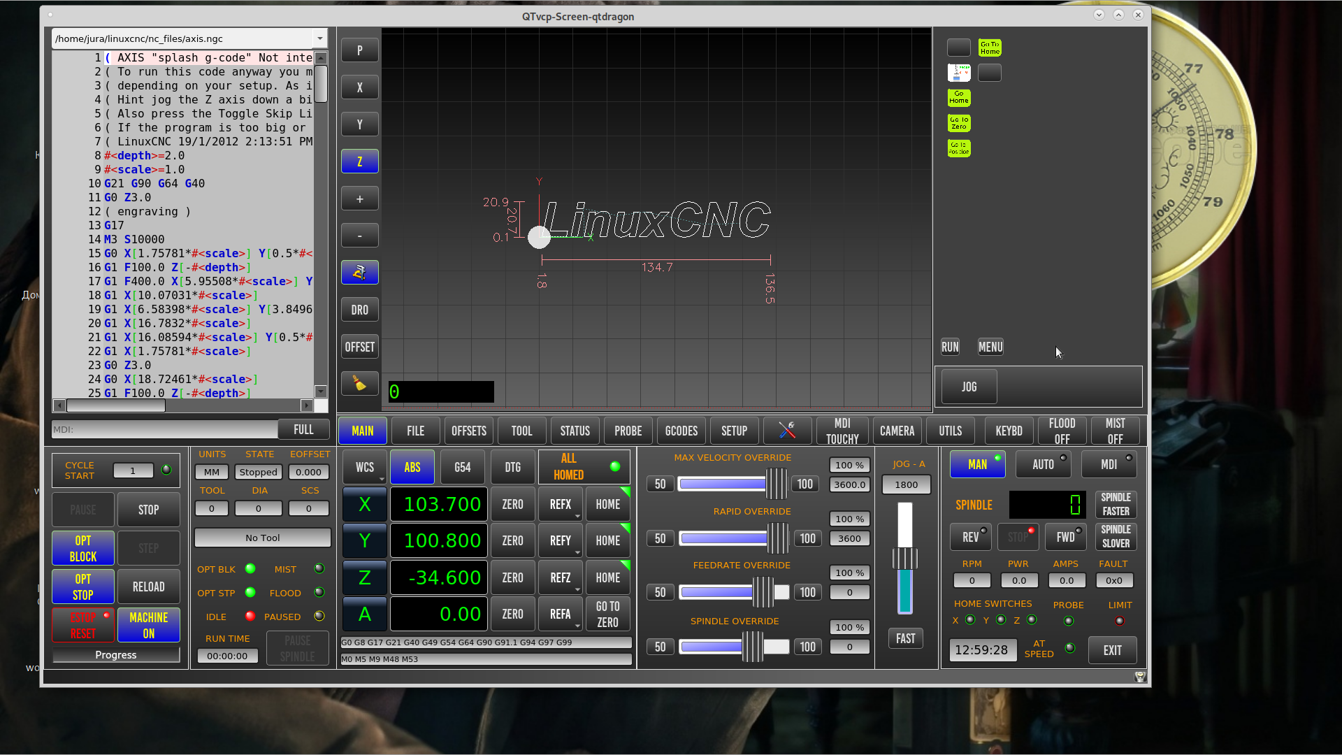

For Linuxcnc 2.9.0 pre0.
