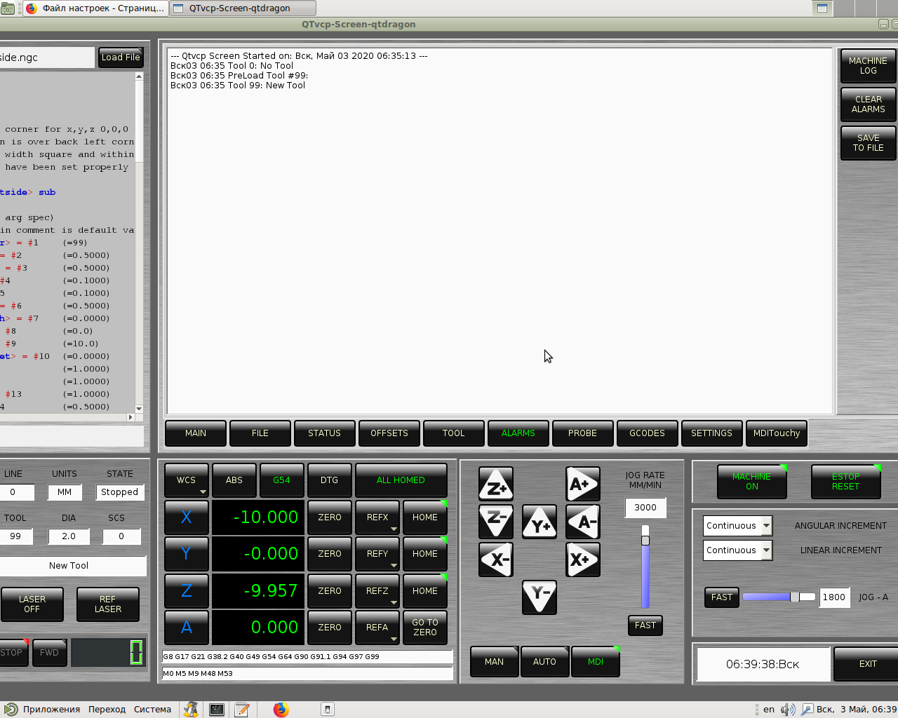

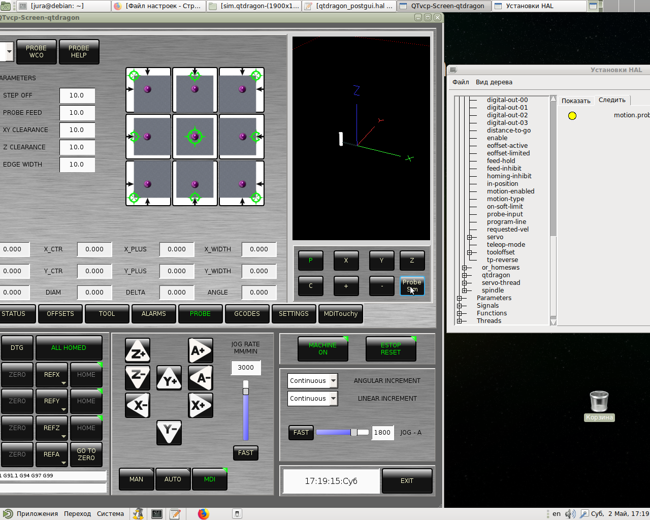

I created a probe sim button in the interface, run the probe_screen tool
moves a little to the side and goes down to the probe-in signal does not respond. Motion probe-in in hal_show activen. You can add qtdragon.probesim_button to qtdragon_posthui.hal net btn_probesim motion.probe-input and check.
Yes, and push_button named probe sim. Thank you for the attention.

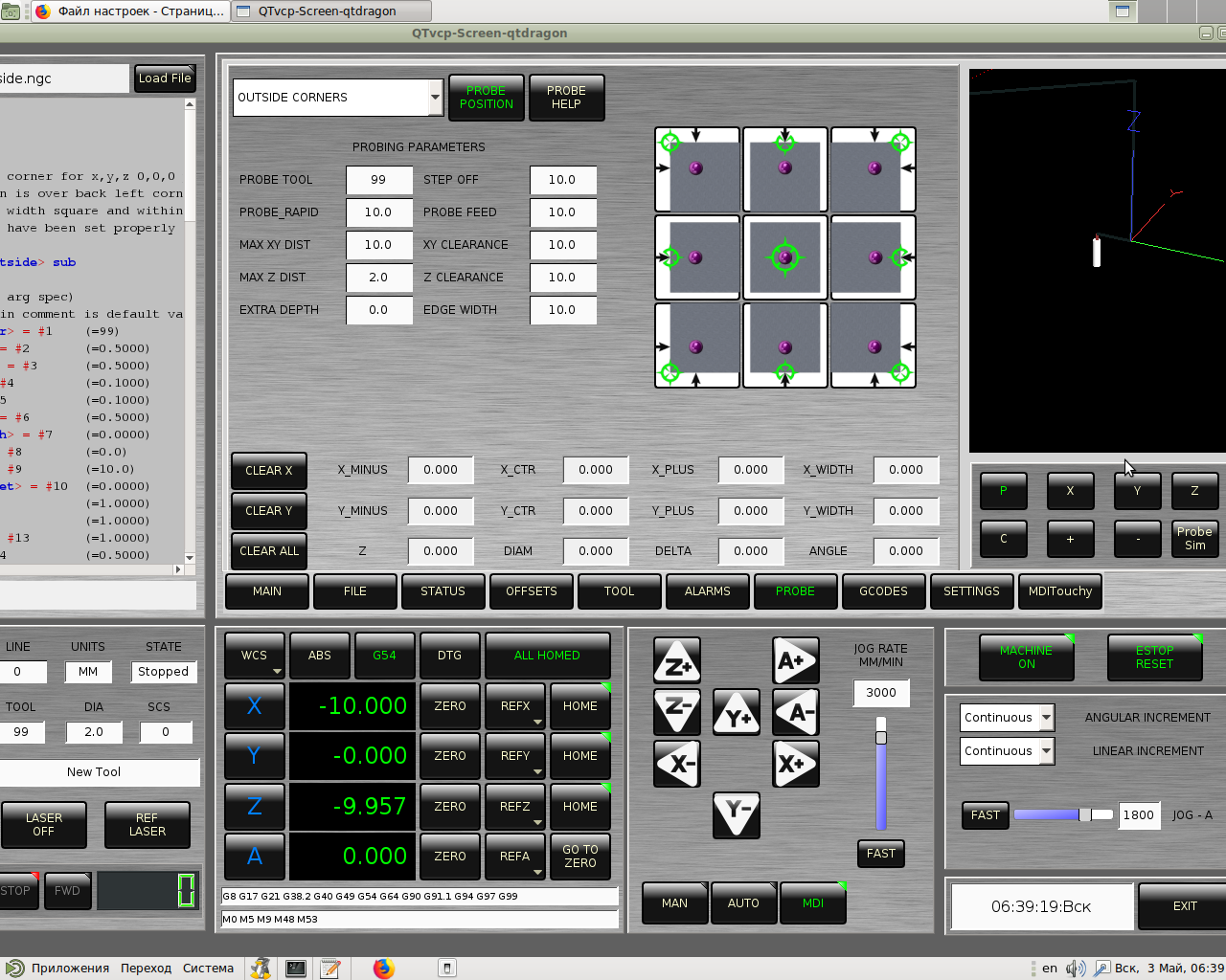

When you click a probing action button, does it return right away with :
[QtDesigner.QTVCP.QT_ACTION][ERROR] Oword RCS Error = # 1 (qt_action.py:182)
[ERROR] Probe routine returned with error
If so, make sure the tool in spindle is the same as specified in Probe Tool in the probing widget. I have to work on making this error more meaningful.
If the right tool is loaded, try setting the Step Off and Edge Widths to a large number (or probing velocities to a small number) so you have time to see the DRO move. This gives you time to click the probe sim button before it errors out.
If you're not seeing these errors, you will need to elaborate more on exactly what it is doing.

There is no mistake. It just does not respond to motion probe-in. Tool is coming
You can press the button very slowly dozens of times. Everything stops at
Z value = -9.957.
Z value = -9.957.

The only clue I see is QtDesigner.QTVCP.QT_ACTION - ERROR - Oword timeout oast () Error = # 60 which means that the OWORD call timed out before completing. The OWORD call allows 60 seconds before timing out so so you have to set the probe velocities high enough to allow it to travel the required distances within 60 seconds. For safety, the move along Z occurs at probe speed rather than rapid speed. While it is travelling down to probe depth, the probe-input will have no effect. Try increasing probe rapid velocity to 200 and probe feed to 50.
