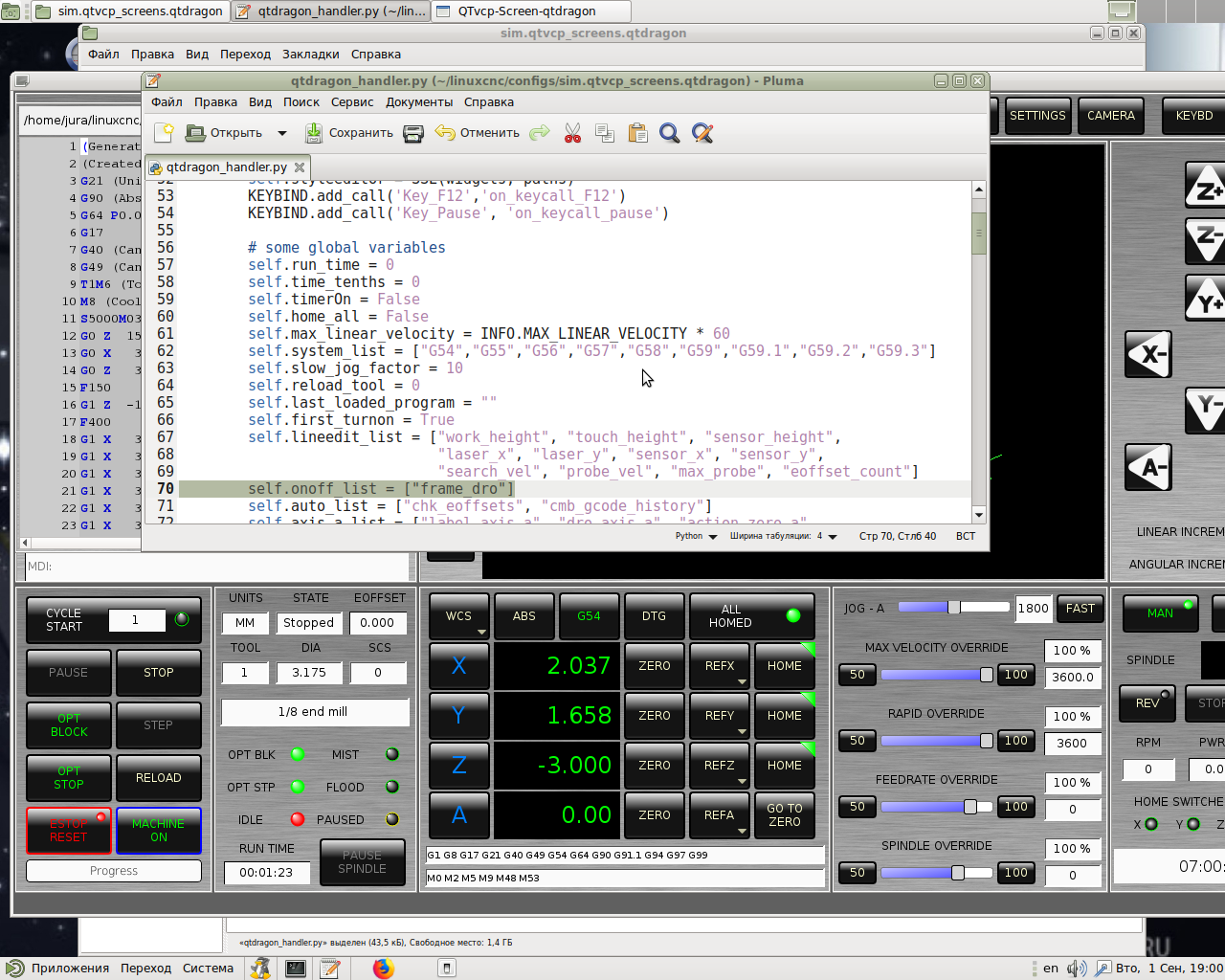

remove Program Frame then it works. I study a little. Thanks you.
Replied by hottabich on topic Preference File
Sorry to blame. The question was solved as follows. If in the handler in the lineWithout more information - I could only speculate the answer.
self.onoff_list = ["frame_dro"]Please Log in or Create an account to join the conversation.

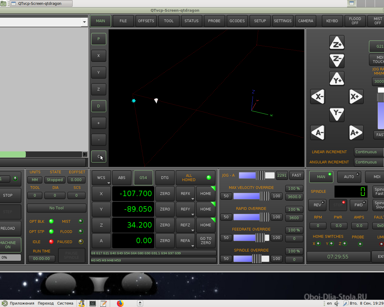

Hello! If you click on the buttons several times Clear or Dimensions, then the tool is displaced in the visualization window. How to fix it?
- Posts: 7368
- Thank you received: 2181
08 Sep 2020 17:59 #181308
Replied by cmorley on topic Preference File
I don't know.
It seems to be specific to qtdragon.
Clearing the logger sometimes moves the origin in the view.
Though I see as soon as you cause an update, it pops back to where it belongs.

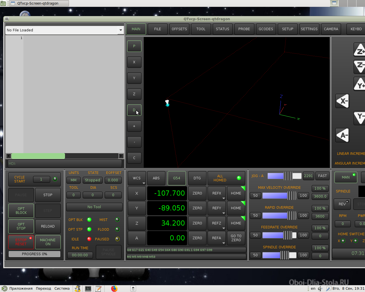

- hottabich
- Posts: 574
- Thank you received: 96
08 Sep 2020 19:45 - 08 Sep 2020 20:51 #181312
by hottabich
If you do not click many times, then everything is fine. This is a feature Gcode graphics. In Gremlin_view. ui there is suchThanks for your attention.

09 Sep 2020 00:09 #181344
it calls the same function.
In qtvcp we explicitly call update() but I don't know what the problem is from.
As I mentioned I can't get it to happen on any other qtvcp screen.

09 Sep 2020 05:05 - 09 Sep 2020 05:28 #181365
by hottabich
In Qtaxis the same error. It does not happen where Gremlin. In widget gcode_graphics. py prescribeno mistake. Changes took from gremlin. Please change the widget to nested.In the handler btn_dimensions_clicked prescribe
if v == 'clear self.logger.clear()self.w.gcodegraphics.logger.clear()

09 Sep 2020 06:13 #181367
It's very odd problem. your change is the same as the original:
The is the function called originally:
The only real difference is timing?
Right clicking in the graphics clears the screen too and showed the problem.
I change it's code to what you described and it gets much better, but can still move from time to time.
def clear_live_plotter(self):
self.logger.clear()
self.update()The only real difference is timing?

09 Sep 2020 06:15 #181369
Dimension problem:
in the handler file you may find:
change to:
def btn_dimensions_clicked(self, state):
self.w.gcodegraphics.show_extents_option = state
self.w.gcodegraphics.clear_live_plotter()change to:
self.w.gcodegraphics.updateGL()Please Log in or Create an account to join the conversation.

09 Sep 2020 07:15 - 09 Sep 2020 07:40 #181383
by hottabich
Thank! The dimensions button works great with your code. Right clicking in the graphics is unnecessary. With the gremlin code, if you move the Y axis, or X, it clears it only after the update (spin the Misha wheel). If displacement along two axes or more is not a problem.
