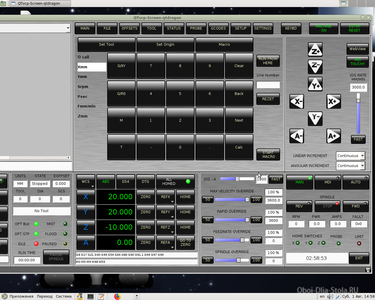

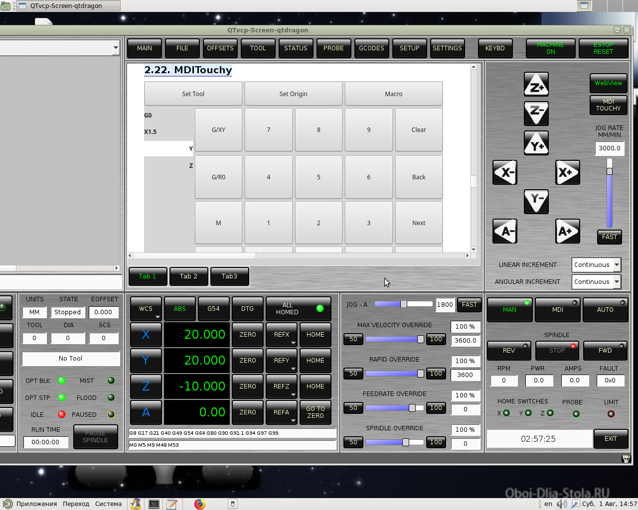

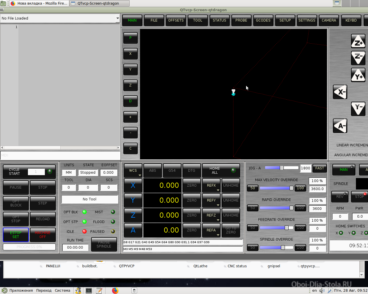

01 Aug 2020 07:47 #176776
by hottabich
Replied by hottabich on topic Preference File
Hello Jim !!! I suggest adding to your beautiful QtDragon interface. If there is a desire. Thank!

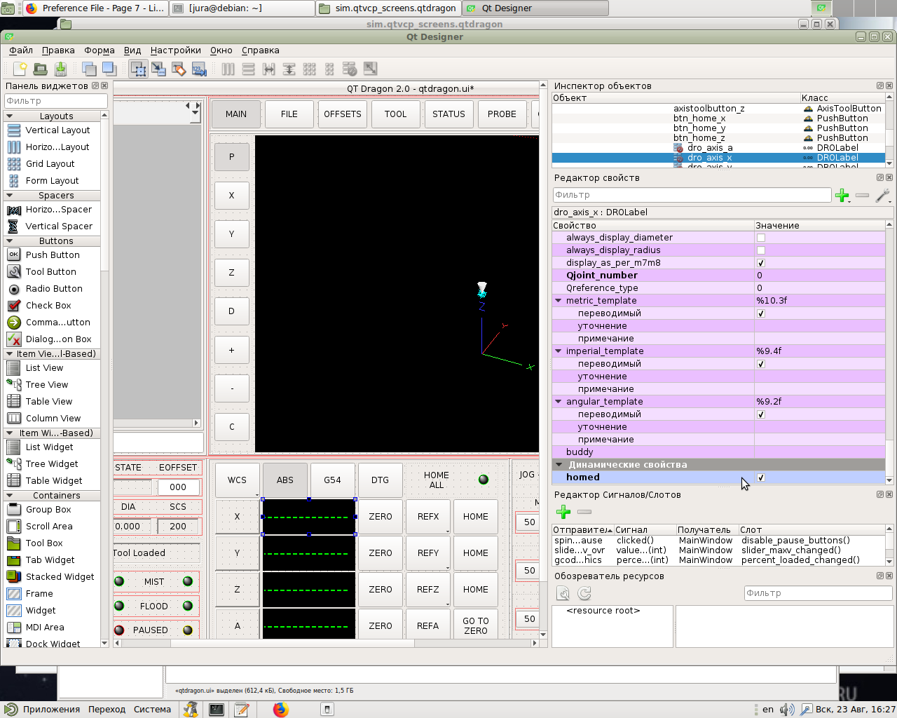

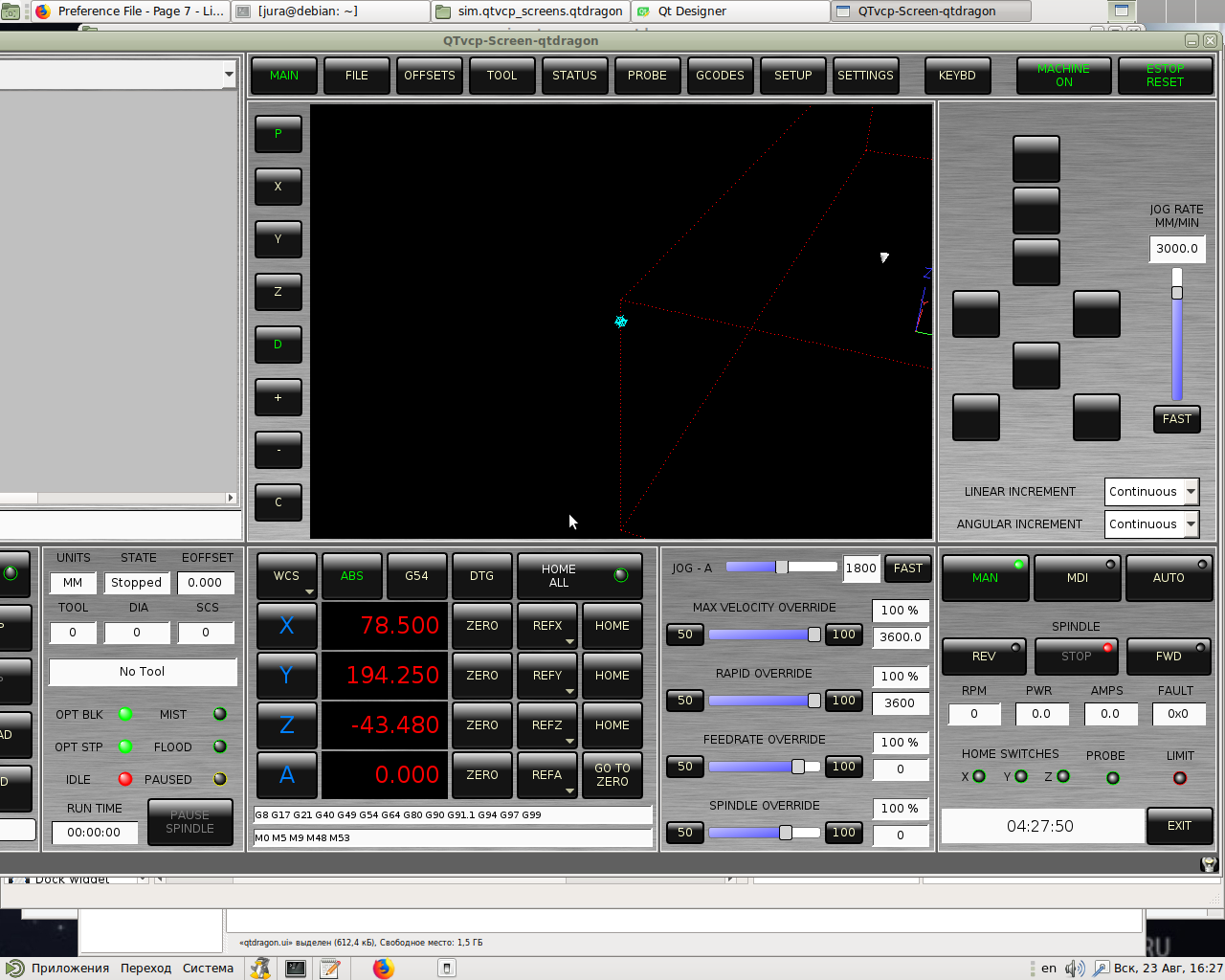

23 Aug 2020 08:34 #179098
by hottabich
Hello! In the designer, I select the dro-homed green indicator when starting qtdragon red. Prompt please why so.
- persei8
- Posts: 399
- Thank you received: 133
23 Aug 2020 09:35 #179103
by persei8
Replied by persei8 on topic Preference File
The DRO labels have a dynamic property called 'homed'. The handler file sets it True or False according to whether or not the machine is homed. The colors are determined by the qss file which specifies a normal color and an unhomed color. To change the homed and unhomed colors, modify the qss file. I made the unhomed color red so it would be obvious that the machine needs homing.

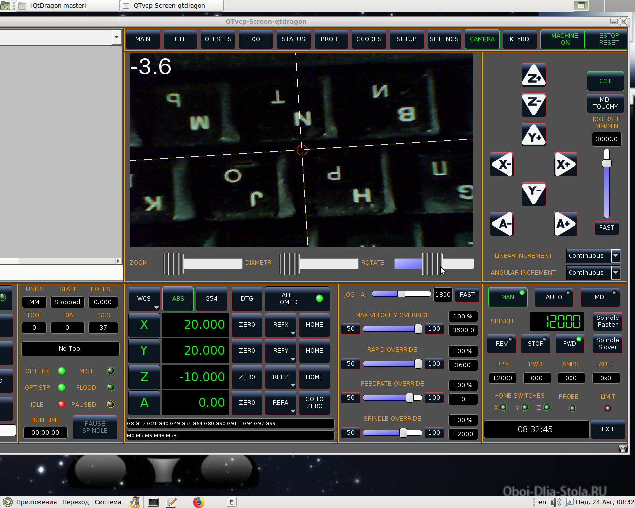

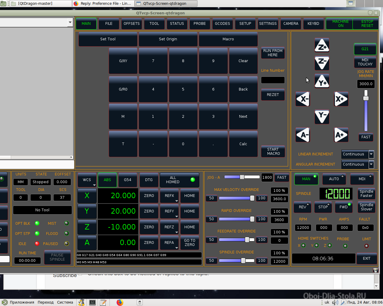

24 Aug 2020 00:08 - 24 Aug 2020 00:36 #179189
by hottabich
Many thanks! You used the machine without homing? If yes, please tell me how assign INI correctly. Changed the interface a little, if you're interested, I'll post the files. Thanks for your attention.

28 Aug 2020 02:04 #179789
by hottabich
Hello! For me, the E-Stop, Power button in the lower left corner is pretty cool. They are not active after migration.
Please tell me what I'm doing wrong.

29 Aug 2020 13:27 - 29 Aug 2020 13:27 #179954
Replied by cmorley on topic Preference File
Without more information - I could only speculate the answer.
